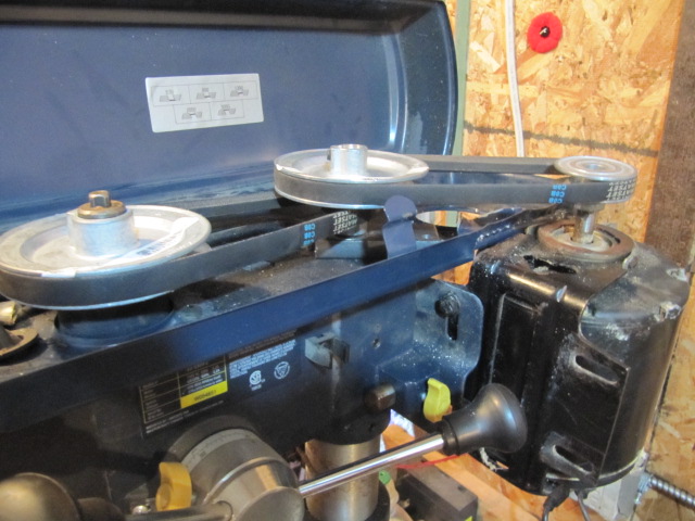

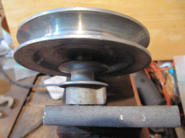

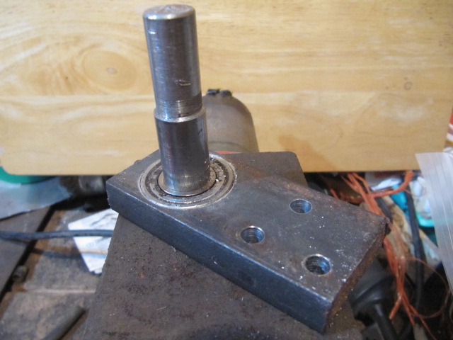

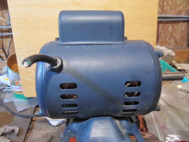

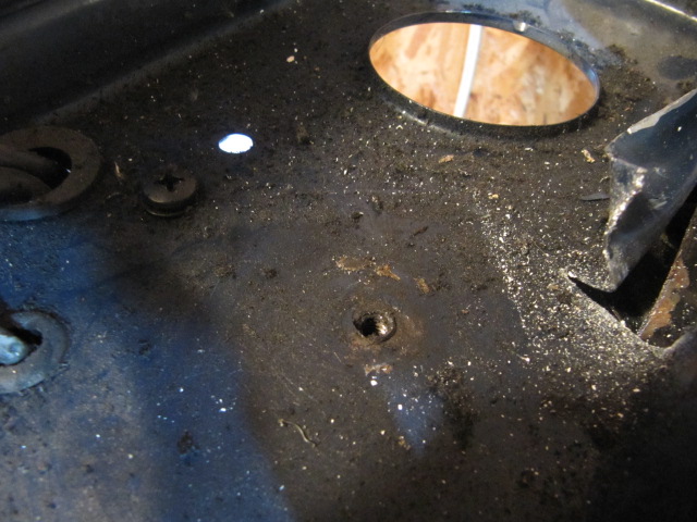

I'm gearing up to get moving again on this project. One of the issues I've had is the chuck-speed of my drill press. It has been just too fast for the hole cutting saws and a related issue has been that the motor it came with is simply "puny"!:grumpy: Sooo... as I threatened to do quite some time ago on another thread - rawinok2's mini dozer build -, I have made some modifications;). I considered posting this on his thread but decided against it in case that attracted unwelcome attention to what he has going on right now.
I have two drill presses like this so there is no need to retain the variable chuck speed capabilities on this one. First photo shows the step-down thing-a-mabob. Second photo you see the hidden components. Both the bearing and the short shaft are press-fit. Third one shows a conveniently positioned threaded hole where I'll bolt the thing-a-mabob into place. Fourth - the puny motor I swapped out for a 1/4 hp. That motor does not have a plate to identify brand nor power/rpm info. Hmm...:muttering: The last one shows the way it looks now with the changes and ready to drill. I've done a test hole with the 1.5" hole saw and although I can still stall it, I can easily control that. The chuck speed has dropped from 570 rpm - no load, to 320 rpm - no load. Load speed will be quite a bit less, of coarse, and that is just fine by me. I hope to put in some shop-time soon and get this machine a-diggin'!:thumbsup:

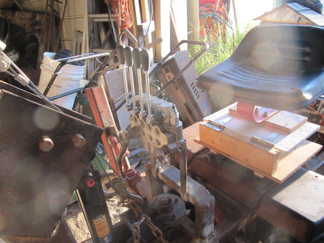

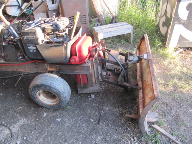

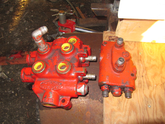

I think I am ready to restart or resume this thread - it has been rather a long time since I did any work on this machine.:ashamed: Like someone in another post once wrote "Life got in the way!" I have been putting in an hour or three here and there for the past month or so and I am moving on to the hydraulics issues. I am far from expert where hydraulic systems are concerned so I will lean heavily on any advice I can get from you good folks on this forum.:)
I have a pump salvaged from a bale-loader and am trying to use as much of the hard line from it as is IMG_1921.JPGpractical. Where flexing is going on, I will switch to hoses. Because of budget constraints, I am scrounging wherever possible which brings me to the advice I need. For the boom, dipper, bucket and swing functions, I have purchased a 4 spool set of controls. That leaves me to somehow add controls for the outrigger legs and the dozer. One of my coffee-shop buddies had a two valve spool lying around for years that he let me have. For the dozer blade lift I have one of the valves from the bale-loader. The 4 spool and the 2 spool are both plumbed for 1/2" while the single spool is plumbed for3/8". Is it possible to connect them all in series? This is all open-center stuff.
Sorry the pics are scattered around on the page. I mostly don't know what I'm doing with this computer.:confused3: The first one is of the 4-spool control and my messy:eek: shop. the other two are of the rest of the valves and the dozer setup. It came off another garden tractor I have.
