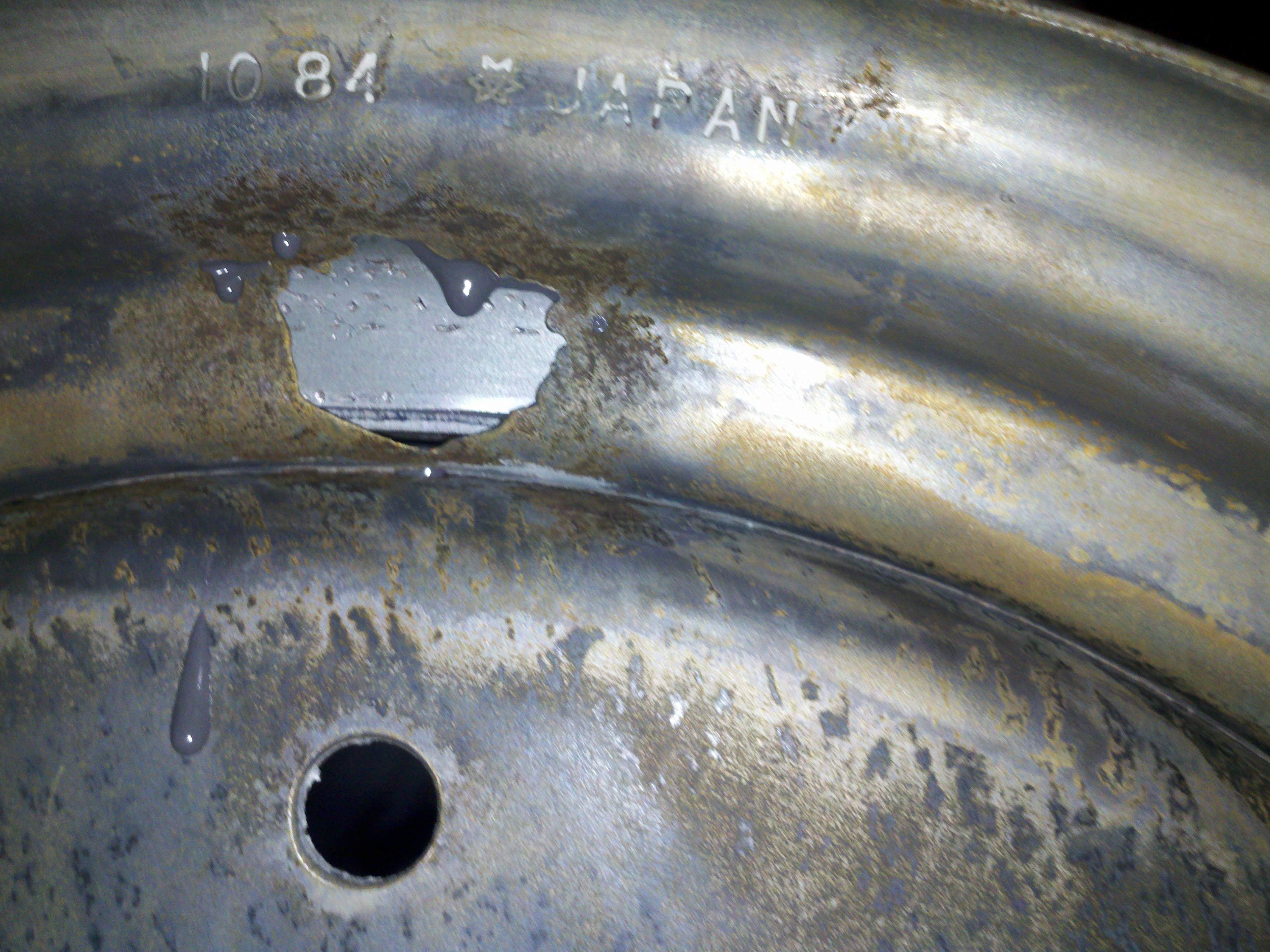

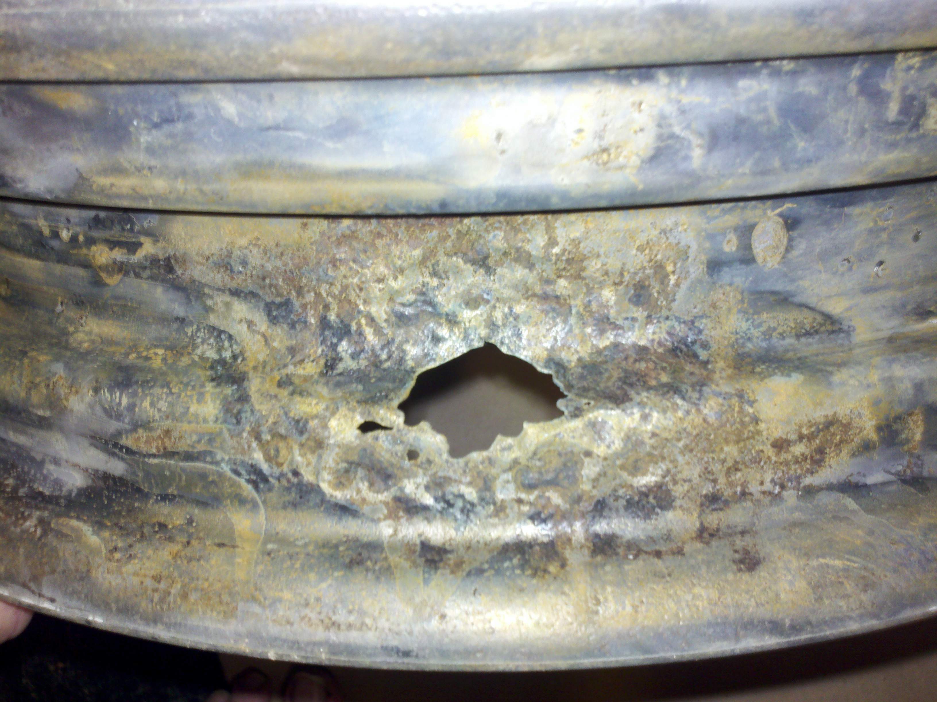

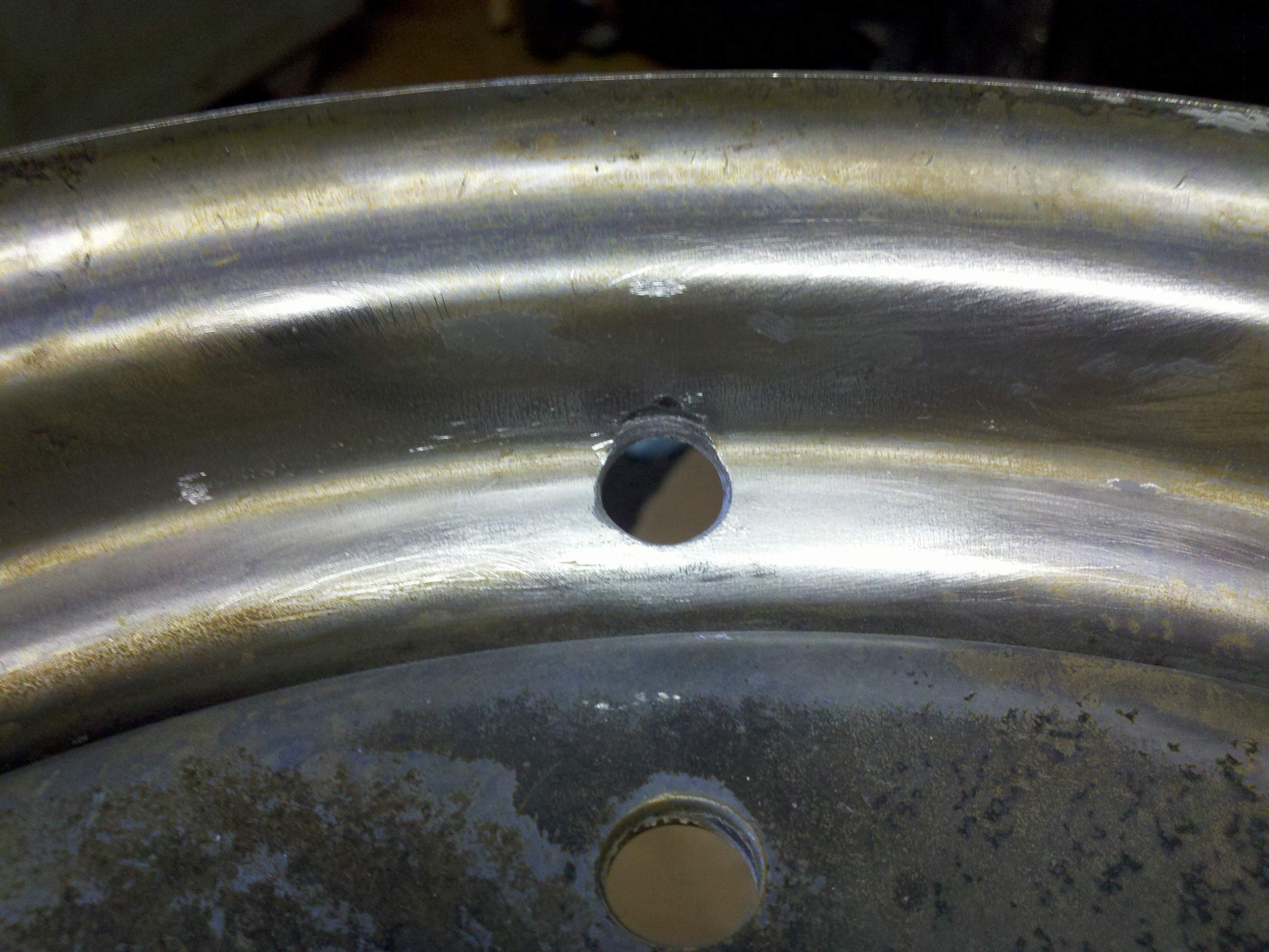

Here is my situation and what I decided to do to fix it.

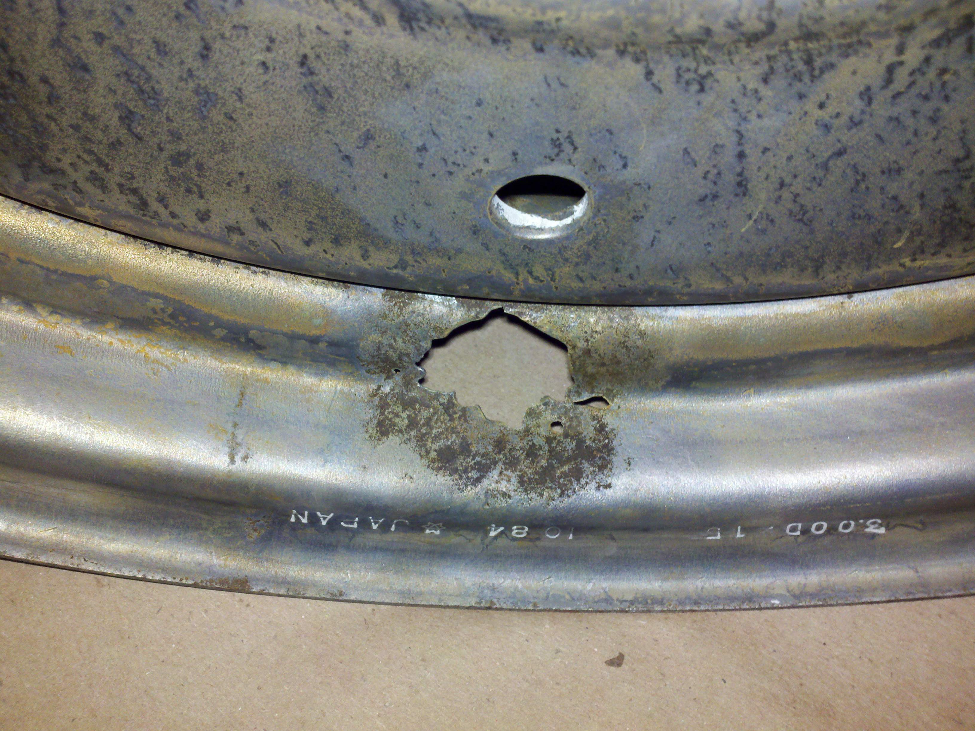

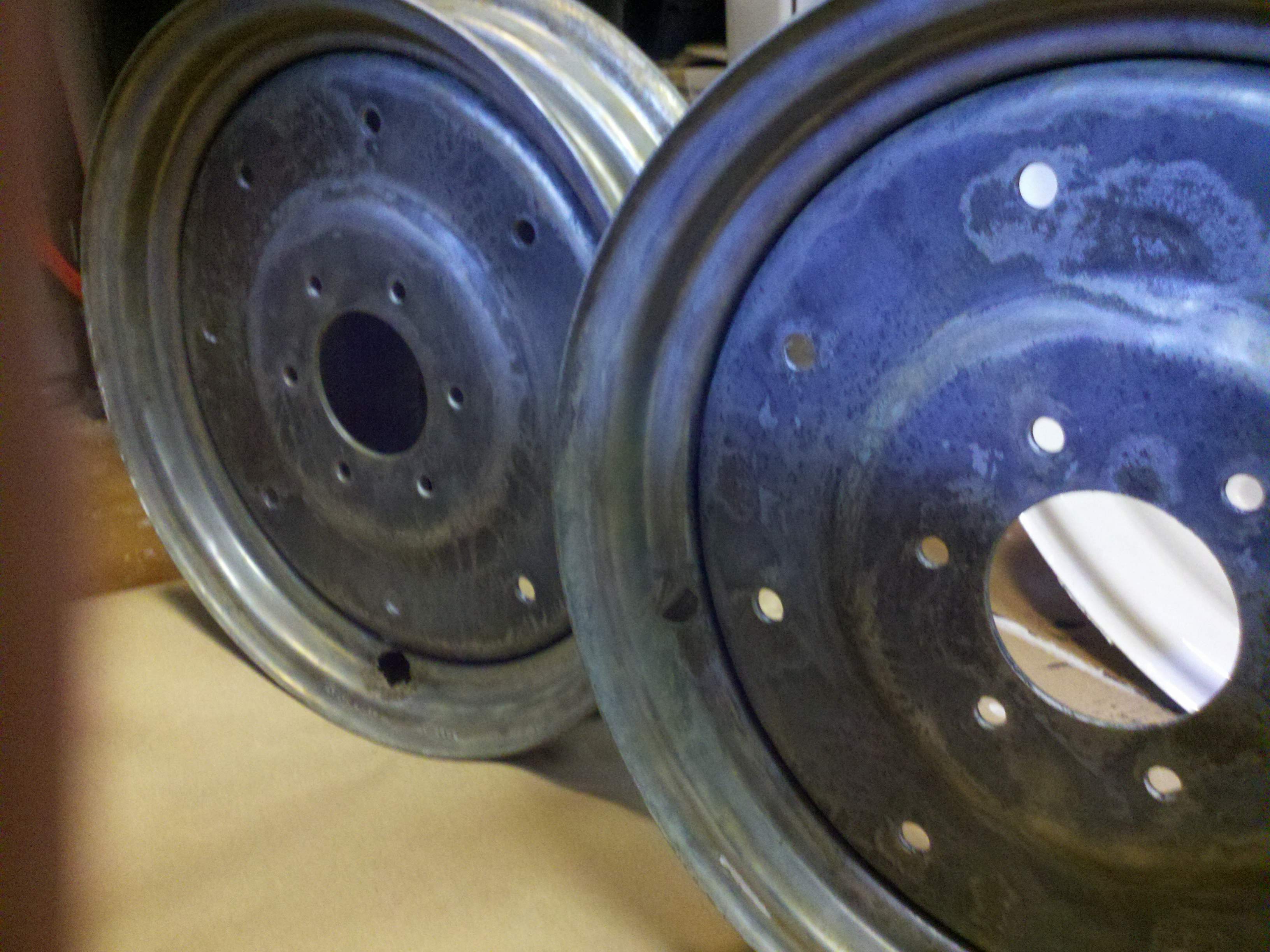

I recently purchased a 1984 Ford 1710 2wd tractor. It was is good running order relatively speaking.
The wheels were rusted as you will be able to see from the pictures. Even though the tires were holding air they were (looked to be) the originals. Dry rotted and cracking badly.
I had the tires dismounted and noticed that the front rims had rusted out around the valve holes. I hunted far and wide for new replacements but it seemed that the closest match was not exactly perfect. The center hole in my rims are only 3 inches. Most of the ones I saw for sale were 6 inch center hole.
After reading a thread on TBN I discovered an excellent idea. Just drill a new hole on the other side of the rim where it was not rusted and patch the old hole.
That is what I decided to do. I was going to weld the mending plates on with my cheap'o' mig welder but with my poor welding skill I would end up with splatter and slag that would require grinding and sanding afterward.

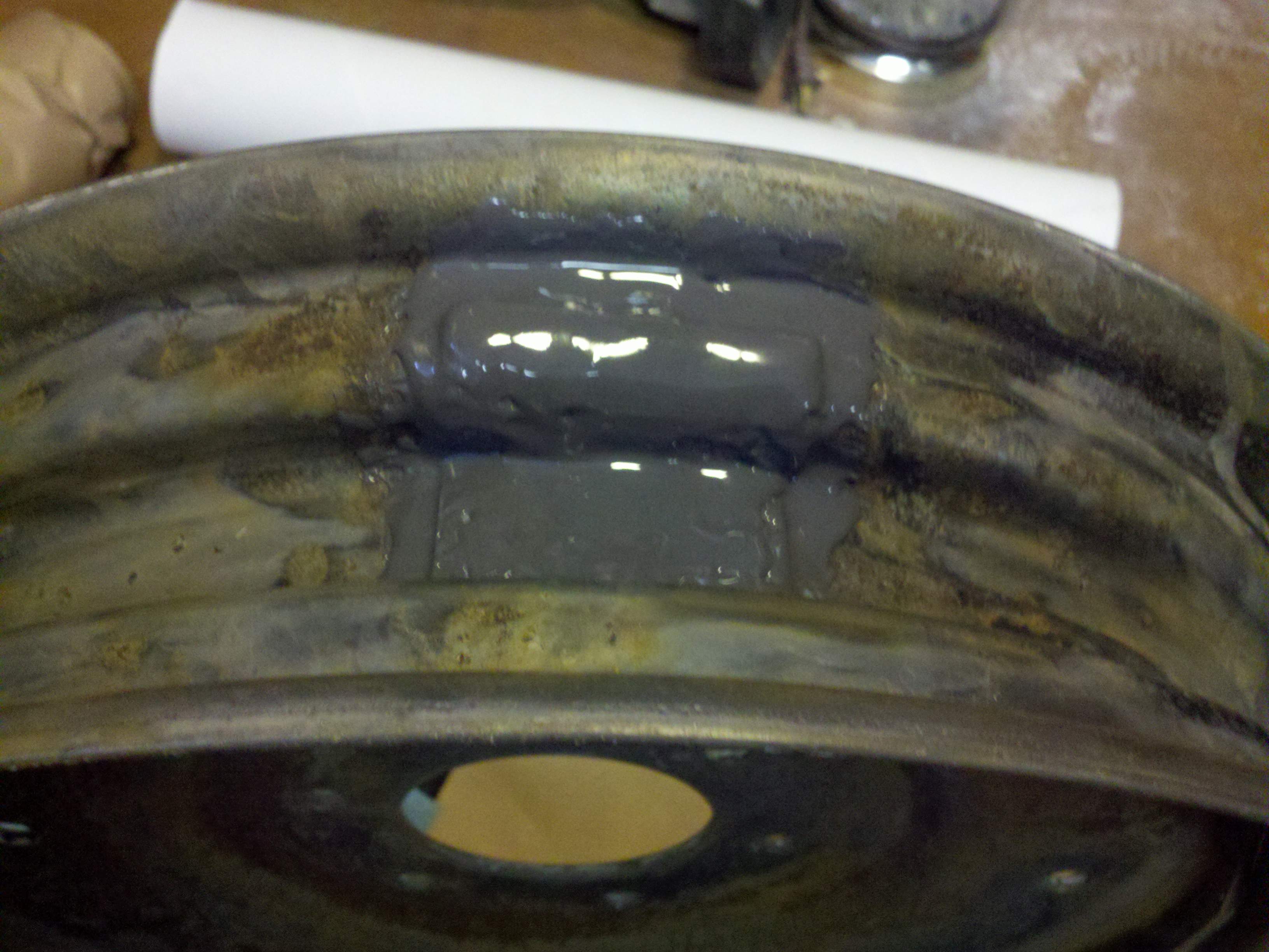

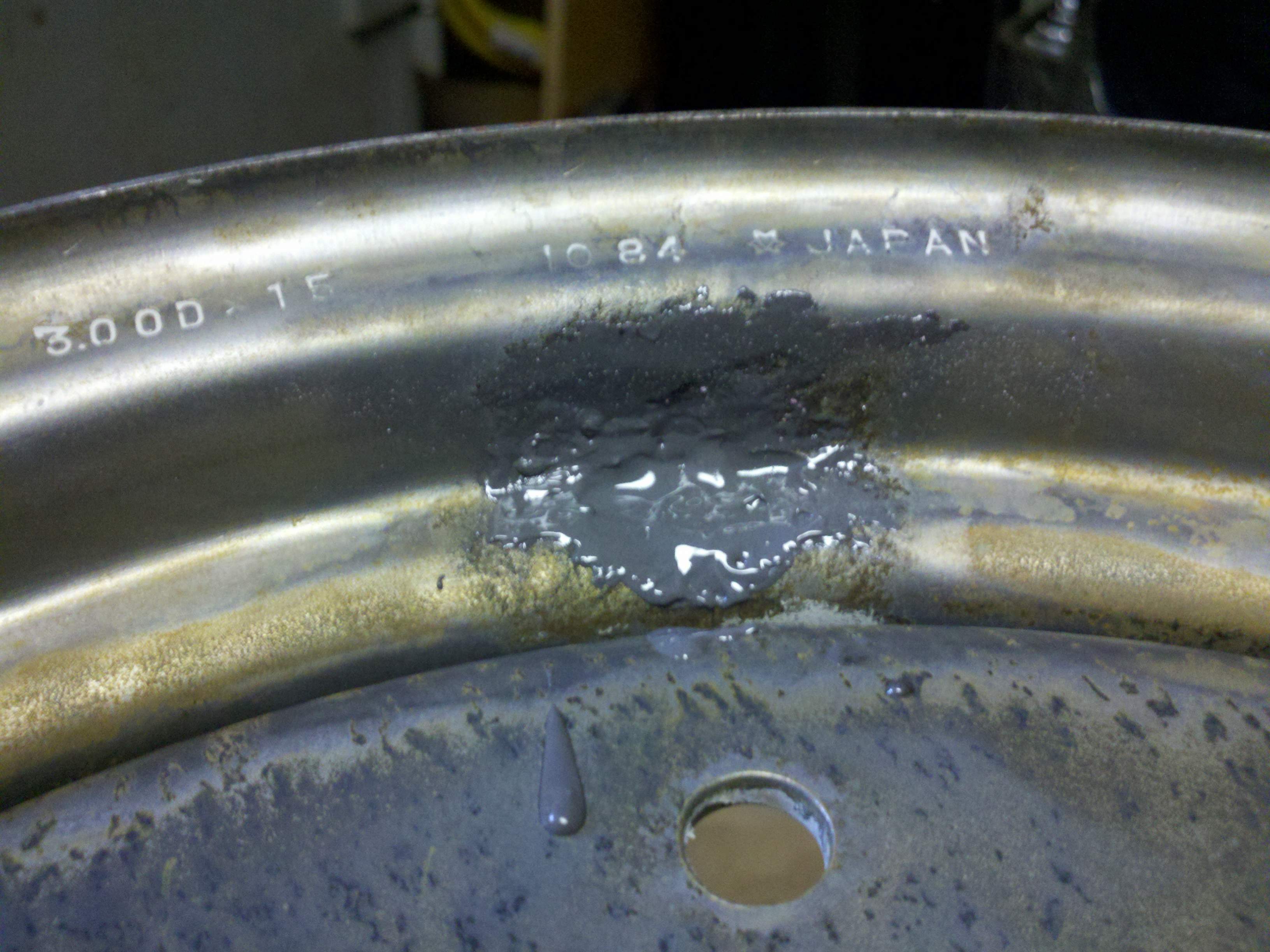

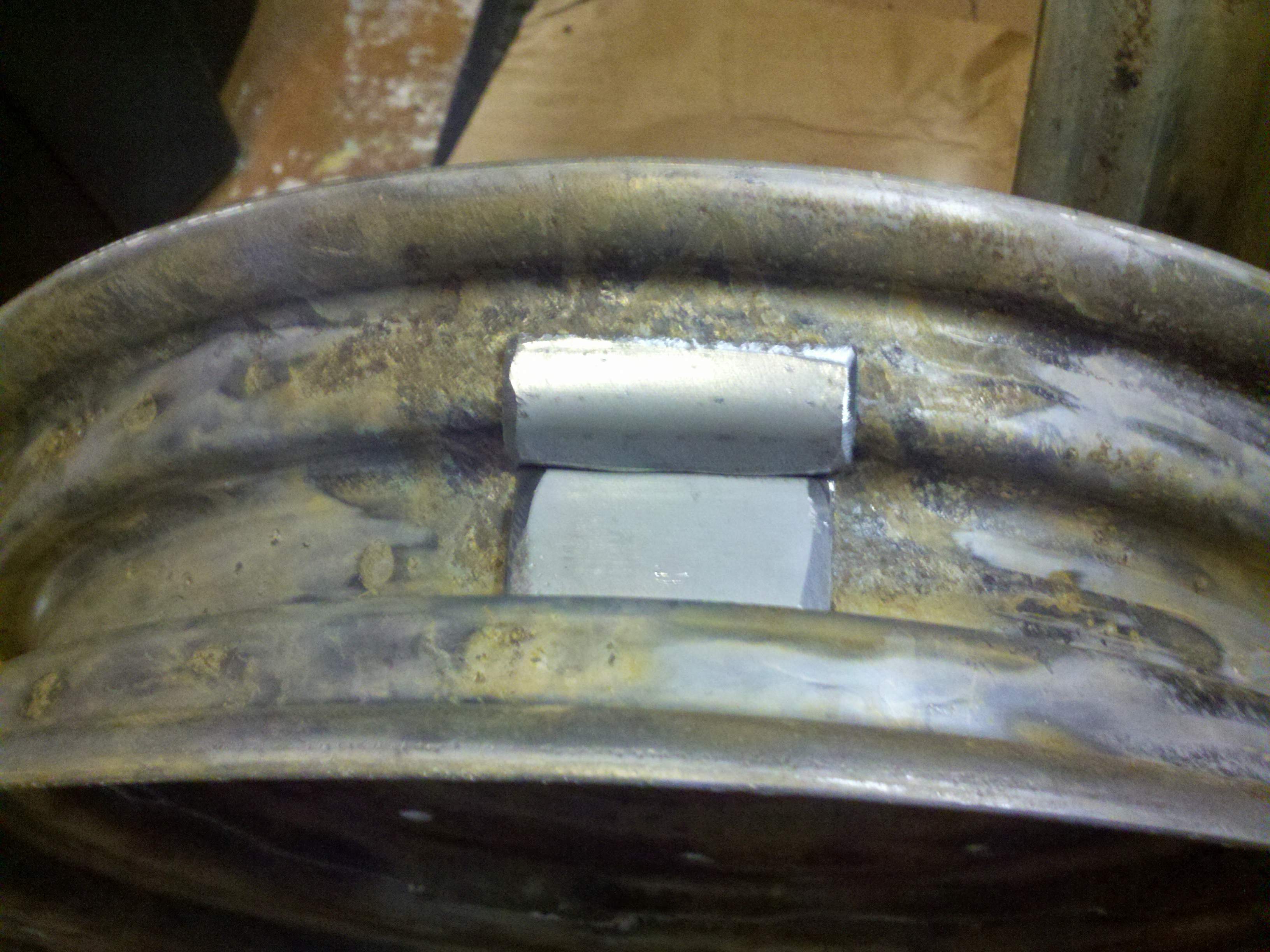

I decided to use J B Weld instead. I have used it before on lots of small jobs and it worked very well.
I picked up a small section of steel flat bar from ACE hardware and cut off some mending plates. I cut two pieces for each rim. I hammered and bent them to match the contour of the rims.
I mixed the JB weld and coated the area on the rims and the entire surface of the mending plates.
Since I planned to put tubes back in the tires I wanted to make sure that there were no sharp corners exposed. The corners of the plates got smoothed out with the grinder before mounting.
Once the J B Weld started to harden up slightly I pushed the excess back up around the edges of the mending plates to help keep a smooth edge.
I don't know if anybody else had tried this so I thought I would share my experience. The test will come after I get the new tires and tubes mounted. That will be later on.
So right now I will show you what it looks like before during and after. More pictures for after will come later.

   / J B Weld wheel repair #2
Best of luck with it. In my book, good enough, is good enough.
   / J B Weld wheel repair #3
i think i'd have cut the centers out and welde dthem into some new rims before i jb welded patches in.
   / J B Weld wheel repair #4
If it works and no leaks that's great. Last week I JB Welded a part of a head on a 23 hp Kaw engine. It has made it for 10 hours of mowing. Ordered a new head but if this works the new head may sit on the shelf till winter when I have time to change it.
   / J B Weld wheel repair #5
I ran over a screwdriver that damage an Aluminum rim by dimpling it, creating a small hole (almost went through the rim) . New rim was $500 from the dealer and could not find a used one. Took a hammer and pounded down the dimple a bit, JB weld on inside and out. Rim still holds air 3 years later and checked it out at the last tire change on the inside and it still looks good. Worse case you are are out like $15 for the JB and the stock. Best case it holds
   / J B Weld wheel repair #6
got any zinc alloy solder? could make it a permanent repair.. :)
   / J B Weld wheel repair #7
Since the tire pressure will be holding the patch in, the JB will not have to do much. My only concern would be flexing of the rim. Still I think this is more than worth a try. You did a nice job too. Keep us updated with your results.
   / J B Weld wheel repair #8
SG I don't, but if it starts to leak I would look into it.
   / J B Weld wheel repair #9
i've had good luck repairing thin aluminum with that type of alloy solder. the biggest problem i've found 'gluing' things to aluminum is oxidation lifting. depending on the intended lifespan of that rim / repair, flxing,a nd how good of a seal, and the makeup of the epoxy.. it may or may not be an issue.
I'm keeping that option open just in case. If the JB doesn't hold then all I've lost is a tube and wasted time. Since my welding skills are not up to the task I would have to pay someone else on top of the price for new wheels. It is still not out of the question.
Thanks for the tip.
Kent
