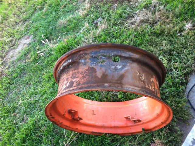

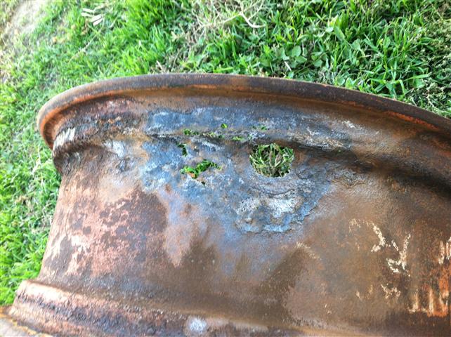

Since the tire pressure will be holding the patch in, the JB will not have to do much. My only concern would be flexing of the rim. Still I think this is more than worth a try. You did a nice job too. Keep us updated with your results.

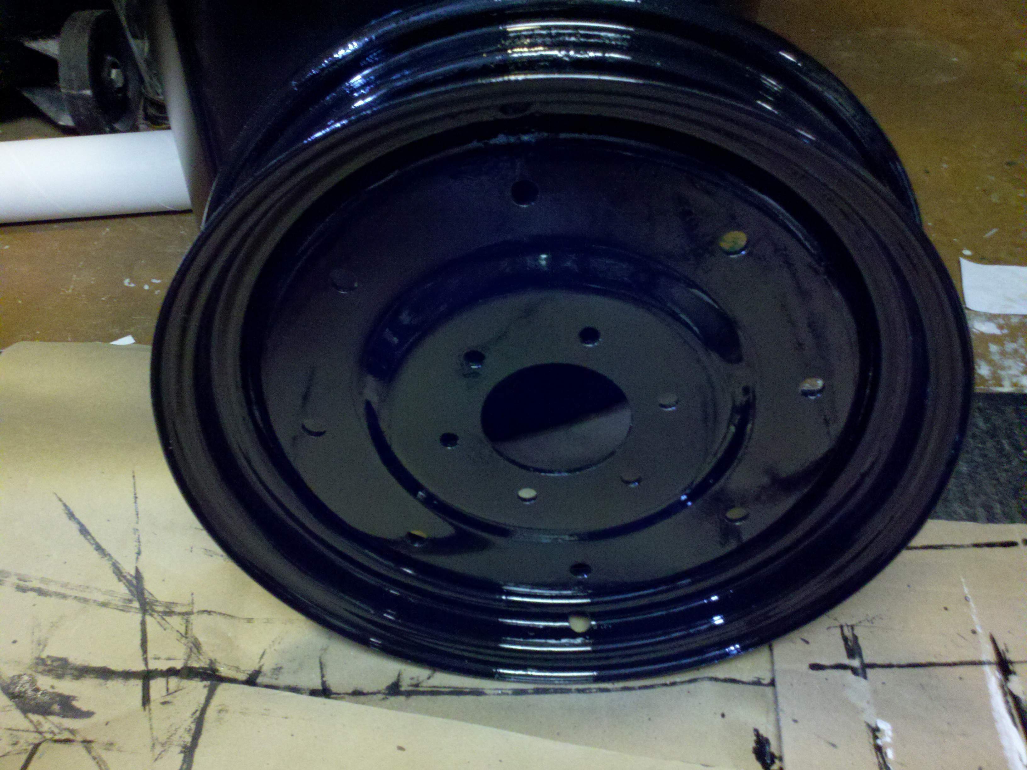

That is my thinking also. I'll scuff the JB a little before I put two coats (all over) of POR15 on them tomorrow. After that gets tacky they will get Rustoleum paint. They will be shining like a new dime.

Interesting patch job.
I assume you are running tubes in the tires. So, it doesn't really have to be airtight, it just has to hold the tube in place, not fall apart, and not damage the tube. I still might have brazed it all in place, but the JB might hold.

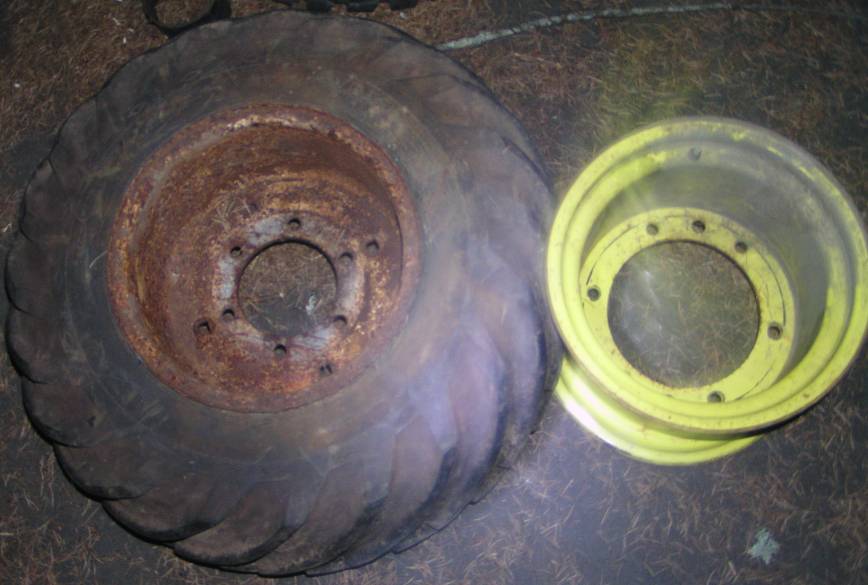

What I've decided to do on my Toro (not completed yet).
One of the rears was rusted out, and the other was in pretty bad shape.
I needed a pair of wide 12" wheels.
I found a set of Yellow 12" rims (I'll have to repaint to a more pleasing color) with a very large bolt circle.
I'll cut an adapter plate out of 1/2" plate steel (which will also give me some wheel weight, as well as improving the offset, I think). Anyway, my plan is to make rim bolt pattern adapters to match what I need. The Toro bolts should fit just inside of hub circle on the yellow rim. I guess many rims are designed to sit on a hub for additional stability, although I suppose I could carefully machine the adapter to fit against the rim for stability, perhaps in conjnction with

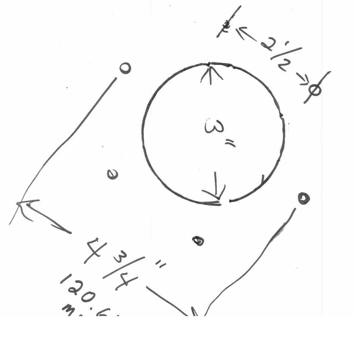

I even made a template for measuring potential matches.
I also found a cross reference chart that says that some Dodge Dakota rims could be a possible match.

Here they are. One shot of the rims with POR15 and then with a coat of Rustoleum.
