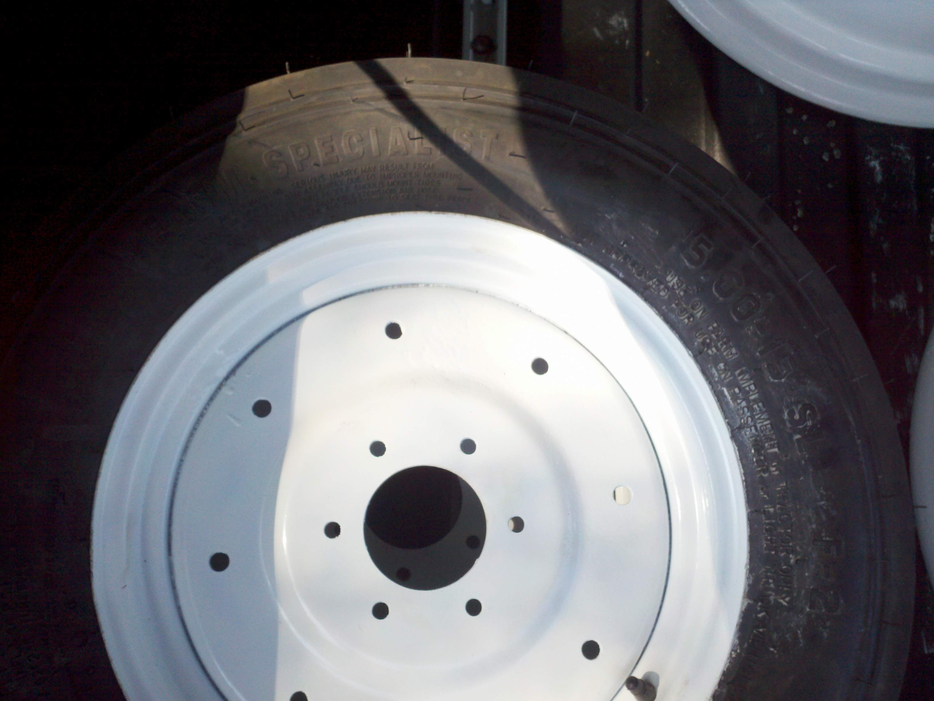

There they are!!

The good news is that the front tires are installed and they look pretty good. JB weld patches are holding for now.

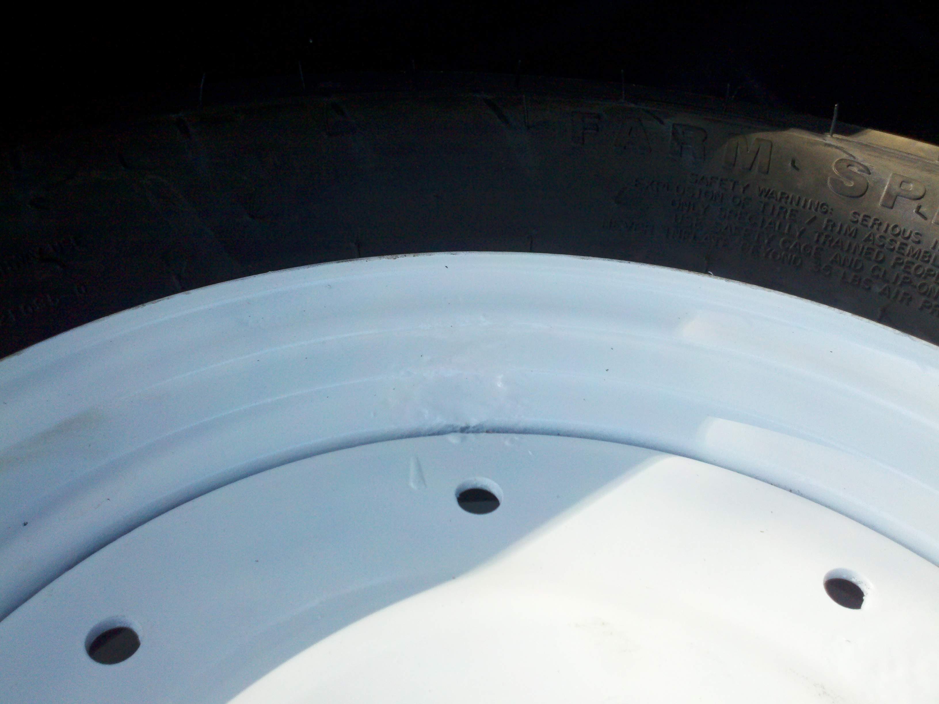

My JB Weld is holding strong. I only patched the front wheels though. My rear wheels were still solid.
I recommend taking your time to make sure that all the edges are smoothed down before applying the JB Weld. Since that stuff takes hours to cure it continues to settle / flatten out before it dries.
I made my patches from angle iron. After cutting to the right size I clamped them in the vise to hammer in some curve so they would fit better in the wheel. I also used the bench grinder to help smooth out the edges before installing.
I never even think about it now. After painting the wheels I never notice the patch unless I look for it. They haven't lost any air since the fix. I did have new tubes and tires put on so it should keep on keepin' on.

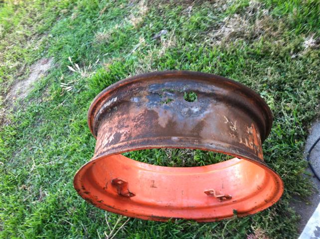

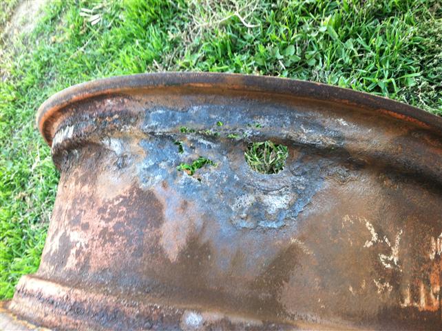

Here is picture of my rims after attacking it with a wire wheel. May try the grinding wheel to get it down to the bare metal before applying the JB Weld and patch to the hole spots. Then get as much of the rust off the rest of the rim. Then a coat of Rustoleum Reformer, then a coat rustoleum paint.
The tubes were filled with calcium chloride that leaked, and was probably eating at the rim for quite some time. It was a real pain getting the tire off.

If you are going to the trouble to fix it with a patch and paint, I would get the entire rim abrasive blasted and ready to paint. The blasting will also give the JBWeld something to hold on to. I would get my plate patch ready by heating and beating to shape, then get it blasted, put on the JBWeld and when hardened, apply the primer to prevent rust bloom. KentB did a fine job on his rim. Your hold is much bigger but a piece of 10 gauge plate might work fine and should give you plenty of strength.
