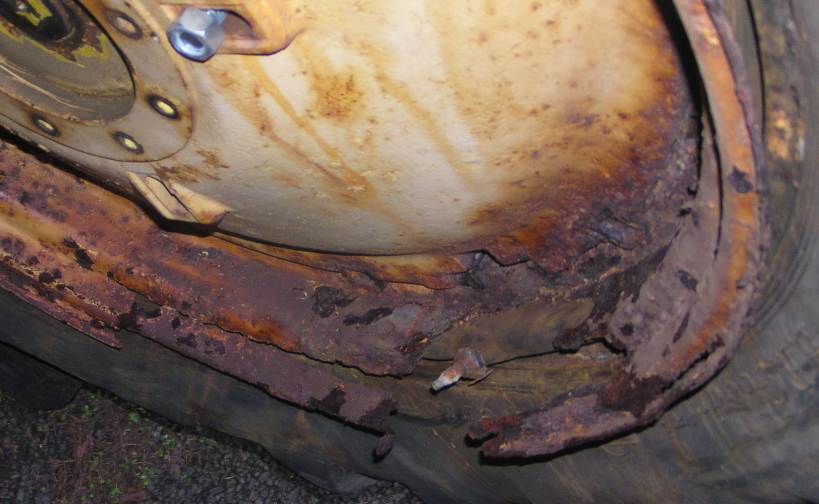

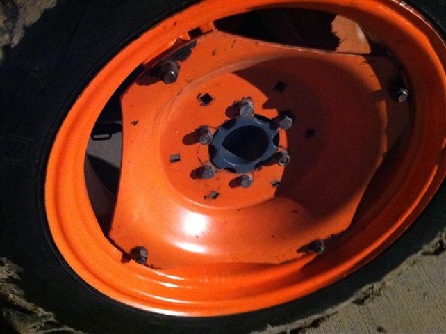

Wow. There is a lot of daylight showing through that rim. That is a good bit more of a problem than what I had to deal with on my wheels.
I'm not saying it can't be done but that looks serious. Keep your options open and maybe shop for another rim.
I am still keeping my eyes peeled for spares even though mine are holding their own.

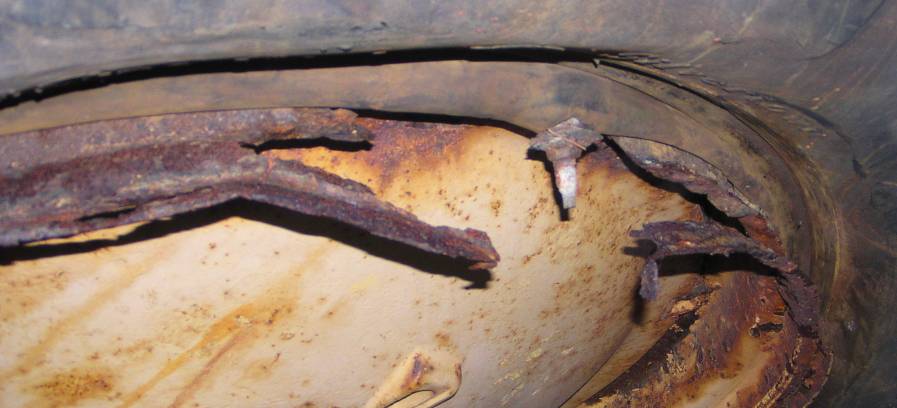

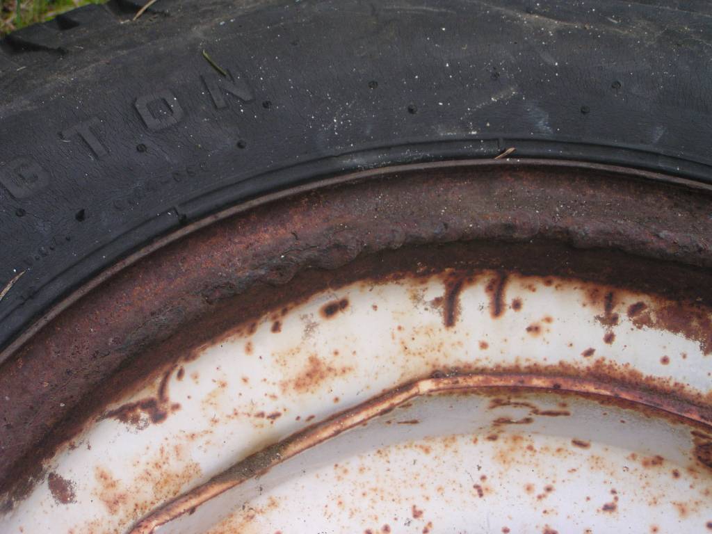

Here are some photos from my baler.
You can see an old weld that held.
But, the rim itself didn't take the stress of a fully inflated tire (the person I bought it from had overinflated the tire a bit). This rim will end up as scrap rather than attempting a second repair (I wasn't happy blowing a tire on the freeway).
Anyway, just keep in mind the risk of the lateral force on your wheel. The piece of angle iron or bent steel should take some lateral force, but you probably won't be wrapping your patch all the way up and around to the side of the bead where all the lateral force will be.

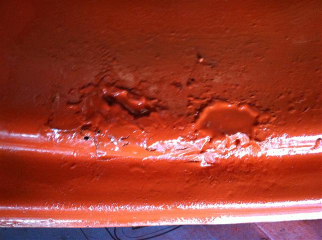

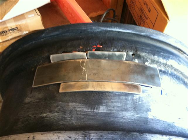

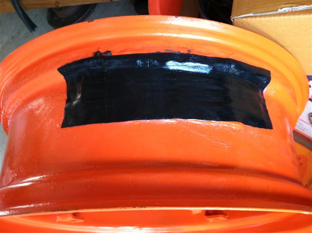

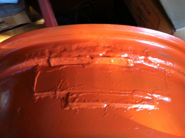

Thought I would post my handy work.
For the rust on the inside, I used a coat of Rust reformer that comes in a bottle that you brush on. Turned the rust to black.
Cut a few pieces of steel. Used JB weld to weld them on. Then added two coats of paint. Tried to silicon a piece of rubber inner tube from an old bicycle tube to be sure no rough edges would puncture the new inner tube. The silicon did not glue rubber to steel very well, but just needed it to hold until I got the inner tube in, and filled with air to hold it in place. Did a few loads of dirt with the loader, and so far so good.
   / J B Weld wheel repair #46
Just saw this again, and thought I would update after 6 years. Repair still seems to be fine. Though I don't use my tractor much, maybe a few times a year when I have to move dirt, and lift and move something really heavy.
