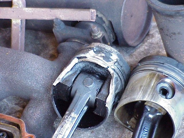

Pulling and testing the spray pattern is the best suggestion so far. I think in this case there is something in the fuel system still causing this. However you are getting some fuel as indicated by the white smoke (which is actually injector atomized diesel). I normally say stay totally away from ether but in this case I would see if it will run on ether. Just a shot or 2 to get it going then a couple more if it starts to see if you can get it running for a few seconds.
You should also check the injection pump timing. Rare that it jumps butit has happened. Fuel in the cylinder at the wrong time would produce this.

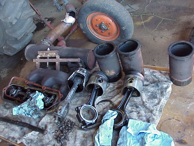

Sitting here I just can't believe it's the bottom end. I've seen them run pretty bad. The pics are from my BIL's jd350 crawler I've rebuilt. Number 2 mostly gone (parts of rings missing) and #3 totally wasted. All this and I was using it to push a pad for the garage. sounded bad, little power but it was working on 1.5 cylinders. No problem in the 1 mile crawl to get to my house and back.
Good Luck and keep us posted..
   / J D 855 won't start #14
Re: J D 855 won\'t start
pic #2
Rob J,
Those pictures are pretty bad. I think my bottom end is OK. No pun intended!
