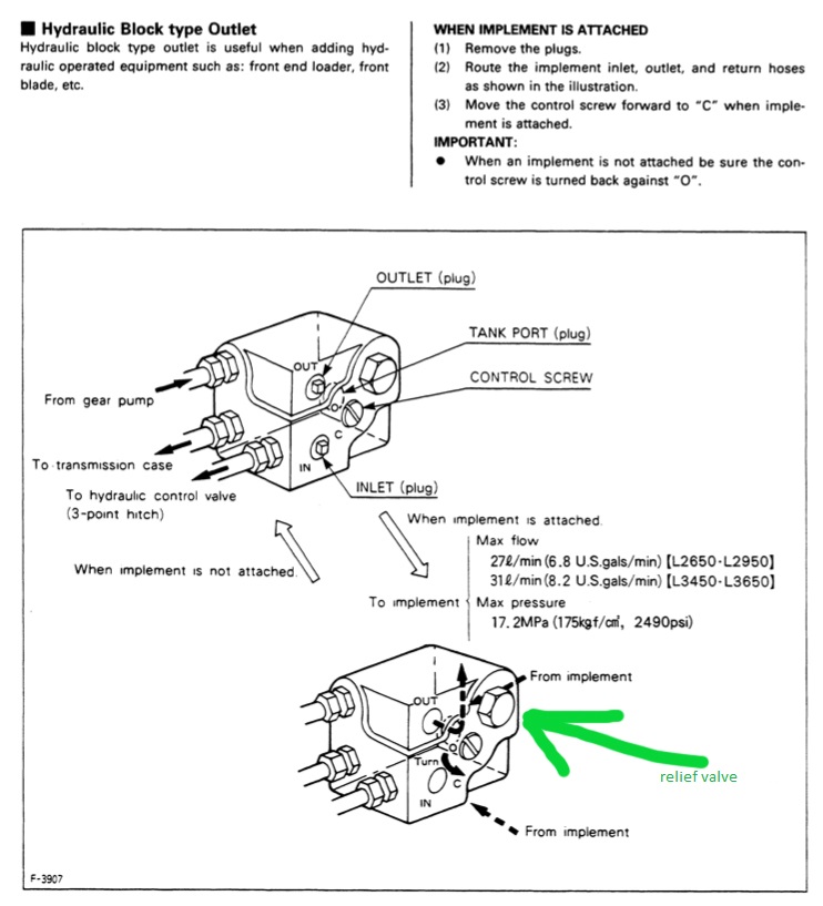

Okay ishiboo & JJ if I understand correctly now I should get the PB fitting for my loader valve asap and re-plumb as follows until I add a new spool (single or double)
Out port on block to in port on loader valve (already done by dealer)
PB port on loader valve to "in" port on Hyd. block
"Out" port on loader valve to large plug / port on hyd. block (indicated by green arrow in picture)
to make things right till summer when I install rear remotes ??
Once I install the rear remotes I simply need to plumb.....
Loader valve PB to new valve "in port"
PB port on new valve to "in port" on hyd. block
"out port on new valve then Tee' into the drain from loader valve at the large plug indicated by green arrow in picture .
Does this sound right ??
   / J.J. Rear Remote Hyd. Return Line ?? #23
No, not exactly.
The PB from the loader should feed the hyd block, and the hyd block feeds the 3pt.
So what you need to do is to fit the remote valve between the hyd block and the 3pt line.
The remote PB out will feed the 3pt.
Now, everything will be is series.and should work correctly.
All OUT lines can be teed together.

Bad idea IMHO. It does not matter where in the series it goes. If you do it as you propose, you will have to cut one of the hard lines to the 3 point and deal with either brazing or using compression fittings to fit in some connections in a poorly accessible location. In addition, you will need an additional means to bypass this if you ever remove the valve for any reason.
It can much more easily be added between the "OUT" on the hydraulic block and "IN" on the loader valve, or between the "power beyond" on the loader valve and the "in" on the hydraulic block. These are 3/8 NPT pipe threads connecting to hoses you can much more easily deal with. Both the "IN" and "OUT" on my hydraulic block as well as L3450s would have quick connects for a factory loader, I simply changed these over to ISO Ag connectors. For my post pounder I added long hoses with ISO Ag connectors. I can hook it up before or after the loader valve, it does not matter.
L3450, please look at the diagram it looks like the village idiot crafted. It's correct and simple to do. :) If you truly do NOT have 3 hoses from the loader valve, definitely get the power beyond port for it.
   / J.J. Rear Remote Hyd. Return Line ?? #25
Go back and look at the picture of the block, that plug you keep pointing to is the relief valve.
#26
Gotcha Leejohn
went back and looked at the parts breakdown and see what you mean....my bad / thanks for keeping me straight on that!

Guys i'm seriously starting to wonder why my Loader valve hasn't failed or my Hyd. pump hasn't blown up before now .

JJ on the hyd. block if the control screw is turned to "o" and only the 3 ph works , when it's set to "c" shouldn't i be able to plumb the new valve from
"out port " on hyd. block to "in port ' on loader valve
"PB port" on loader valve to "in port" on new valve
"work ports" to cyl.
"PB port" on new valve to "in port" on hyd. block
Both New & Loader Valve "Out Port" Tee'd together and routed to what I believe is the now (on my tractor) plugged "Tank Port" located on the front of hyd. block allowing the Hyd. block next to the engine oil pan
feed the 3 ph valve via factory steel line and return to tank via the steel line (as set up from factory / dealer)
Would this not keep everything in series as ishiboo suggested ?
   / J.J. Rear Remote Hyd. Return Line ?? #30
Either way will work.
Just depends on the amount of plumbing you have to do.
All return lines go to tank.

Here's a quick edit which shows the factory loader valve, and then the setup with the new remote valve added. A two spool valve is not much more than a single, so I'd get a 2-spool valve and plug the ports until you need it. (Or if you don't mind, plumb it now!)
Factory loader valve:
New setup, your new lines are in color:
Note the green line tees to the existing black line, you can do this with simple pipe fittings. Or as I mentioned you can bring it to one of the two red-capped fill ports on the transmission/rear housing, however the rear one has a vent you'll need to replicate if you go that route.
Hope this helps.
ishiboo in your second drawing are your drain lines run to the port on the lower front of the hyd. block closest to the tractor oil pan ?
