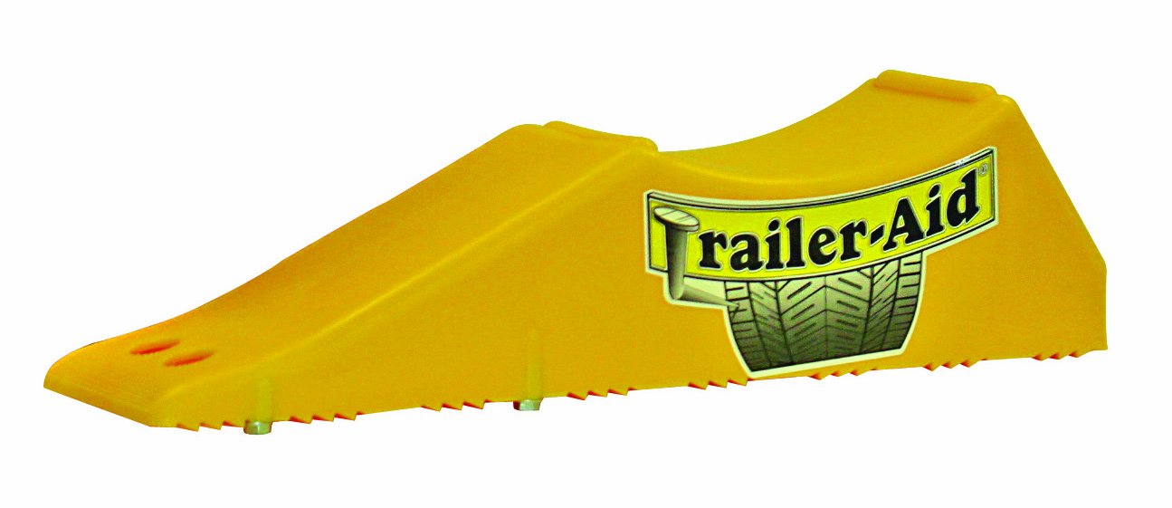

I want to replace the tires on my car hauler trailer and it seemed difficult to jack up a wheel with an empty trailer sitting on flat pavement using a small hydraulic jack, I cannot imagine doing this task on the side of the road with a vehicle on the trailer with a flat tire. I put the jack directly under the axle and had just enough room to pump the jack handle under the trailer, so a flat tire situation would really be tough. Is there a good jack design for tandem axle trailers that sit low to the ground? My springs are bolted under the axle so the trailer bed sits low to the ground. I prefer jacking on the axle or the spring u-bolt plate so that the tire is lifted directly and not jacking the side of the trailer so high the tire lifts from the ground. I think I read somewhere, probably on this site, where you can drive the good tire up on a ramp or block when it is attached to the tow vehicle and that might lift the flat tire off the ground but I really don't remember if that is correct. What is your solution?

If it's a tandem just pull the front wheels up onto some blocks until the back wheels are off the ground. Do the opposite for the front.

note these types of ramp "jacks". Consider when you are likely to get a flat, In my experience as well as 90% of the stories from friends, its come when the trailer was loaded. This means your likely to overload the single axle by useing the above type ramp jack.
Bending the axle tube, not going to happen as long as your jack placement is reasonably close to the spring perch locations.
As for changing on the side of the road, Its as simple as a bottle jack under the spring end or at the load leveler. Pavement side is simple, shoulder side is only slightly more difficult as it requires me to level a small spot to put my 2x10 block down then the bottle jack on that. Done it twice, biggest hassle is remembering to break the lugs loose before you get the wheel in the air.

I have one of these and have used it three times now, every time with horses in the trailer. Worked like a charm and way faster then jacking, which makes a difference when you have horses that start kicking the crap out of your trailer when you stop driving but don't open the door. As far as load goes, I had 4 horses plus tack one time and no issues, but I guess it depends on how much you load your trailer.
Camco Trailer Aid Tandem Tire Changing Ramp, Torsion Bars - Amazon Canada

The axles are meant to handle the dynamic loads at 55 to 65 mph or higher. Raising a trailer by driving one wheel up a ramp carefully at low speed is unlikely to bend the axle.
I suspect the weak point in any wheel-axle assembly is the tire. You are definitely overloading the single tire when you drive up a ramp, but it was already overloaded since the flat one didn't support any weight. And, you are overloading it at very low, or zero speed. Not a problem.
   / Jack method for tire changing, suggestions? #14
I agree 100%
I've used a wedge with a 3/4 ton pickup on a flat bed trailer once and with a full load of cattle on a 24'-32' trailer many times.
