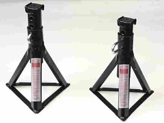

I'm not familiar with that type...could you post a link to an online image, perhaps? Thanks. My Hoe
Here are the ones I have.

   / Jacking up a vehicle for an oil change #55
Chris
Chris,
Thank you--I've never seen those "U-bolt" style jack stands before, but I can see how an accidental release (which is, theoretically, at least, possible, with the "Ratchet-type" or "Gear Tooth" type).
Thanks for the info!
My Hoe

   / Jacking up a vehicle for an oil change #58
Those do look pretty safe I have never seen them before.
I got them at Menards back in the 90's. I bought 4 pair on sale. Wish I had a dozen more.
Chris
   / Jacking up a vehicle for an oil change #59
The ratcheting jack stands are designed so once weight is put on them they can't be released. What I like about the style Cris has is the metal that connects the legs. More surface area to help spread out the load. All too often I see people put a 2x under a jack stand so they can use it on pavement or dirt. The ratchet style just has a small piece of sheet metal that contacts the ground. A thin piece of wood like a 2x will split. I would suggest if you own the ratchet style jack stands weld a piece of steel on the bottom of them.
I agree. I had a set of stands years ago and my dad had welded some angle iron aroun the bottoms of them
