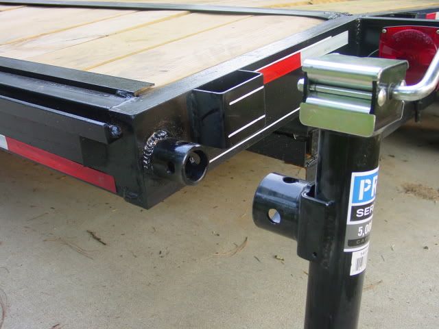

I ordered two 5000 lb. jacks, will get them welded on this coming Thursday.
Amazing how much I learn from this site. I might just survive getting this tractor!

Got the jacks installed yesterday, quite happy with the set-up.
   / Jacks at rear of trailer to eliminate "dip" when loading tractor? #45
Nice welds. Looks good.

HAY... that looks like mine :dance1: nice job

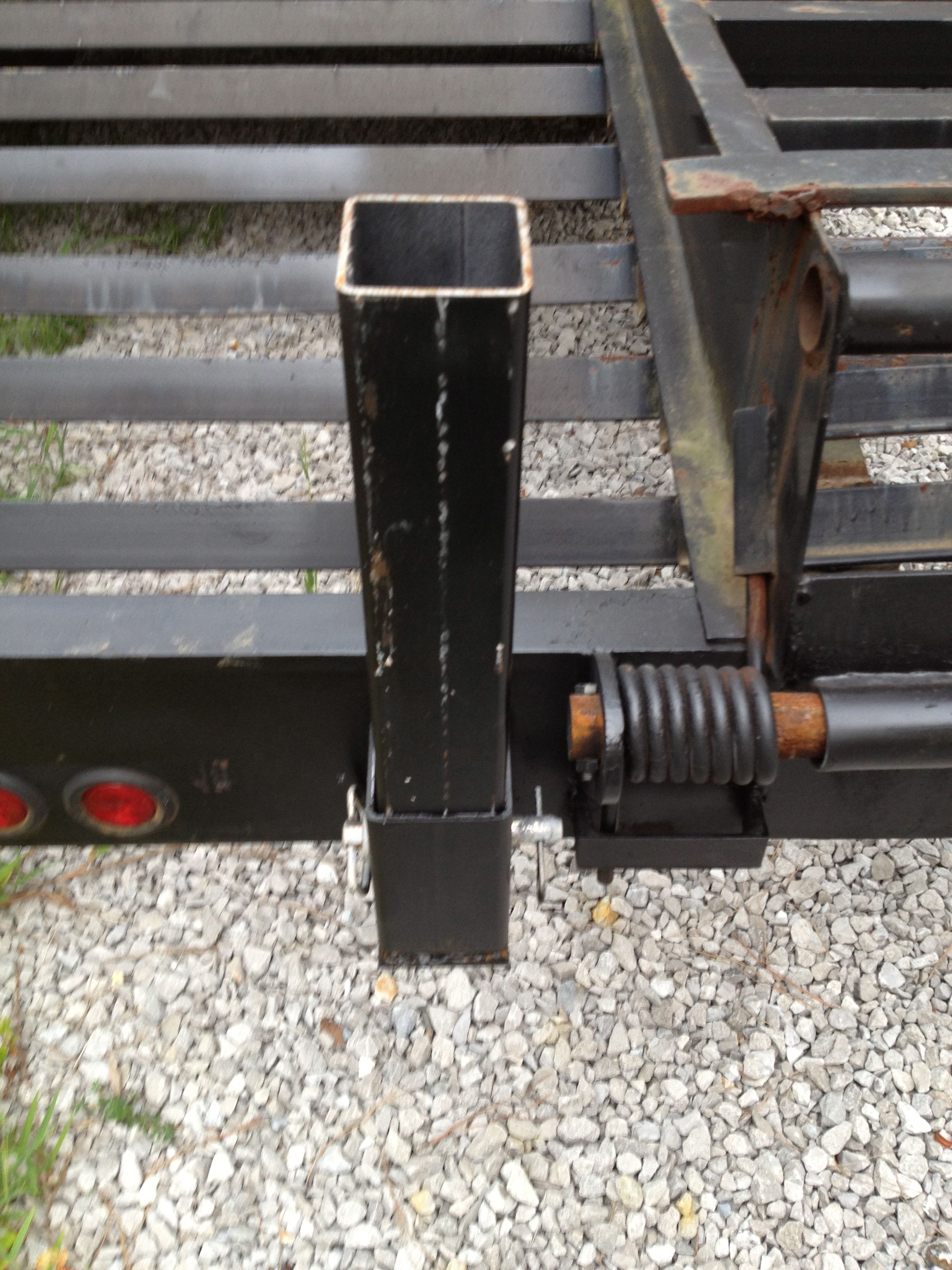

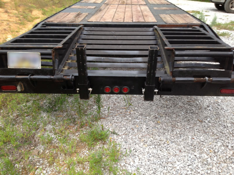

Looks good. I couldn't go that route, as my trailer is already max legal width and I wanted the jacks to always be there. Taking them on and off wasn't the best way for me to make sure they were always there. So, I went this direction. Works great and I've loaded an 18,000 dozer. I will say that you need to be careful that you leave a little room for the trailer to sag under the weight of the machine, or you will find that you have a stuck jack. In my case, I can move the machine forward to remove weight from the back of the trailer, but with a smaller trailer, you may not have that room.
Incidentally, these can't be removed from the trailer unless the rear end is raised abnormally high. When extended they are flush with the top of ramp.
I also always weld a center support on the ramp pivot pens. If you load track machines, it really helps to keep from bending that pin. You can see the extra support.
