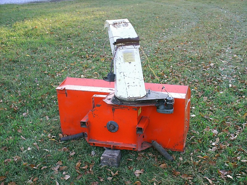

Currently own a mechanical PTO driven snowblower which must be converted to hydrostatic PTO driven snowbloer to mount to a Jacobsen T422D TurfCat II tractor.
Jacobsen does not support this series 400 tractor nor asseccories for this 400 series tractor any longer.
So must come up with something.
For refenence purpose to get across an idea of what is needed - Reference Jacobsen and Ransomes Jacobsen - Jacobsen Online Parts List for 51" Snowblower Mounting Adapter, link:
' + objMainFrame.getCopyrightMessage(objMainFrame.getCurrentOEMDesc()) + ' -- Jacobsen Turf Care: [066066 51\" Snow Blower Mounting Kit - Hydraulic]* * * * * * * * * * * * * * * * * * * * * * * * * * * * * * * * * * * * * * * *
Graphic is exploded assembly drawing for combine mechanical and hudrostatic PTO drive is shown.

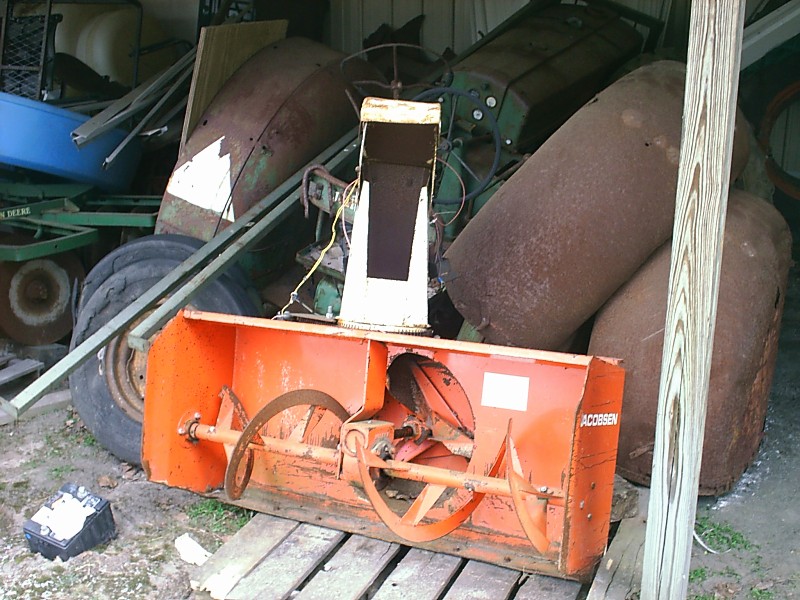

Found out Kubota supplies a very nice competative front mount hydrostatic motor snow blower for the Kubota F series front mower tractor using a quick connect adaptor (like me) - This little fact opens up my chioces and searches.
There is also a snow plow with angle adjustment (need the 4WD model) & a circluar brush pavement sweeper - all front mount hydrostatic motor snow driven for the Kubota F series front mower tractor using a quick connect adaptor (like me) - These little fact opens up even more my chioces and searches - for goodies.
   / Jacobsen Hydroststic Mounting Adaptor - SnowBlower Attachment
Jacobsen OEM Snowblowers, Hydraulic Drive Frame Adapters, Mech Drive Frame Adaptors, AQUILLON Quick Connect Adaptor, and Kubota F Series Front Mower Quick Connect Adaptor.
