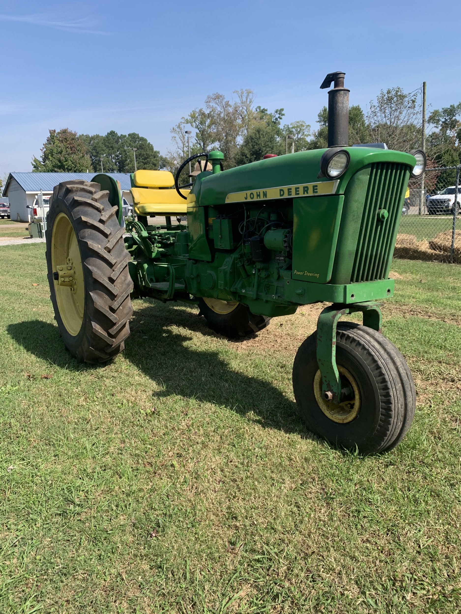

JD 1010R
Just got this gas 1010R. First one I have seen with a single front. Having trouble finding much information about the single front wheel. Does anyone know how many were built, Or share any info they may have. I believe it is a 1964. thanks

As well, share the s/n and the year can be confirmed.
Looks to be in good shape. How does it run? Any problems that are obvious?

Thanks, sn- 1010R 45627. Runs great, pto, three point hitch both work as it should. The single front wheel is what I liked about it. Just can’t find much info about that option.

I had...still have.... a very similar JD530 with a single front wheel. Be very careful because single front wheel models rear up easily. BTW, they were especially popular in corn country. But I'd set the rear wheels out and be careful.
After a few scary moments pulling a blade, I found a wide front for mine and to my amazement it bolted up exactly. A straight across swap. That tractor is still working today and the wide front cured the rearing.
I've also heard that the 1010 was fragile. I'm not entirely buying that. The 530 is not fragile, and I see no reason why the 1010 should be. JD didn't build fragile tractors as a rule. Yes, it is a lightweight machine, and one of the first when JD went from the old horizontal two cylinders to a more modern enginer...but that's understood. From the looks of yours, the PO understood how to use it right too.
Nice tractor,

On the rearing thing with a single front, it's not just a matter of weight, it's a matter of sideways resistance too. Maybe some other guys who used a single front tire configuration will chime in. The row crops weren't nearly so sensitive to the problem as the single front wheel tractors.
It's more than just rearing from lack of weight. Even if the front doesn't noticibly rise up, it gets light and then you lose all the side resistance. That doesn't happen with the row crop configuration so much because of how they are built.
On the single tire fronts, when the front end rises just a little bit you may not notice it until you have more traction with one rear wheel or maybe you notice that the steering is being unresponsive so you tap a wheel brake.
Then all of a sudden there is no side resistance from the front tire and the unequal push from the rear tires can make the whole front end swing sideways fast enough to make your vision blur. That's why I said be careful. Be especially careful with the wheel brakes. I scared myself several times until switching to the wide front.

Exactly. A wide front is not only lots heavier, it is pivoted in the center of the axle. So when one side of the axle goes up it forces the other tire down. Sideways resistance stays constant and the wheel brakes work well for steering.

Single frt wheel was included with Rowcrop models. Single frt wheel was designed to fit between rowcrops better than dual frt tires. Easier raising of frt end when pulling a load is due to less weight on frt end of tractor nothing more/nothing less IF LOAD IS ATTACHED PROPERLY TO FACTORY DRAWBAR
