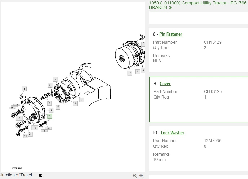

Per rscotty's suggestion, here is schematic of the brakes.
Key #9 is the cover.

/ JD 1050 locked Brakes? #11
They are super easy to take off. Don’t even need to pull the wheels. I would pull the brakes. They aren’t going to fix themselves and sounds like they need attention!
/ JD 1050 locked Brakes? #13
If they are stuck you wil have a problem taking the cover off as the shoes is part of the cover. Or shall I say it gets assembled on the cover
And yes it is dry brakes.
The lever going through the cover gets rusted and does not turn. That will be the problem you have to solve. If needed the other side on the cover is a square ? pin. Loosen that pin and turn it 90° to take up slack on your adjusting link.
If needed the drum comes out easy for machining .
Please check that seal. If its leaking replace it.
/ JD 1050 locked Brakes? #14
I've done a number of these type brakes. They are typical of Japanese compact tractors from that era. These are Yanmars and that brake design is notorious.
The trick is to get the cover off - and the problem is that the shoes are affixed to the cover and probably stuck to the drum as well. Wiggle it by fractions and be prepared to take your time. When you do get the cover off, the actuating shaft is probably rusted to the cover so deal with that.
The gasket is not necessary; use RTV. Machine the drums. Replace the springs. And I like to put a drain hole in the bottom of the cover.
