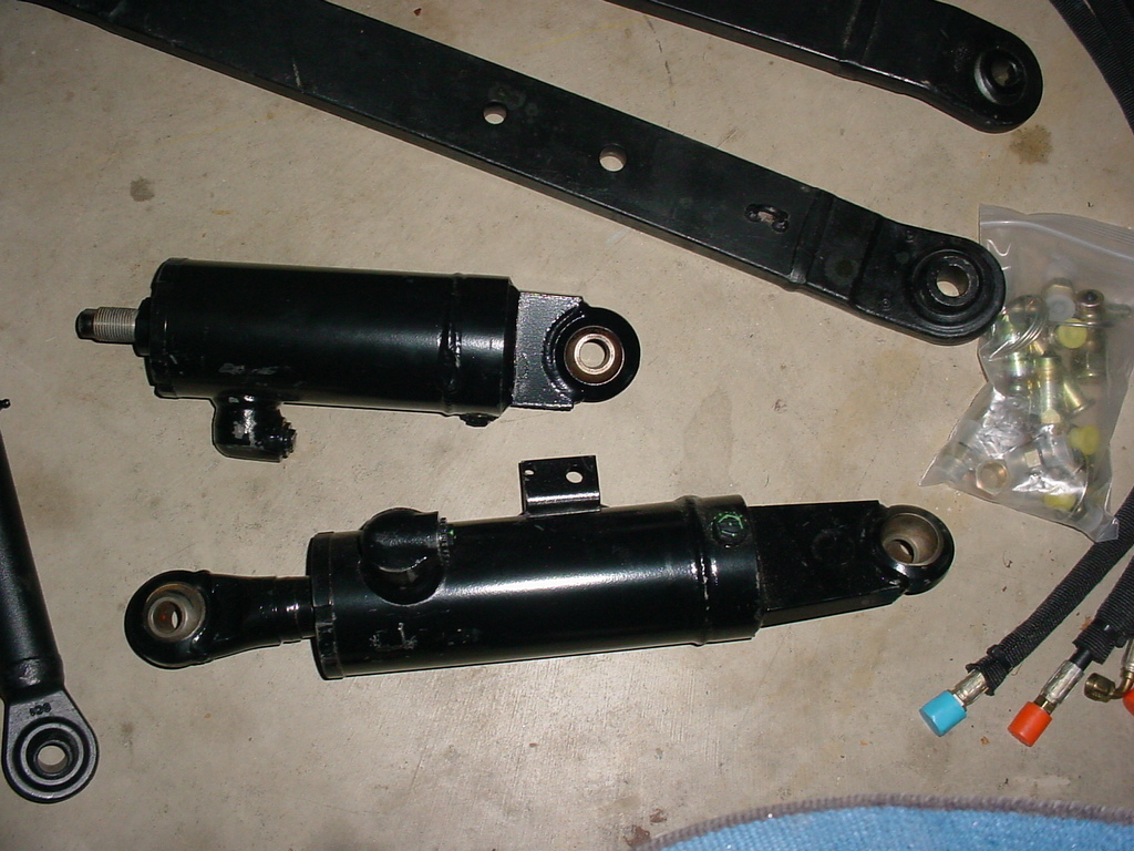

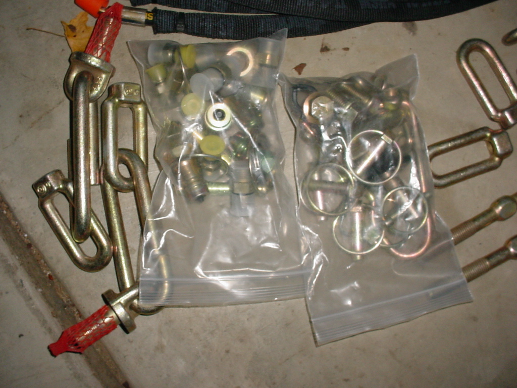

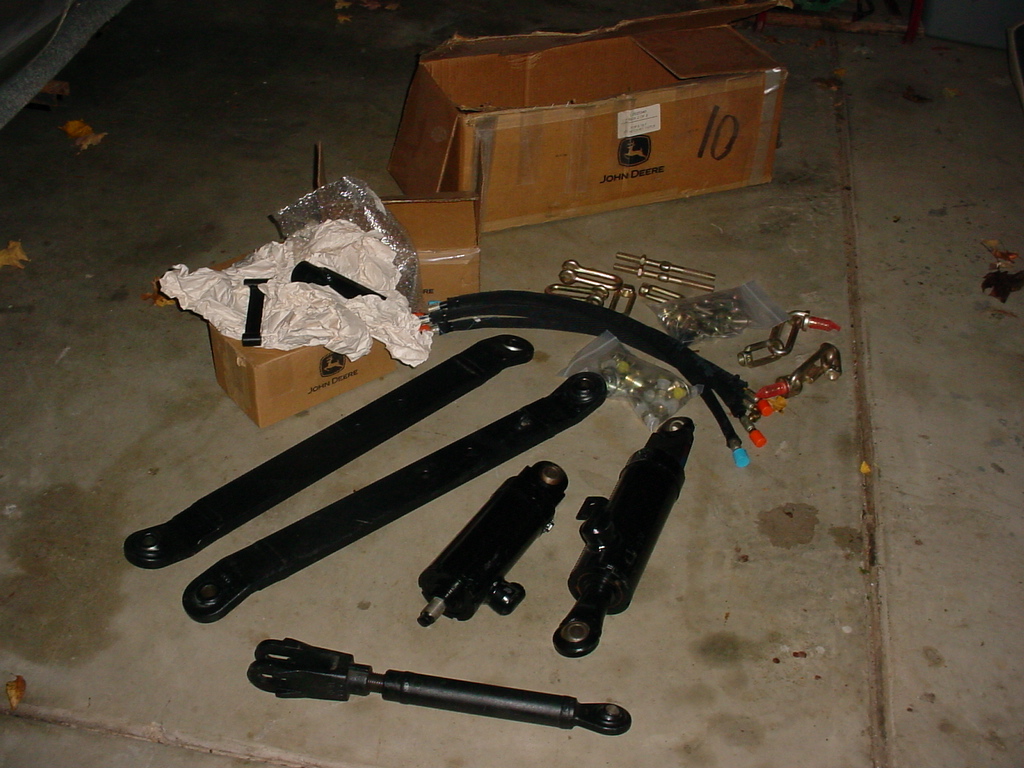

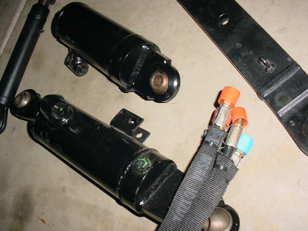

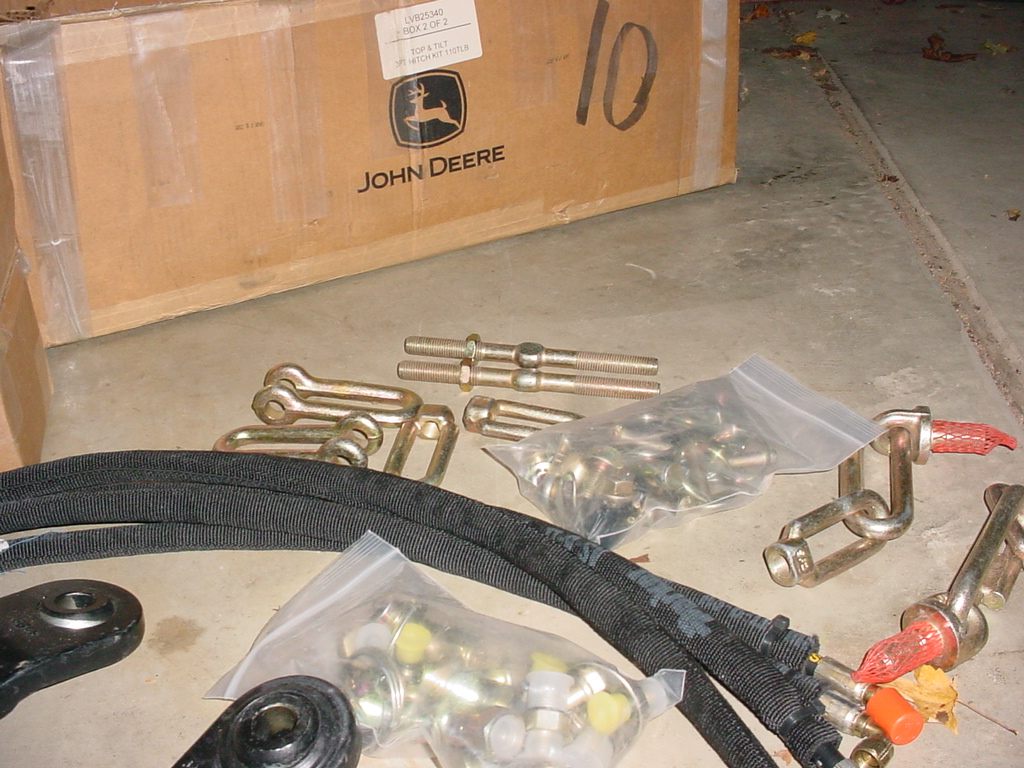

I have a new set that I'm selling the number is LVB25340 (top n tilt) I will send you a pm.

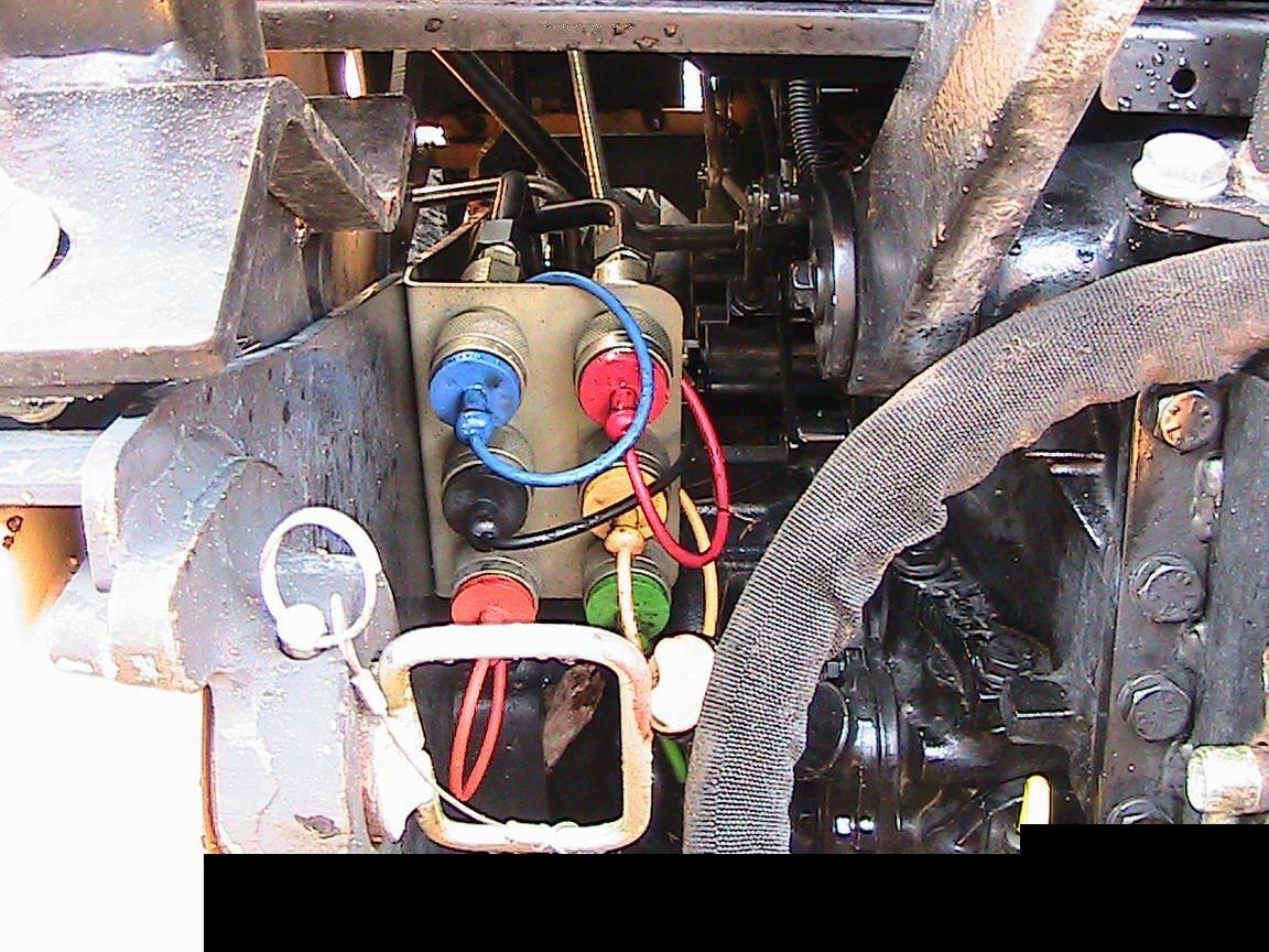

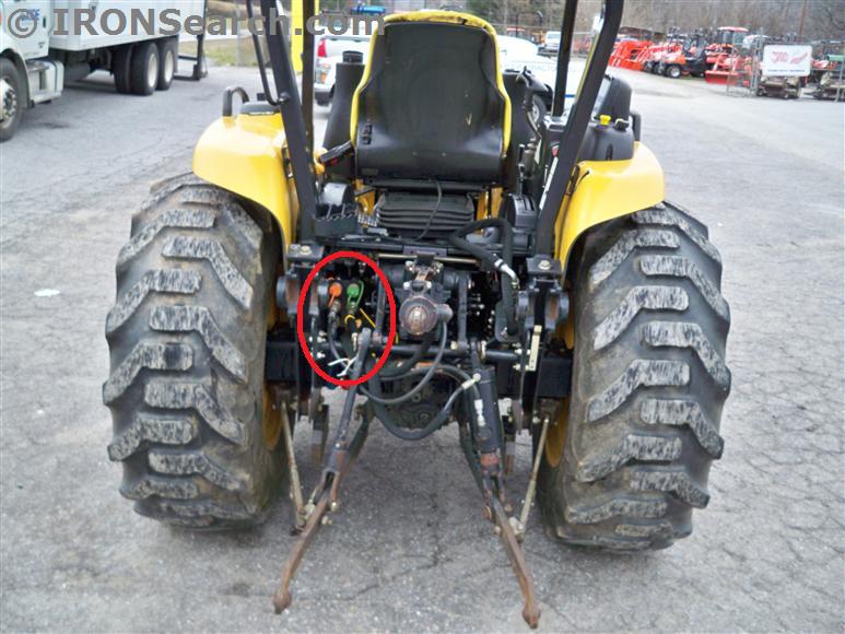

Note: You need to have rear hydraulics on the 110 to run top & tilt (six outlets). see photos
