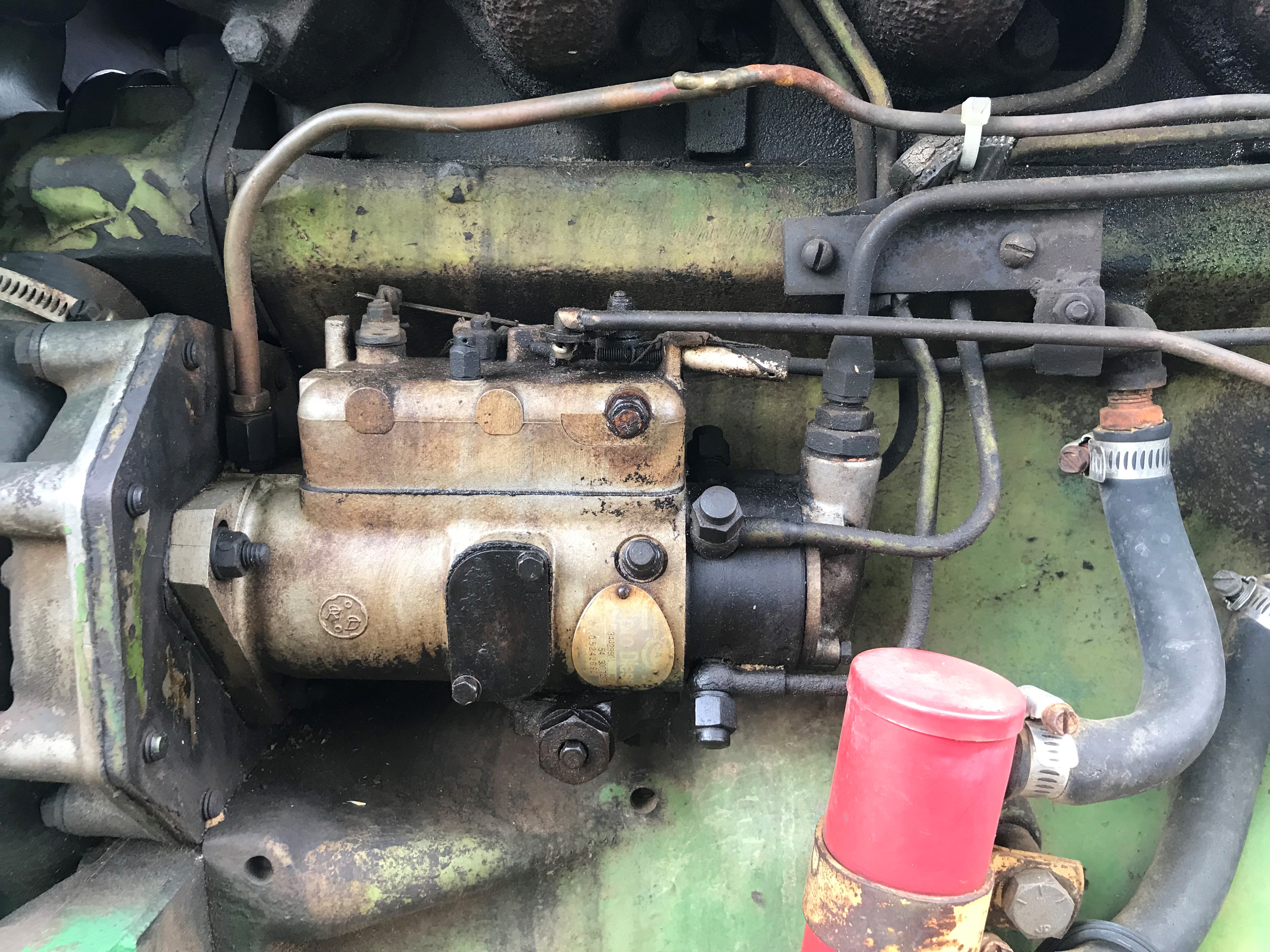

Pumpguy, are you saying I need to replace the flex ring on the pump drive shaft? Also, do I need to do anything with the timing before I remove the pump?
Below is a pic of the pump numbers

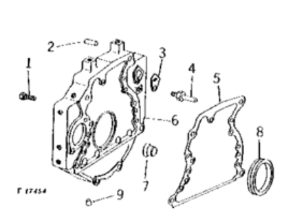

How do I find TDC on #1 on the compression stroke? The service manual says to manually turn the crankshaft clockwise. How do you do that?
   / JD 2020 Power Loss #15
Remove bolt with pin(key 4) & cover from flywheel housing then reverse pin & insert in threaded hole. With timing widow on IP removed utilize a flywheel turning tool(special tool) or screwdriver inserted in ring gear teeth to turn engine over until lines inside IP align then pin should fit in depression in flywheel. ""Don't forget to remove pin from depression in FW after IP is installed!!""

   / JD 2020 Power Loss #16
The drive on that pump has a MASTER SPLINE it will only go on 1 way.. its almost foolproof.
U HAVE TO remove the cover infront of the pump to gain access to the 3-1/2" bolts holding the pump drive to the engine drive gear..
U don't have to worry about #1 cyl being on compression stroke..
"U CAN" remove the side cover on the pump, AFTER u shut off the fuel at the tank or pinch a rubber line..
& line up ANY of the letters in there w/ the flat on the timing clip..
It sounds like u don't have the special engine rotating tool, so you'll have to use a screwdriver on the flywheel or a 15/16{?} socket on the alternator..
I've never timed one before removing the pump.. they're fool proof.. only go on 1 way.. UNLESS u move the gear after the pump is off..
THERE IS a timing line on the OUTSIDE of the pump.. on the mounting "ear".. that lines up w/ some degree marks stamped into the engine block..
WRITE DOWN what # the timing line lines up with..

Pumpguy, I see the timing line on the mounting flange of the IP and one on the timing gear cover, but they are not lined up. Do I just need to remember their orientation to one another or do I need to make a new mark on the timing gear cover? How do I figure out what part(s) to order for my pump and where can I order them from? Appreciate the help.
   / JD 2020 Power Loss #20
There should be a SET of marks.. degree marks.. or make your own..
"U" don't repair the pump..
