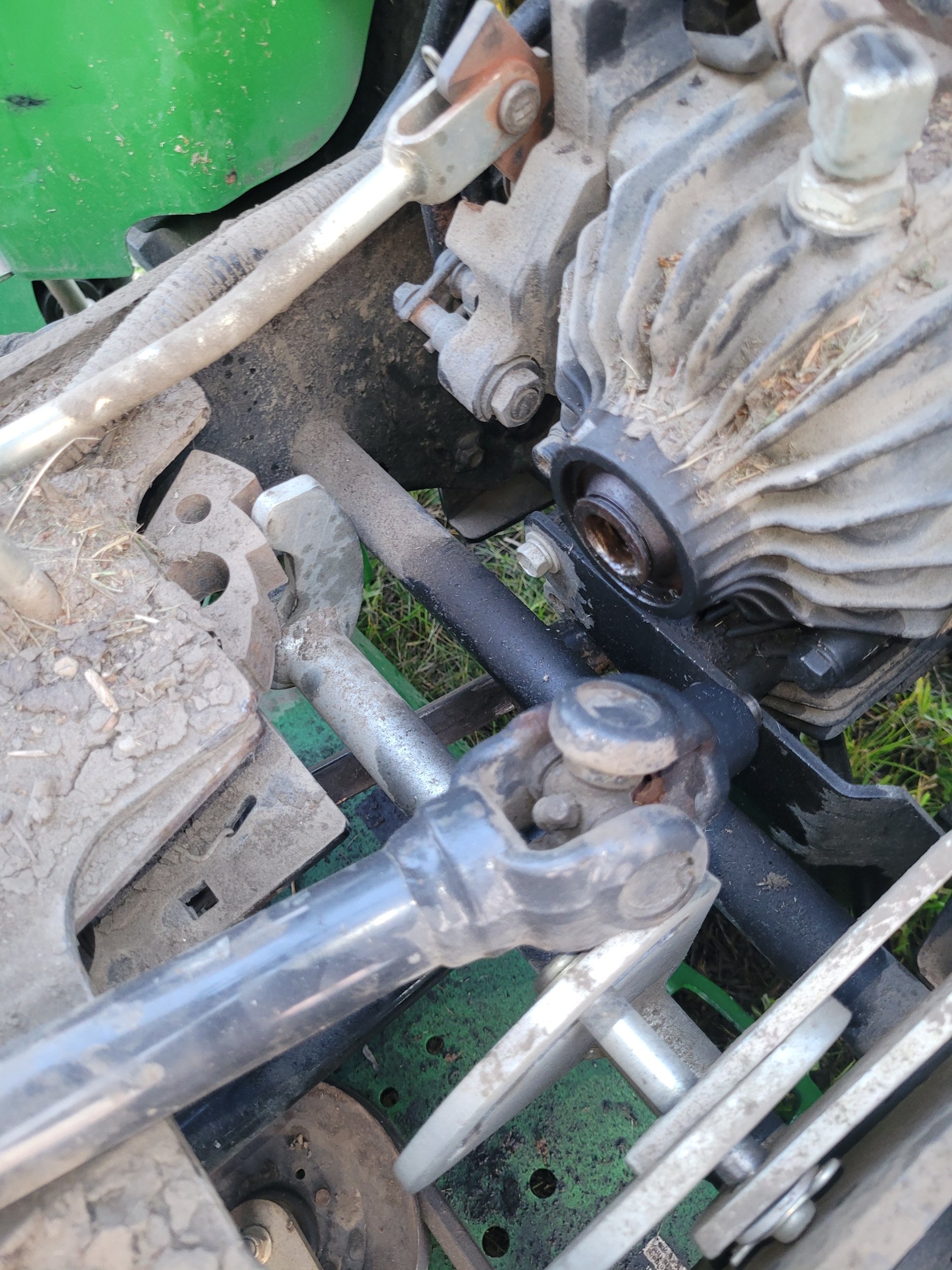

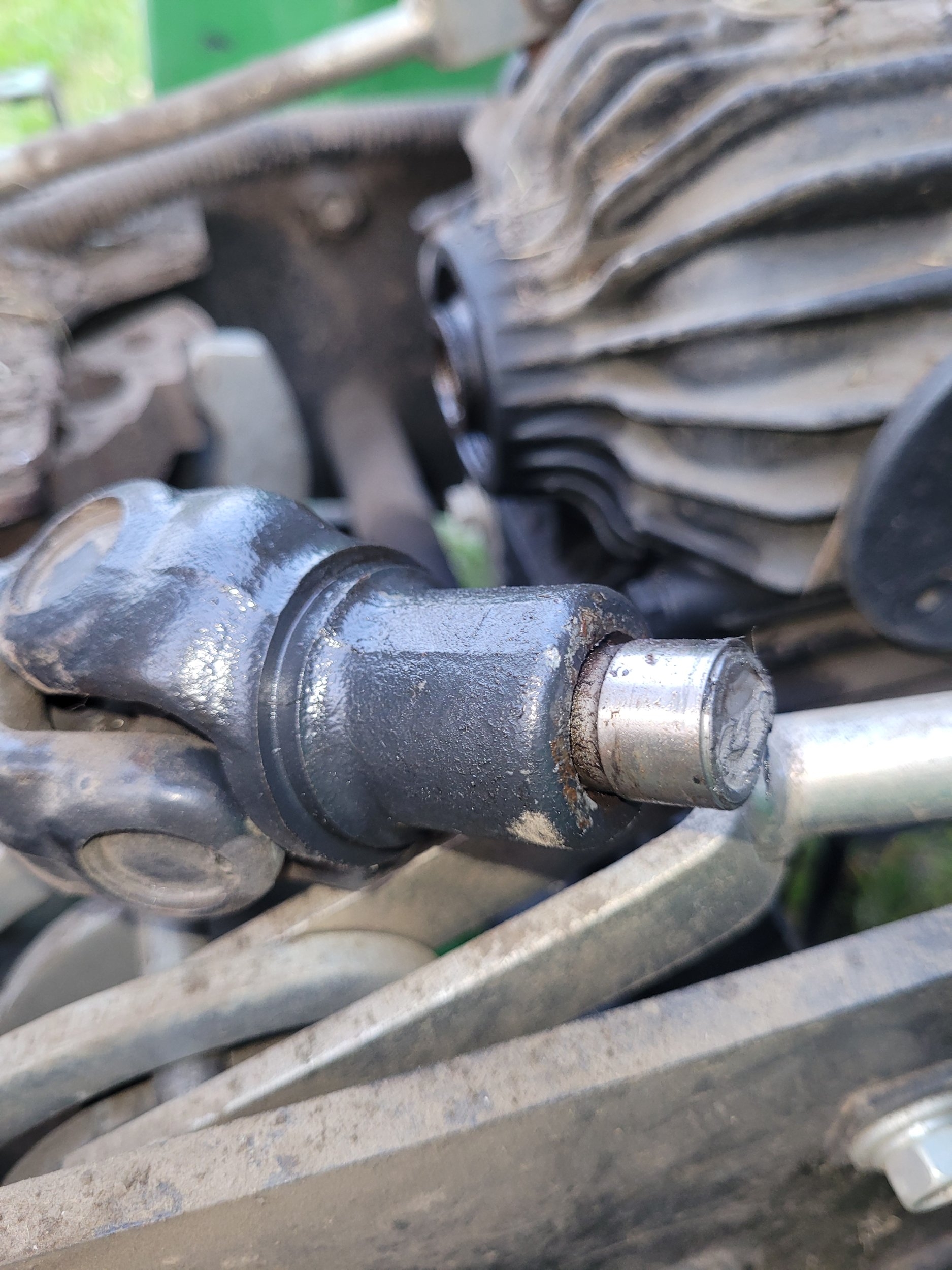

JD 2320 trans problem
   / JD 2320 trans problem #2
Doesn't sound good. Pics of where it snapped off?
   / JD 2320 trans problem #5
This being the front driveshaft (not the engine to transmission driveshaft) the first question would be whether it's a U-joint failure or a driveshaft failure. Actually either the U-Joint or driveshaft shouldn't be too hard to replace. If it's the transmission output shaft, that would be big trouble. More detail?
as i said the output shaft broke off
   / JD 2320 trans problem #7
:( I don't recall anyone else breaking the transmission shaft and I watch these posts pretty carefully for 2320 problems. I'm pretty sure the transmission will have to be pulled. I would suggest you call the dealer and get some info on what it involves. My guess is you would need a pretty well equipped shop to take this one on.

We have a 2008 2320 and we are experiencing the same thing, almost exactly 2 years after replacing the drive shaft for the obviously more common u-joint failure.
What was the remedy for your output shaft? A former JD mechanic has also warned it will likely need to go to the shop to tear apart the transmission.
