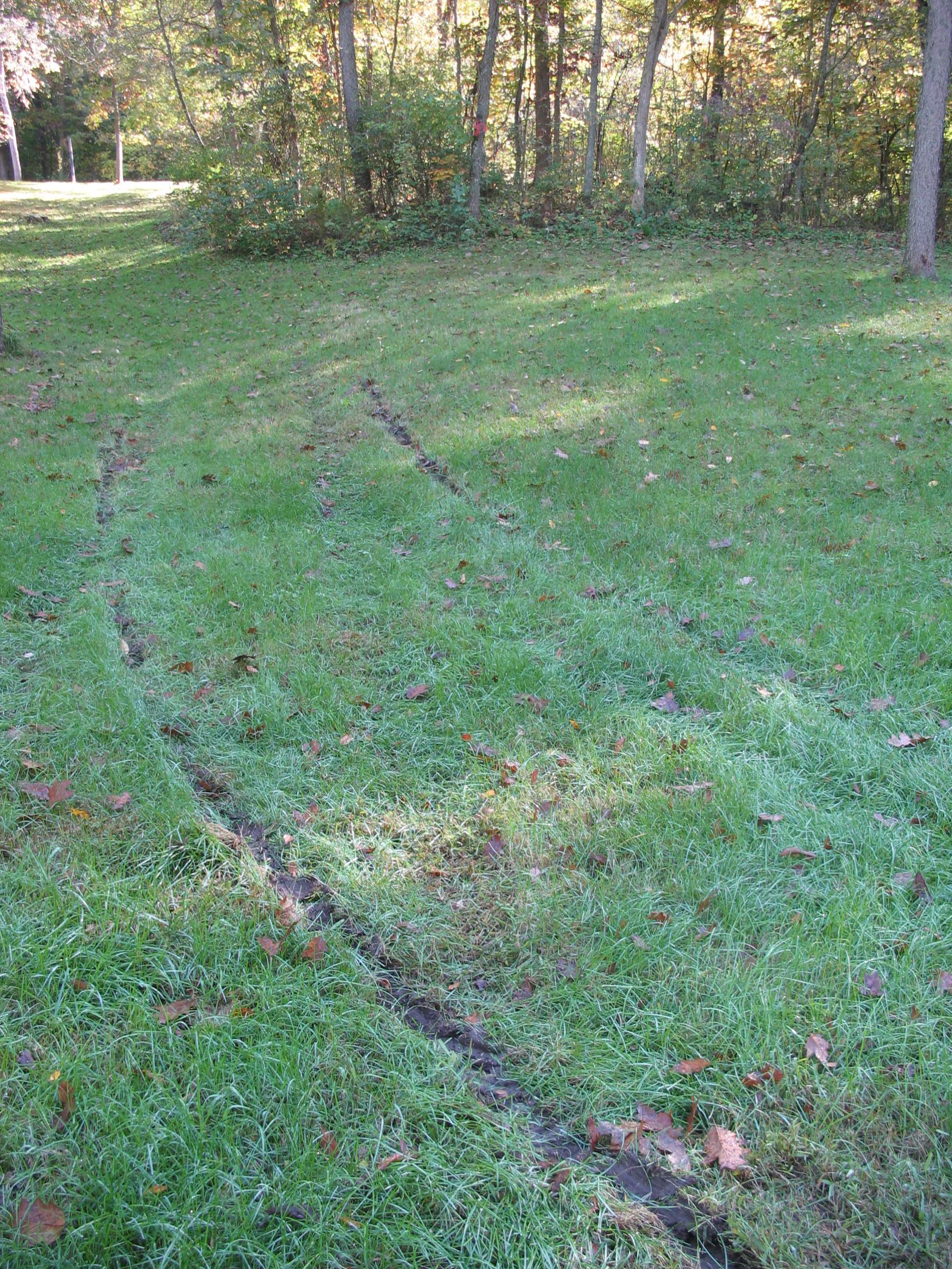

bought a new 25A flail. Am I wrong in being disappointed? Put faith in the dealer when he said it would be able to mow grass better than a finish bladed mower.
Issues that I've found with this machine:
1. Single belt drive; belt drive has no automatic belt tensioner.
2. Cutting rotor runs in same direction as wheels -- less effective in lifting grass up?
3. No scraper on height roller.
4. Has skid shoes on the height roller that are less than 1/2" higher than the roller.
5. No capability to adjust positioning, set with permanent offset to right side.
6. Height adjustment is way off -- I adjusted it to the 3-1/2" setting, per manual, but the cutters are at least 4-1/2" from the ground.
What really flipped me out when I ran it for the first time today is the amount of gouging of the turf caused by the skid shoes on the height roller. Not acceptable. It appears the only place this unit can perform satisfactorily (without tearing up the turf) is on flat level surface. My property has slopes and undulating terrain.
Reading the discussions on this website, I now understand the mower is a model that is at least 25 yrs old, maybe more. Are my concerns legit, and was I wrong to expect better results from a flail mower? If so, guess I made an expensive mistake.

IMG_3934.jpgIMG_3935.jpgIMG_3937.jpgLeonz:
thanks for the detailed response. I'm pretty confident, upon researching this forum and others, that the 25A is an extremely old model, which JD has not kept up with the competition for the market niche it sells in.
I'll try to answer/respond to each of your thoughts
1. I bought a new JD 4520 CUT with the mower. 60hp, welll-within the compatibility window for this mower.
2. The mower's offset from centered isn't a problem per se. My point is that other flails, eg land pride, caroni, have the flexibility to be adjusted from centered to offset. This doesn't relate to my problem with gouging up the grass.
3. Lower links are controlled by their telescoping arms, held to a certain length by a vertical pin. A nice setup, copied from the New Holland CUT's. I have them adjusted to restrain the attachment in a centered position with minimal sway.
4. The lower 3ph arms are not the problem; the offset of the mower is not the problem; the back roller's bearing housing and skid shoes are the problem.
5. Yes, the unit is a JD 25A -- hey, give me a little credit.. I am not an imbecile. I took delivery on a unit that is what I ordered.
6. Regards the belt drive -- I haven't removed the cover on the drive end, but I don't see any belt tensioner and there's nothing in the owners manual about it. It spells out a procedure for manually tightning the belt. Again, I mentioned this because I found most other brand flails have a tensioning system, and I added this to my conclusion that this unit is a very old design.
7. I gave the unit it's first test drive last Tues, after setting it up -- adjusting cutting height, hooking it to the tractor, etc. I had it at 3-1/2" and lowered it to the ground, then slowly engaged the pto and drove slowly for 30 yds. Looked back and found deep gouges in the turf on both sides.
8. Grey market tractor?
9. The mower is designed for forward spinning cutting rotor; the cutters supplied are "duck-foot" type for best cut on grass. It has 36 cutters, not 72 -- you're thinking of the double L shaped cutters.
10. The skid shoes I refer to are on the height roller's bearing housing. The body of the unit also has skid plates. The bearing skids are less than 1/4" higher than the roller, which is the primary problem -- it leaves no room for uneven ground, slopes, turns, etc.
11. I did exactly what the manual said to get it set to proper height. Including leveling the unit with a level on the gearing housing brackets.
I have considered whether shortening or lengthening the top link would raise the bearings' skid shoes higher but it won't.
12. Changing the dirction of rotation is unfeasible. The housing is built to accomodate the path of cuttings from a forward spinning rotor. The cutters are mounted for a forward spin. This isn't a setup issue -- it's an old design that is outdated by other flail mfgrs.
13. I do agree with you that the cost is significant and a buyer deserves full supplier support. But this particular model should have been redone in a 25B update to improve its performance. My dealer assured me it would do a fine job on grass; he didn't consider that I don't have a property that is as flat as a pool table, which is the only surface that would survive the gouging from the skids.
Jim

Seems to me the roller's bearing housing is low just like you say. Should have a roller about an inch bigger in diameter.
The skids in the front aren't gouging are they?
   / JD 25A Flail mower #5
I found the problem,
The mower is sinking, tipping forward and gouging the sod.
The side weldments need to be about an inch off the
ground while mowing at all times.
You can unscrew the top link to lengthen it and do this
and it will prevent gouging once you lock the hydraulic
position in place.
You need to lock the three point hitch hydraulics on
the draft controls or the needle valve under the seat
to prevent it from dropping while mowing.
Once you have the right setting you can lock it in place.
If you have the type of adjustable lower links that collapse and expand to accomidate the various implements you need to extend the lower link arms fully and adjust the top link after that to assure a level cut.

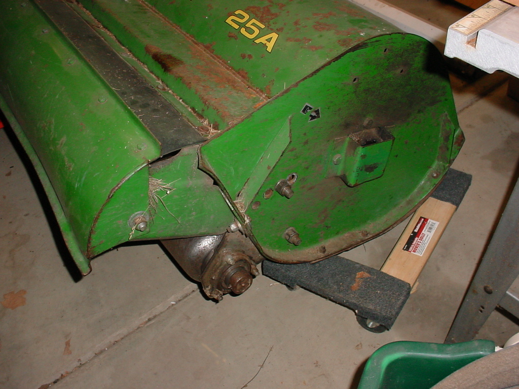

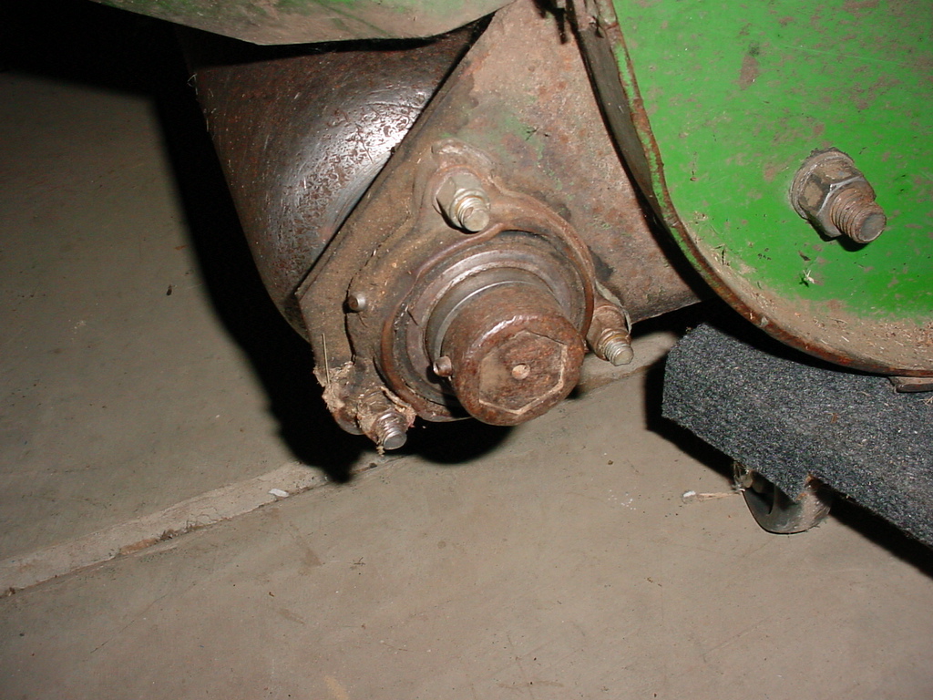

Not to hijack this thread but since we're on the subject (25A flail mower) I have notice that in RedHawkRidges photos that he has weldments that cover his roller bearing, on my 25a the weldments appear to be missing. Is that something I should be concerned about?
His is a newer version, and also uses only two bolts, instead of three to bolt the bearing to the housing/end plate piece. I would say that you could add some mini skid plates/weld mounts, but that would only reduce the already minimal clearance between the assembly and the ground, increasing the likelihood of drag marks.
   / JD 25A Flail mower #12
Why are you getting drag marks at all? I'd say your roller drum isn't low enough.
