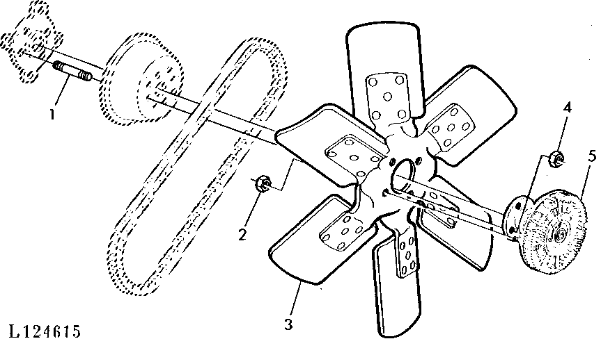

Do the 2755's have a fan clutch? We have a 4440 w/out and had a 4450 with. The 4450 did have one, and it wasn't fully engaging when the engine got warm chopping silage. Dealer had a clutch lockup kit we installed so the fan would run at full speed all the time.
   / JD 2755 running too close to hot #18
