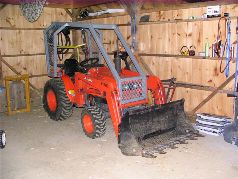

Looking great Greg! Love the limb risers. The whole thing reminds me a little of the way my brush cage was when on the LB1914. I'm feeling a little nostalgic!
   / JD 3005 full cage ROPS/FOPS build
#94
Ron, feel free to share pictures. Helps with the nostalgia. And I'd like to see what you had.
   / JD 3005 full cage ROPS/FOPS build #95
you've seen her before :)
Here's the build thread that shows more details if anyone is interested.
http://www.tractorbynet.com/forums/customization/172660-cage-kioti-lb1914-3.html

Lol... I feel dumb... I forgot. Thanks for indulging me.
