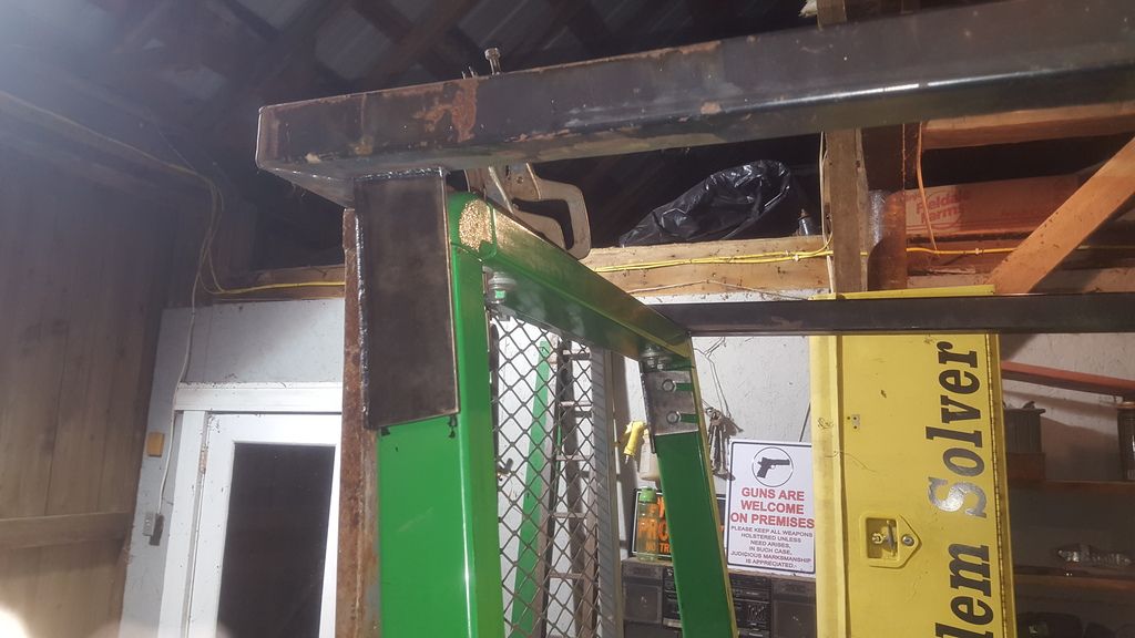

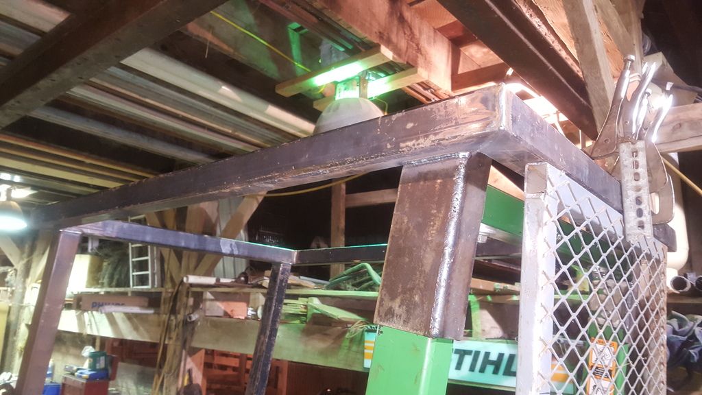

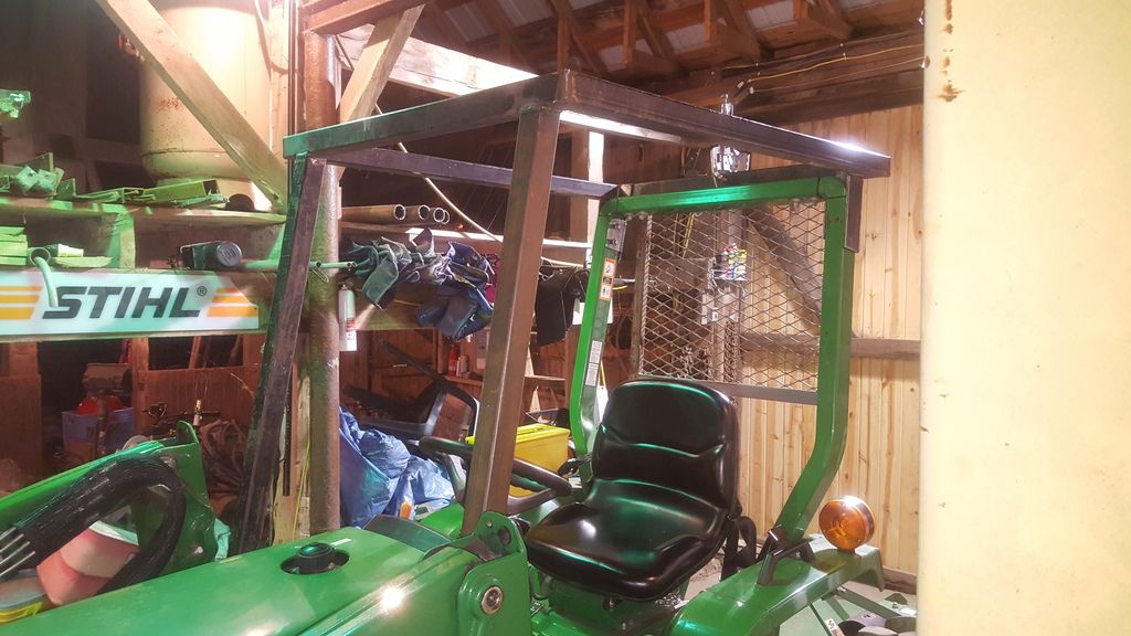

Got more done today. Final version of the front post. I gave up on paint today, due to low temperatures.
I did get it welded together, mostly. Enough that I won't worry about using it, and can still add the gussets in the corners that I want to, then remove to paint later.
I also stuck some little pipes up to see how limb risers will look.
Now, due to dirty looks from the wife who expected me to be helping wrap the kids gifts, I gotta go help with that...
   / JD 3005 full cage ROPS/FOPS build #45
http://s699.photobucket.com/user/wv... Uploads/20151219_114335_zpslvk6nop0.jpg.html
http://s699.photobucket.com/user/wv... Uploads/20151219_184304_zpshbjy21xc.jpg.html

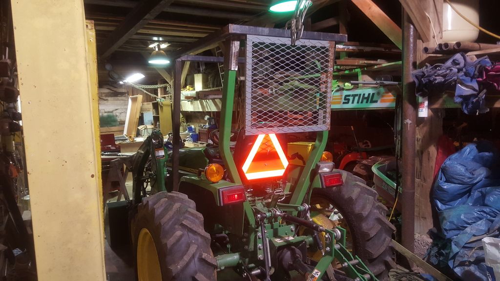

Here's some additional pictures
I want to add some screen on the back too, not sure if I will use this one in the picture or make something out of a bigger sheet of expanded metal I have, with tighter weave (smaller holes).

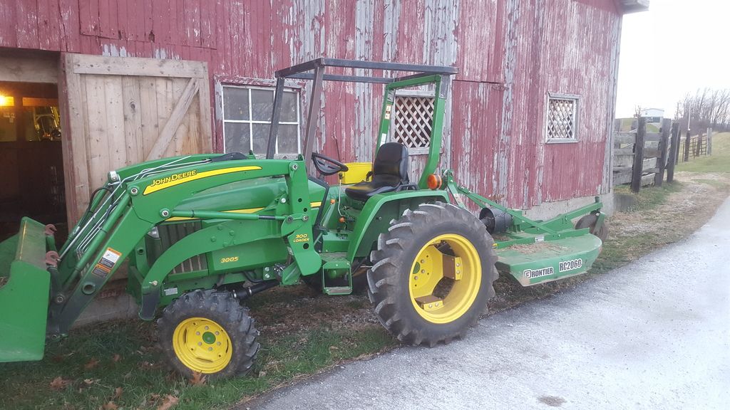

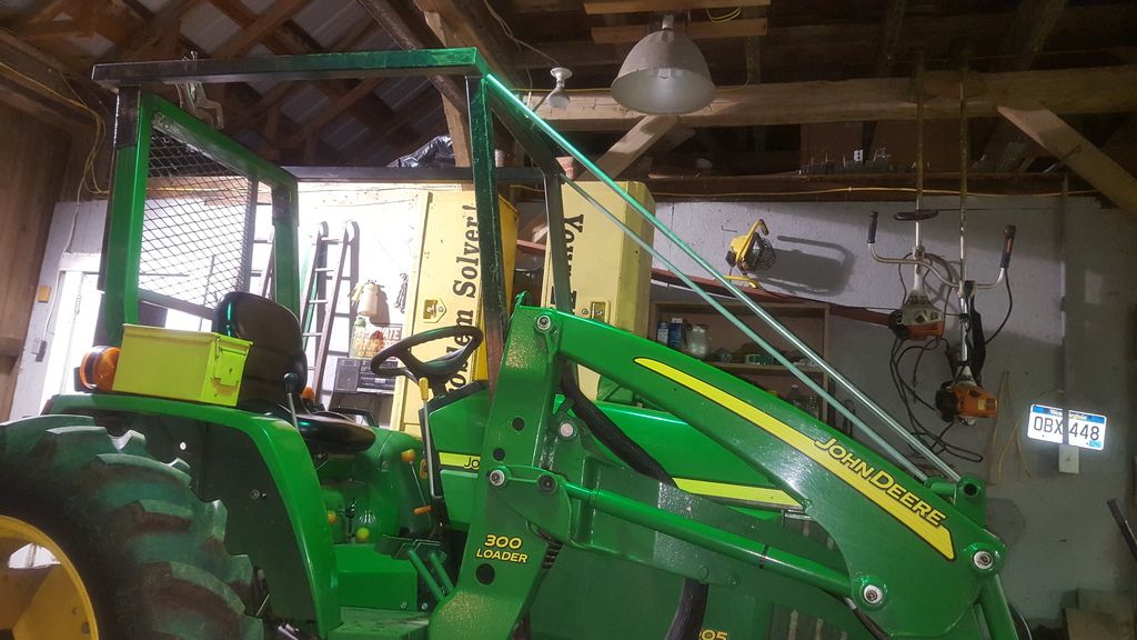

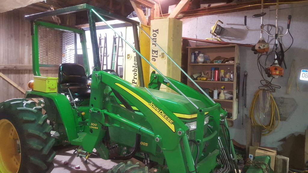

Here's a shot from today, outside with less background clutter, easier to see what it really looks like.
I was cleaning out the pony's stall, and while tramming back and forth to the manure pile, I noticed that the motor noise resonates inside the box tube... noticeably louder, and that's even with no top cover yet. Never had any objectionable noise increase with the plywood I had on it before.
   / JD 3005 full cage ROPS/FOPS build #49
The tube is acting like a speaker and amplifying the vibration. You'll need to stiffen it up more to get it to quiet down, or add more mass.
   / JD 3005 full cage ROPS/FOPS build #50
Spray foam?
