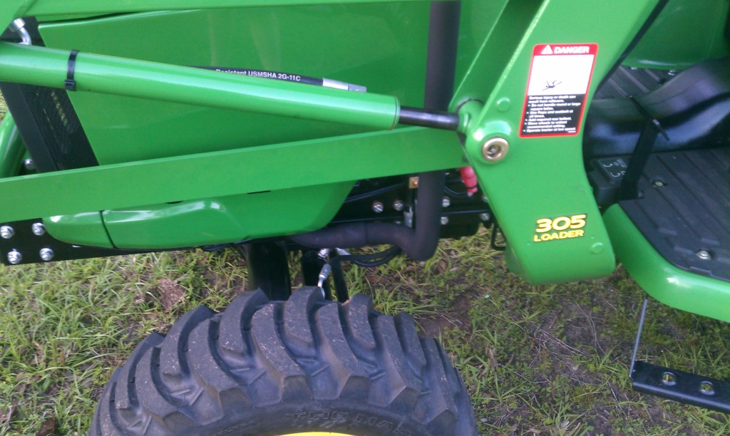

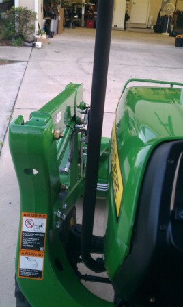

I ended up removing the factory ex. pipe. Took the pipe and a few measurements to my local muffler shop. Came back with the set-up in the pics. Bolted on & wow! Night & day difference on the fumes. No problem openeing the hood. Cost $100.
Thank you to all for your valuable advice!

Nice job, I like that better than going thru the hood.:thumbsup:
   / JD 3032E Exhaust Fumes #20
Looks good! Is this 1 piece or 2, with a U attaching to the existing pipe and the multi-bend riser for the rest? Is the pipe supported any way by the FEL frame? Any vibration against the hydraulic lines of the FEL? Thanks.
