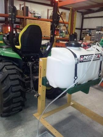

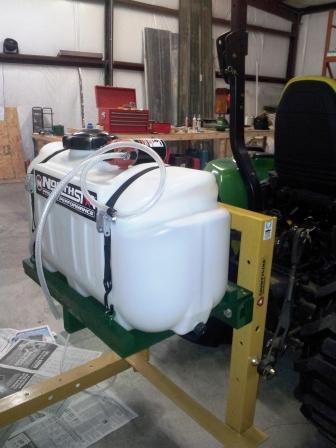

Yes the wires (green and black) both capped , male and female connectors. They are under the seat in the back in the center. They are coming out of a larger wire harness and only have current when the light switch is turned on to the headlight/rear work light position. I connected a "2 flat" 12 inch cable to the wires and rapped some electrical tape to hold the 2 flat in place. I will then splice another 2 flat into the electrical wires for the sprayer. This will work perfect for me as my headlight harness is broken right where it goes in behind the instrument panel and I have no plans to repair it and no need for headlights. So I will use the light switch as an on off power switch for the sprayer and my soon to be acquired ATV Fertilizer spreader.
BTW: I ended up purchasing a carry all and then just built a shelf out of wood for the sprayer. I am not a welder. "Final integration" and testing will take place over the next 2 weekends.

The final product. Sprayer attached to Carry-All with home built shelf, integrated electrical. Look out weeds here I come.
