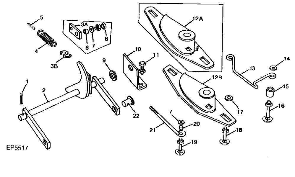

Thanks for the replies. The number on the one needle I have off is AE 36262, so it appears that the needles are correct. Both needles do not come close to the twine disk. They pass about an inch behind the knotter mechanism (without touching it at any time). I will try and get a picture this evening and post. I also found the tucker finger shaft (# 2 in attached diagram) to be bent. I am replacing it.

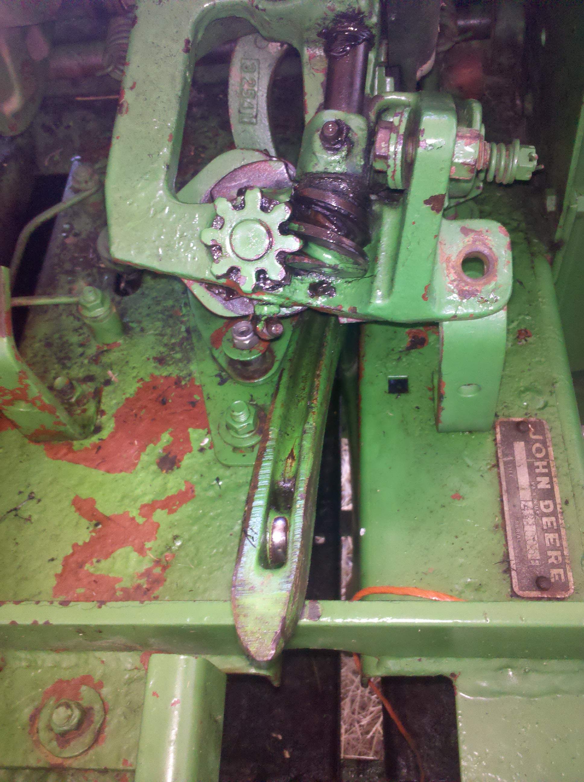

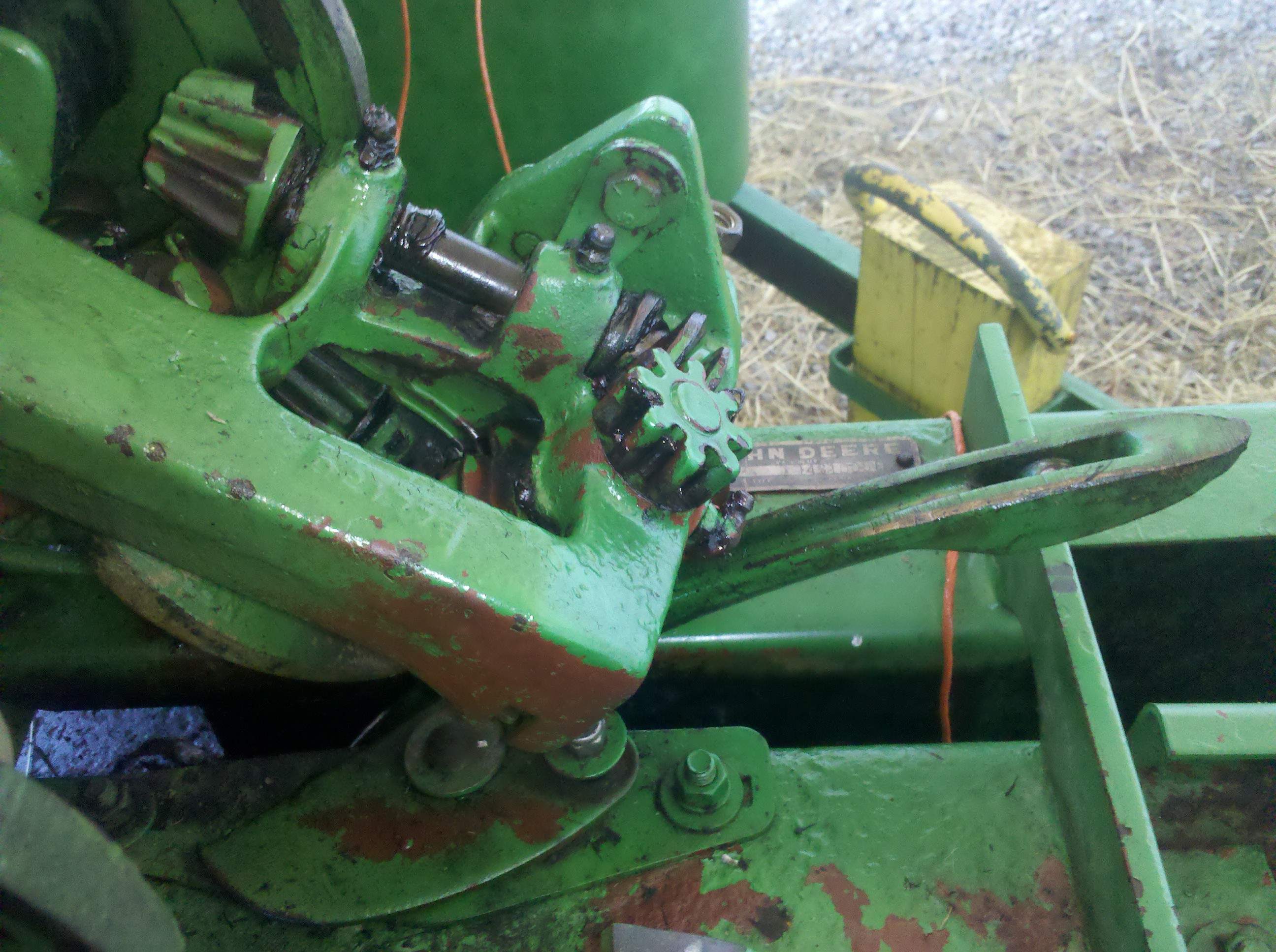

Here are a couple of photos with the needles all the way forward. With the needles in their home position there is 4-6 inches of the needle in the bale chute. The more I look at it I believe the needles are bent. Thanks for any ideas.

Just an observation from your pictures. First your knotter stack is not pinned down. It looks like the wiper arm is wiping and it should not be with the needles in that position. The needles appear to have a weird curve to them.
My guess....things are out of time and the needles got bent.
It looks like a mess.:(

That's for certain. I'd take a hard look at the needle carriage as well. I'll bet it is bent, too. Hope you got a screaming deal on this baler.
/ JD 336 Baler Problems #9
The only way I know of to find out which part or parts is bent is put a good/not bent needle beside the old needle and compare the curvature!!!!!!!!!!!!!!!!!
kuboman I will remind you to check operation of the PH stop as it must be malfunctioning for needles to get bent.
I'm with you as Rick as I also will bet the needle frame is bent.
