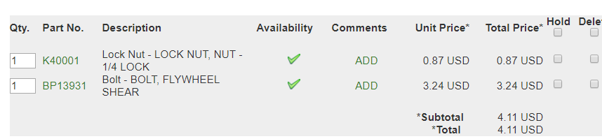

If your baler baled 104 bales correctly then I seriously doubt it has a timing problem. More than likely jd110 mentioned the problem when he stated that needle lift shaft brake isn't tight enough. When replacing flywheel shear bolt utilize the correct shear pin shown in photo below.
