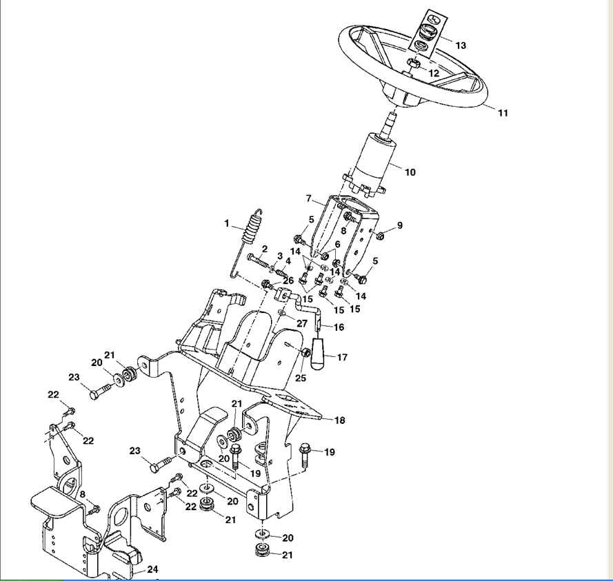

Egon,
I will definitely do that. I am assuming that I will need to take the wheel off and start DOWN from there. As I can't seem to see anything from the bottom. I have this diagram but I still can't understand how that steering control unit works, is it electronic? As I do not see a shaft coming through that unit.
JD4Life

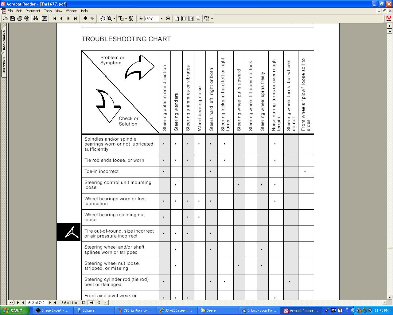

   / JD 4200 steering wheel spins freely #13
jd
Here is the trouble shooting chart for the 4200.
Note the three possibilities under "steering wheel spins freely"
1. mounting loose
2. shaft splines worn off
3. nut missing or loose
Have you removed the cap in the center of the steering wheel to see if the nut is tight, or if the splines are normal and turning the innards of the steering valve?

   / JD 4200 steering wheel spins freely #14
JD4; from the diagram it looks like the steering flow control happens at the cartridge looking device just below the steering wheel.
I'm a long way from my 4200 and manual so there is no way I can go look. It would seem there is very little mechanical linkage involved. Is the steering wheel down tight on the shaft?

Been There, thanks for the trouble shooting. The center cap on the steering wheel came off and wouldn't go back on. I assumed at the time that it was because of the excessive spinning. The steering wheel however did not feel loose and it got "tight" when the tractor was not running.

Have you taken the covers off of the base of the steering wheel?:)
Cap not fitting may be an indication the steering wheel has lifted up from the cone it sits on. Can you tell if the steering wheel turns in realationship to the nut that holds it down?:)
My opinion indicates the problem may lie with part 10 and above as shown on the previous diagram.
Note: Most times my opinions have no correlation to actualities.:eek:
   / JD 4200 steering wheel spins freely #20
I'm of the same opinion as Egon. A disconnect (missing or worn splines between part 10 and the steering wheel), as it fits with the OP and the troubleshooting chart for the 4200.
