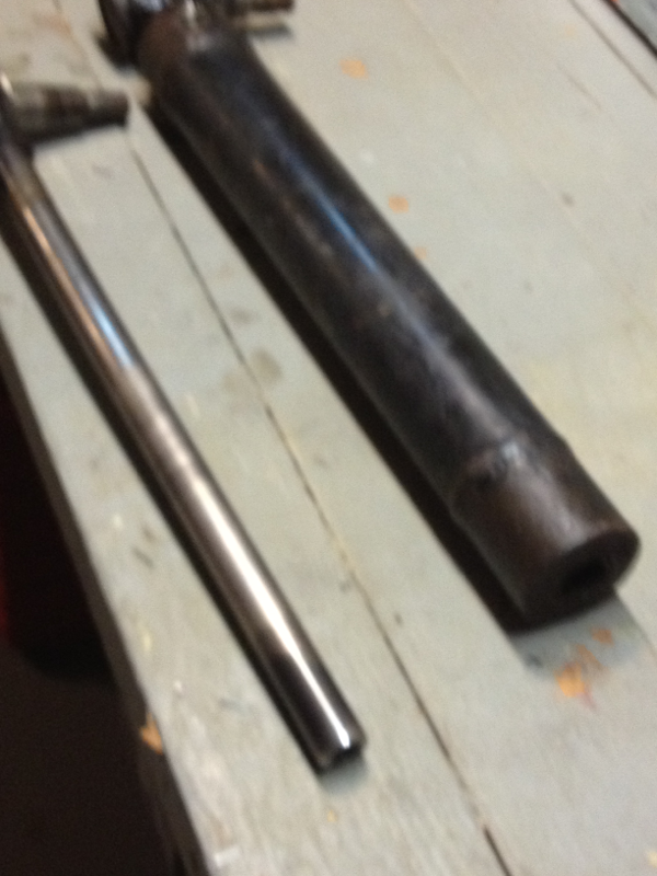

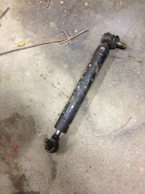

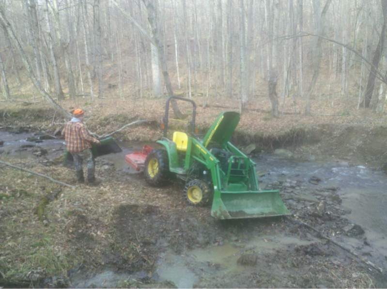

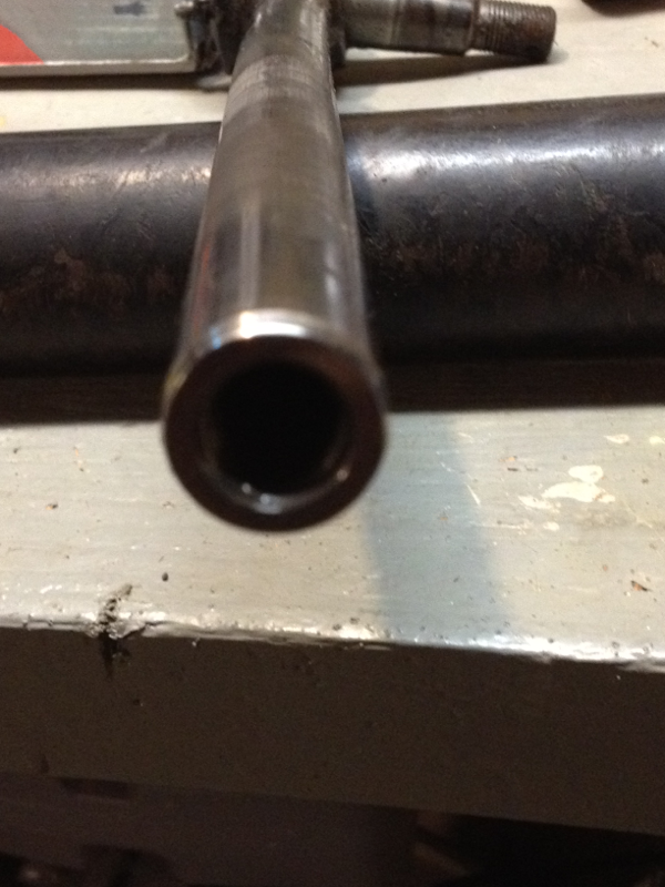

I was just doing some grading with FEL when it came apart. I did not hit a rock or anything. After replacing the cylinder it appears that the shaft on the old one simply came unthreaded. I guess I have a spare one, but would sure like to know how to not have it happen again. See photos.... Again thanks to all for the help!!

Unthreaded?
Don't understand what can "unthread". Pics don't reveal much to me.
But the tractor disabled by the crick is a sad sight, for sure, for sure.

Sorry for the lame pics. The inside of that shaft is threaded about 1" from the end. When I put the shaft in the cylinder fully I can turn the shaft and get it to rethread onto something in there (assuming a piston of some sort). The part number for the new cylinder is LVA14159.
