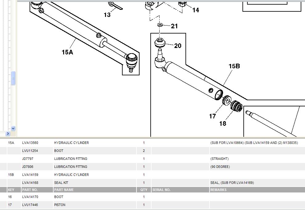

I'd appreciate it if you could post a pic of the (new or old) cylinder for reference (whereas a kit is not avail), It may help someone in the future
   / JD 4200 steering wheel spins freely #28
jdparts shows two different cylinders for the 4200.
One (15B) looks to be repairable and the other (15A) not.
#29
Ok so it was the hydraulic cylinder. When I unbolted it from the steering knuckle and disconnected the hydraulic lines, the shaft slid right out. It appears that the piston stripped the threads right off. New one bolted in and it is working great. Pictures to come.
   / JD 4200 steering wheel spins freely #30
This is good news. Not a cheap fix, but it could've been a lot worst. :thumbsup:
