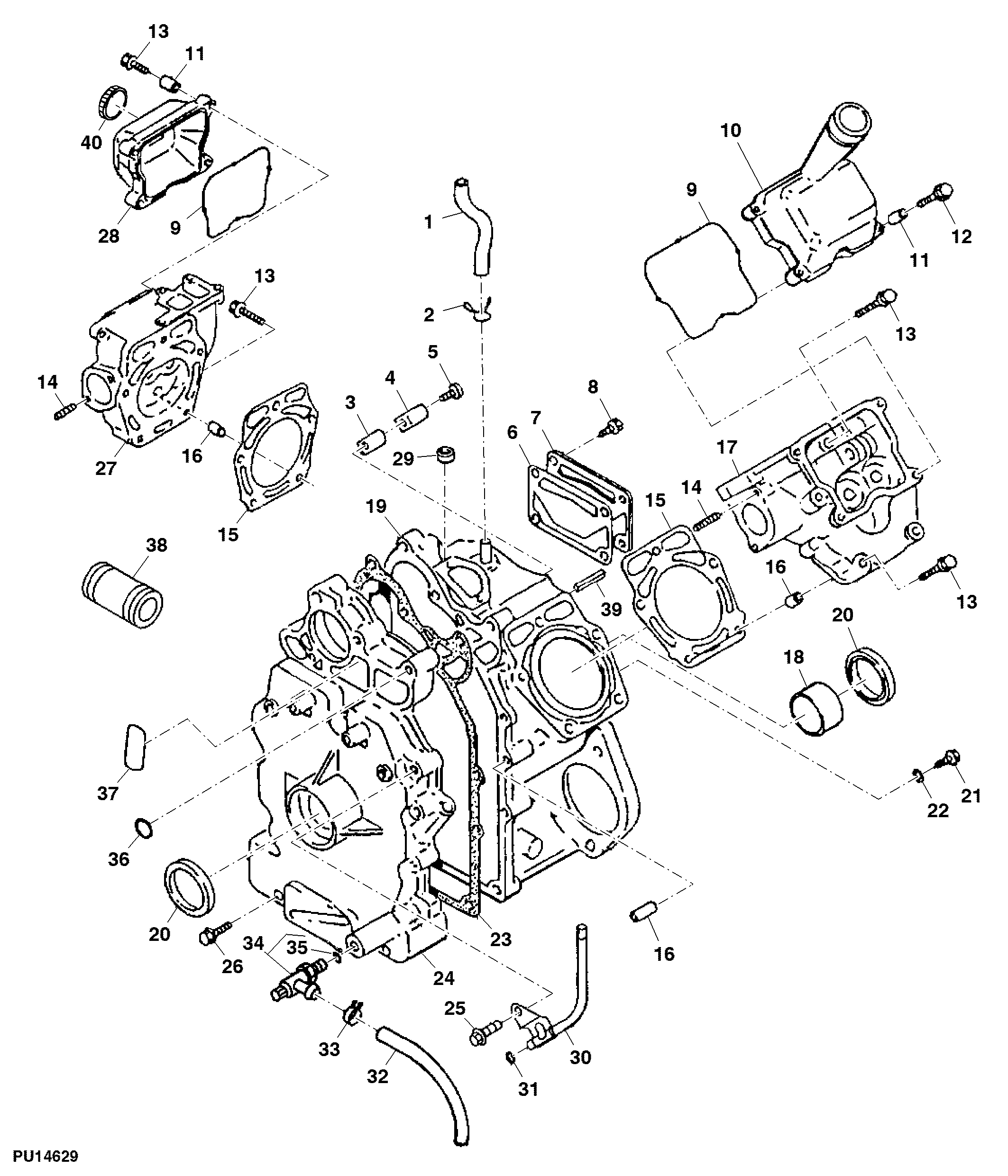

Spanner, While I'm waiting for the Design Change Cap Filler Assy I thought I'd get myself in trouble by reviewing the JD Parts Catalog Cylinder and Crankcase Diagram, Keys # 3-8 + TM page 3-45 both that you cited in your response, By-the-Way, Thank You for pointing me in the right direction......
OK, so we're talk-n "Manometer" and "Breather Reed Valve".....:reading: Not to complain but it would be nice if the JD TM referenced the same item name that is in the Parts Catalog or better yet, add a better description in the JD Parts Catalog Name. Is Key #3 the "Breather Reed Valve" ? I'm guessing because it's the only item call a valve......:scratchchin: Did a search for the Breather Reed Valve in the TM, only mentioned twice, no illustrations nor hint where it is..... Seems if they're asking to check clearances I should have access to it......But Again :scratchchin:
Lastly, a Dumb Question, if I were to try (emphasizing on the words "Dumb" & "try") to tackle replacing Keys # 3-8, does the engine have to be pulled........ THANKS

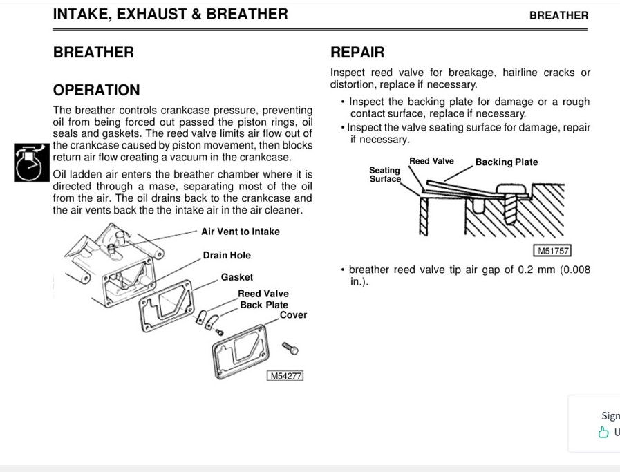

MORE INFO: Searching the Net, found a JD Component Technical Manual (CTM) for K Series Liquid Cooled Engines - CTM 39 (OCT 93). Had a page with good visual of the Breather Reed Valve (attached), good stuff, now I need to locate, if possible................

Well, degreased the engine so I could see what's-what.........looking, looking....Hey, I see Key #1 M118835 Tube, OK, looking to the rear......around back and, and...... "FLYWHEEL" !!!, WO NELLY !!! The ol'd cover/obstruct everything Flywheel Routine...... Huh, nice illustration in the Component Technical Manual (CMT) (previous post) but in reality, not-so-accessible......... The CMT forgot to mention Engine removed and on a stand, Flywheel off to Inspect Reed Valve......Hope that Fill Cap Design Change addresses the issue, I suspect not....... RATS !!!!! NOTE: If you remember the expression "RATS" you're old like me....... Bad week to quit drinking, "Honey could you get the case out"........ :drink:

Breather valve is under a cover plate beneath the flywheel. Items 3-8 in the Parts Catalogue illustration:
The Tech. Man. references the drain-back hole being blocked and valve plate clearance gap spec's. on Page 3-45.
You'll see here (above) that I referred to the Breather being "beneath the flywheel".
The CTM you have will have a section on "flywheel removal".
#3 is the Reed.
#4 is the Backing Plate.
The "Manometer'' is the tool used to measure Crankcase Vacuum (iirc in "inches of water"). You can make one with a length of clear plastic hose. Google is your friend.
If necessary (and you don't want to remove the engine) just take off the hood and front headlight support frame, battery etc. to gain clear access.
In the section "Operation" replace the word "mase" with "Maze" for clarity.
The oil vapour passes through a convoluted path (maze-like) to cause it to drop the oil from the air. Other manufacturers use a gauze or mesh to collect the oil. That filter medium usually needs cleaning. The 'maze' concept is supposedly maintenance-free.
