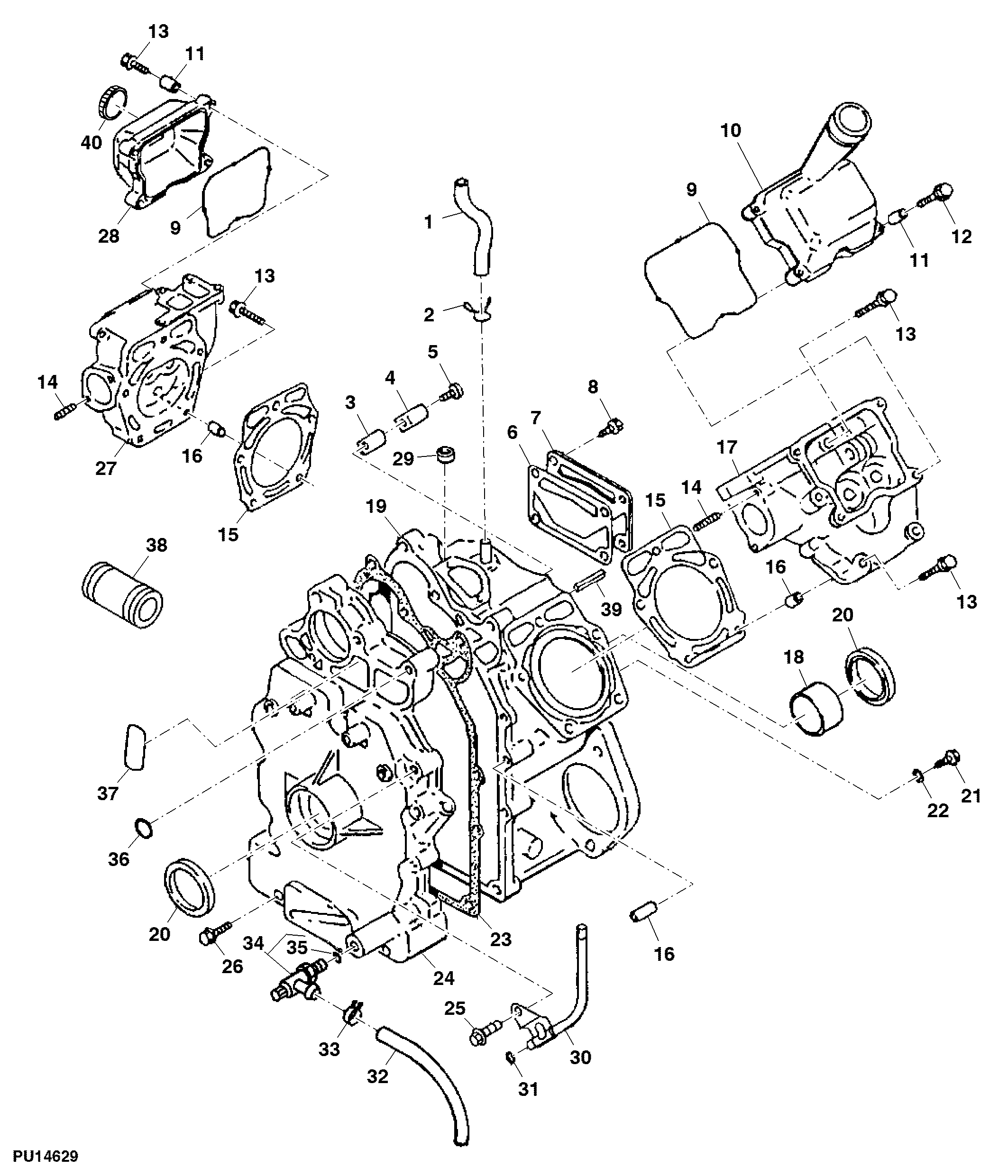

Good Morning, I am Mechanically Challenged and here I am again seeking some words of wisdom. I own a '93 JD 425 K Series, V-Twin, Serial # M000425A013701 that has been a workhorse all these years, I make sure I keep up with the Scheduled Maintenance, never a problem and always at-the-ready.
Yesterday I thought I was having a Senior Moment, I added some oil and double checked the dipstick on level ground then headed off to the field. Half way out there I noticed oil running down the side panel, shut-er-down and much to my surprise the Oil Cap was lodged down in the engine compartment? (Huh, I thought I put the cap on ?).....Also noticed the dipstick not seated, up a good 1/4 inch from the rubber seal?? (Huh, I thought I seated the stick ?).....Loosing It !
Wiped the excess oil off, checked the dipstick, reattached the oil cap and off I went and 10 minutes later "The Flow" and shut-er-down, sure enough cap popped-off and thank goodness lodged itself in the engine compartment again and not laying out in the field a good 500 yards from the garage. Noticed the dipstick was also standing tall again? So, gingerly got it back to the garage where it resides before any further damage?..
I checked the Air Filter that I changed-out 20 hours ago and it is completely dry, normally I would see some oil residue on the inside......
I scanned some Blogs and focused-in on the term:"Blow By" with the likely culprit, the Breather Valve with a tube that connects to the Air Cleaner area (probably clogged). I've done a search on JD Parts to see what these parts are and under the Alphabetic Listing Breather Valve that takes me to the Cylinder Head and Crankcase Parts View listing 40 individual parts, nothing jumping out at me? The Blog went on to also mention the Reed Valve and how it was pretty much impossible to replace without pulling the engine (NOT GOOD! $$$$$).

If I read this right, the only symptom is the "oil flow" ?
No other loss of power, poor performance, poor starting.. ??
Asking because blowing the oil cap and throwing out oil is not in the list of problems for troubleshooting the 425 in the service tech manual.

I suggest you do get a copy of the manual. It was revised in 1999 so make sure you get that or a later version, not 1996.
You can buy the CD from JD directly in USA. Why go overseas?
Breather valve is under a cover plate beneath the flywheel. Items 3-8 in the Parts Catalogue illustration:
The Tech. Man. references the drain-back hole being blocked and valve plate clearance gap spec's. on Page 3-45.

Spanner, While I'm waiting for the Design Change Cap Filler Assy I thought I'd get myself in trouble by reviewing the JD Parts Catalog Cylinder and Crankcase Diagram, Keys # 3-8 + TM page 3-45 both that you cited in your response, By-the-Way, Thank You for pointing me in the right direction......
OK, so we're talk-n "Manometer" and "Breather Reed Valve".....:reading: Not to complain but it would be nice if the JD TM referenced the same item name that is in the Parts Catalog or better yet, add a better description in the JD Parts Catalog Name. Is Key #3 the "Breather Reed Valve" ? I'm guessing because it's the only item call a valve......:scratchchin: Did a search for the Breather Reed Valve in the TM, only mentioned twice, no illustrations nor hint where it is..... Seems if they're asking to check clearances I should have access to it......But Again :scratchchin:
Lastly, a Dumb Question, if I were to try (emphasizing on the words "Dumb" & "try") to tackle replacing Keys # 3-8, does the engine have to be pulled........ THANKS
You'll see here (above) that I referred to the Breather being "beneath the flywheel".
The CTM you have will have a section on "flywheel removal".

#3 is the Reed.
#4 is the Backing Plate.
The "Manometer'' is the tool used to measure Crankcase Vacuum (iirc in "inches of water"). You can make one with a length of clear plastic hose. Google is your friend.
If necessary (and you don't want to remove the engine) just take off the hood and front headlight support frame, battery etc. to gain clear access.
