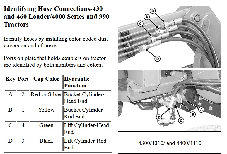

I have Hydro JD 4310 with a 430 loader and I am having issues with the hydraulics. I took the loader off because I was using the mid mount mower. The hydraulics to raise and lower the mower deck worked fine and still do, as does the 3-point hydraulics. When I went to hook the loader back up, the hydraulics weren't working. I would get very little movedment.
I disconnected all the lines and reconnected. When I tried it, everything worked but I had a line reversed and when I pushed forward on the control lever, the loader raised instead of lowered. And when I pull back, the loader lowere. The dump and curl are fine. If I try reversing the lines so my raise and lower are correct, l lose all the hydraulics for the loader again.

Not had this problem so not sure but here is the loader hose connections.
/ JD 4310 issue with loader hydraulics #3
I have recently bought brand new color coded endcap protectors. I need to install them. They help me keep the correct hose where it belongs.
Hope the above info helps you figure out what's going wrong.
Thanks. The above diagram is very helpful. Two of my hoses still have the color code caps but I need to get new color coded caps for the other hoses.
I think I still have a problem though, because when I switch the hoses, I lose all of my loader hydraulic functions for the loader.

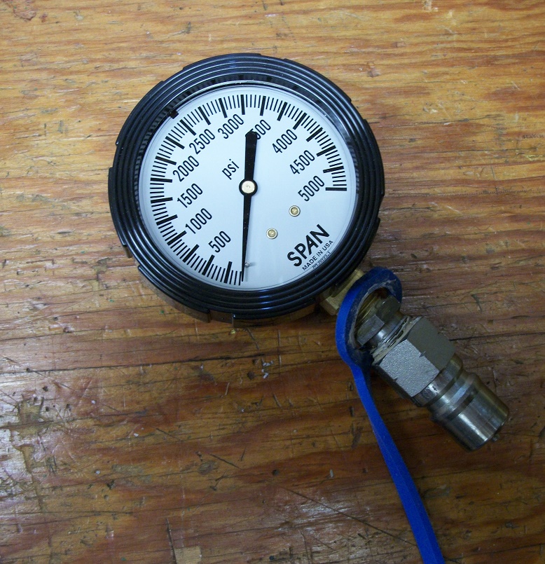

Just covering possible problem.. be sure the quick-connects are seated well in the coupling. Sometimes they look seated, but are not quite.. and little to no oil passes through.
A good tool to have to check the lines out is a pressure gauge that you can plug (connect) into one line at a time and check the pressure. That will identify any joy stick (valve) problem that may have popped up.
Looks like this...
