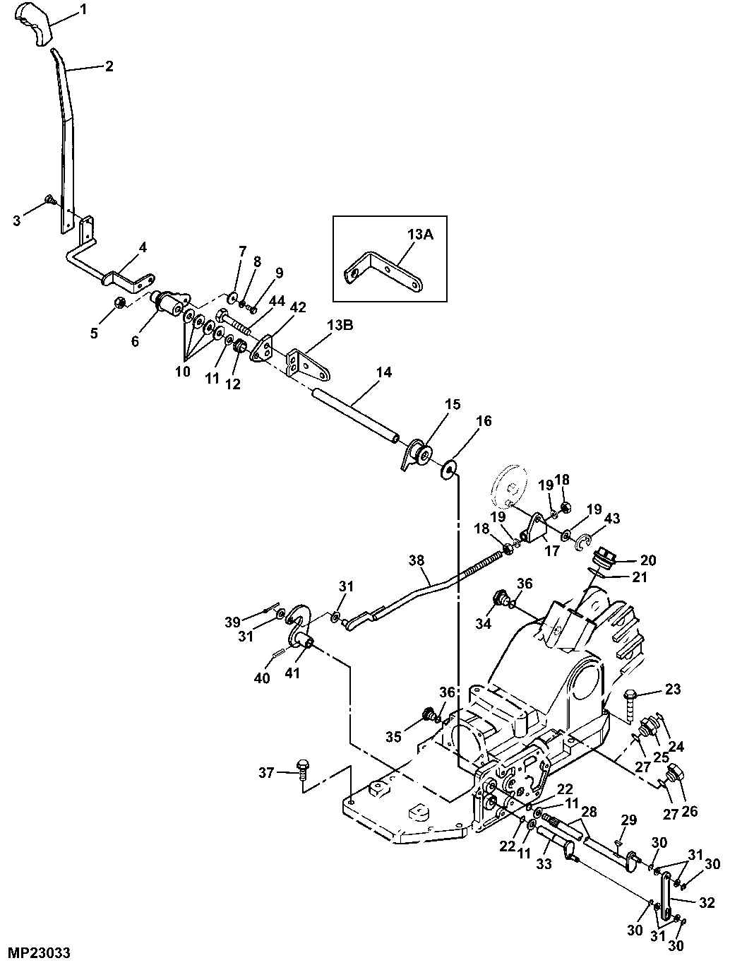

A second problem I am having is the 3PH will not maintain its level, but slowly lowers during use. even with the valve fully closed it will still lower. Also upon reaching it's full lift, the engine begins to work really hard until i raise the FEL or lower the 3PH. I recently cleaned the pressure relief valve which improved the power of my FEL. This seems to be when the engine laboring began, but my memory isn't clear on that. It also makes some buzzing squealing sounds sometimes.
I suggest you get the Technical manual for your machine. The CD's are excellent and cost about $75. There is a feedback rod (part # 38 in the picture below) that may need to be adjusted from the sound of your symptoms. If the 3PH is constantly trying to "position" itself, then it may be robbing flow from the system causing the loader to feel weak. What loader do you have-the 420 or 430?

Your 3PH might be out of adjustment such that a mechanical limit is reached before the position control cuts out. This would put you on the PRV all the time at max height and isn't good.

Do the adjustment procedure on the 3 ph as kennyd suggests, as well as jpinca. I had the same issue, and it is easy to fix.
