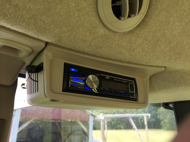

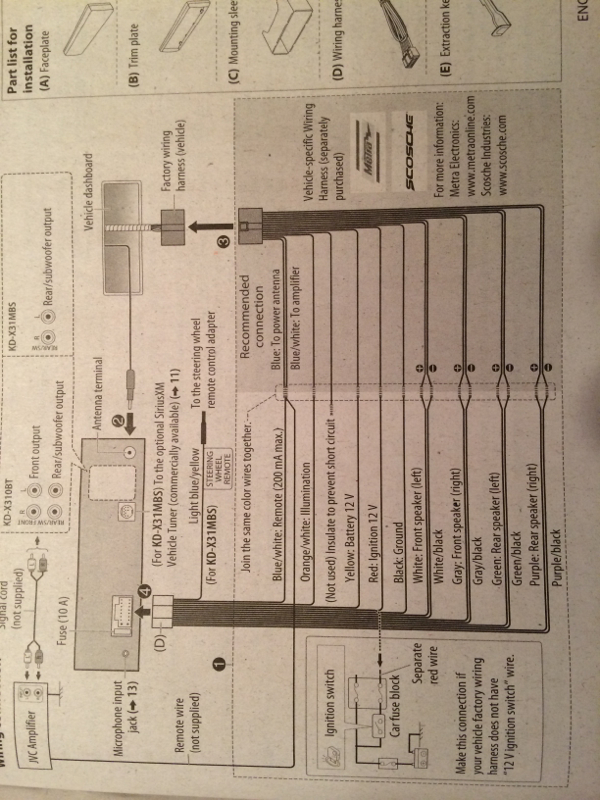

So I just finished doing the wiring of the harness and preliminary install of the stereo. This is the schematic from the stereo installation instructions.

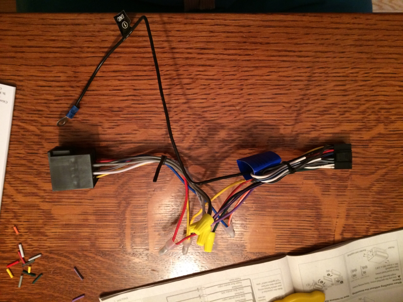

Referring to the schematic from pclausen, here is how I ended up with the adapter from metra. I ended up removing the wires not used. Could have left them I suppose but I wanted to keep it clean.

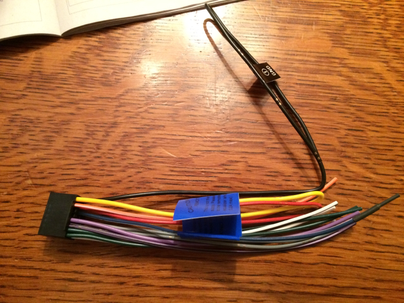

This is the adapter that came with the stereo.

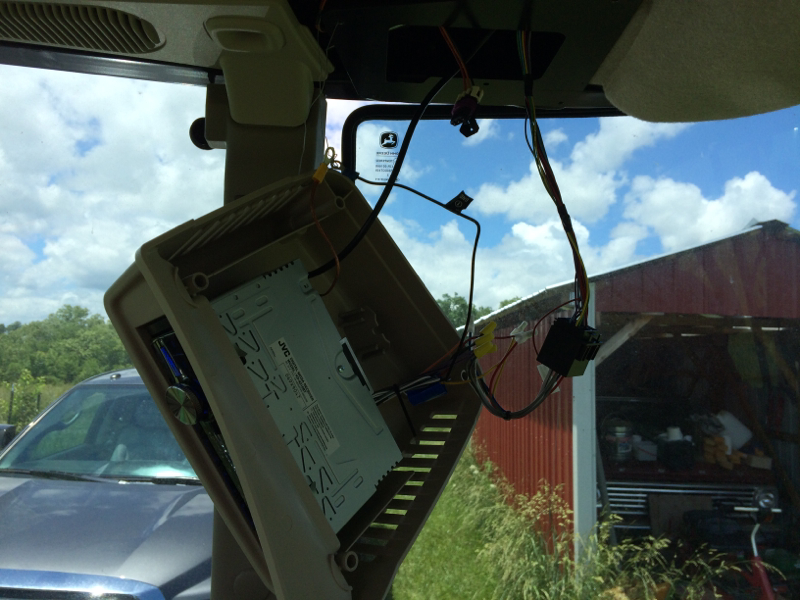

This is what I ended up with after connecting the 12v constant, 12v ignition, and illumination. I temporarily connected the speakers to the R/L rears. One if them is reversed polarity. I hope I can tell. I'll remove the wire nuts and replace with the crimped connectors in the field. I cable tied everything to make it neat and just folded over the front speaker wires and antenna power wire. I added a terminal to the ground.

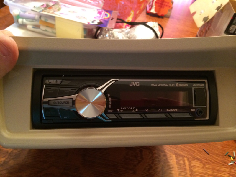

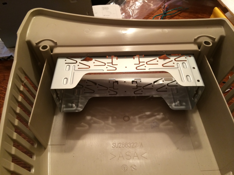

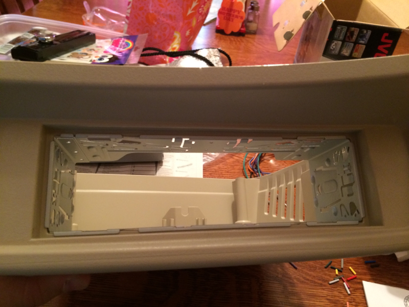

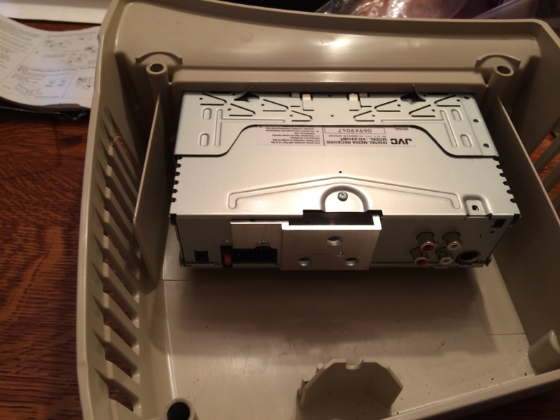

Finally I removed the blank from the holder and mounted the stereo. You'll notice its not very deep due to this unit being without cd. I haven't used a cd in years.
Finally, this unit comes with a wired microphone. I can feed it thorough the side vents on the trim piece, so that will be installed in the field.
I have to run to work for a bit so I'll finish the install after lunch.

After testing, I think the left was reversed. Now to button everything up.

Sweet. I'm very pleased with my initial impression. Wouldn't you know the first thing that came on was the cards giants game getting ready to start. I guess I don't have any reason to put off bush hogging now.
I ended up just putting the blue tooth microphone on the side of the console.

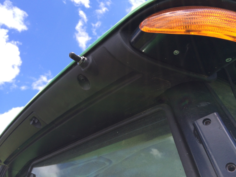

Interestingly the fm works great. I assumed this post sticking out of the front right if the cab was an antenna mount. Is it not? Does the cab have an internal antenna?
Thanks to everyone for their help. I'll post further impressions after I use it for a while.

From the size of the nut, it looks like an antenna, :confused:
break it off and see if you still have FM.:p

From the size of the nut, it looks like an antenna, :confused: break it off and see if you still have FM.:p
Would you please include pictures demonstrating the procedure you're suggesting? I'd hate to mess it up.... ; )
