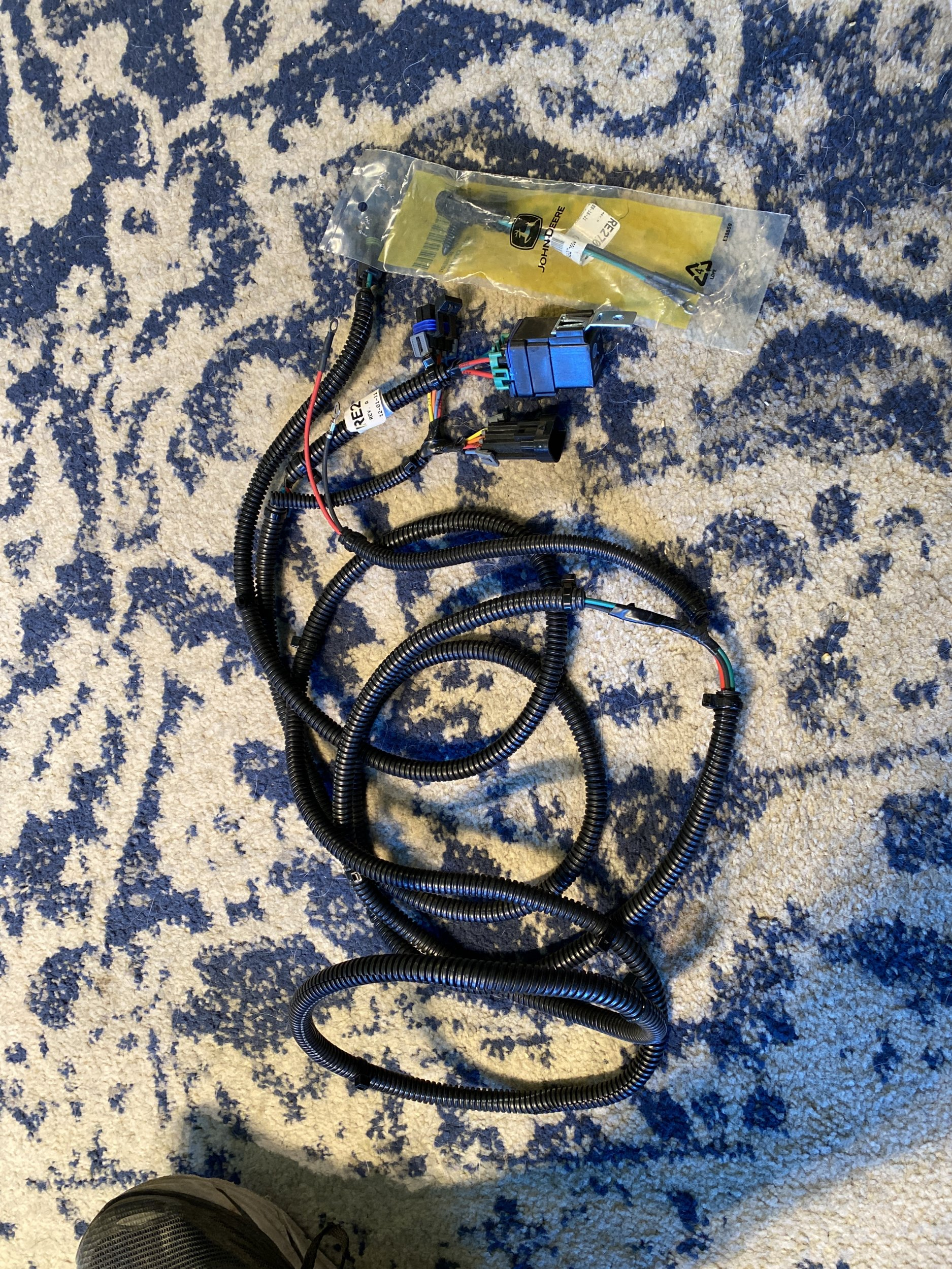

Here is a photo of the parts. Note some were not on the bulletin parts list, but we ordered them to be pro-active.
Parts List Key:
1. Quick connector
2. Fuel pump
3. Fuel pump clamp
4. Fuel pump mounting plate
5. Small wiring harness
6. Large wiring harness
7. Elbow
8. Barb fitting
9. Barb fitting nut
10. Fuel/water separator*
11. Check valve*
12. Strainer*
13. Bolt
14. Nut
15. Nut, plastic-fits pump electrical terminal
16. Nut- fits pump electrical terminal
17. Tee fitting for fuel return line
18. Quick connector
19. Hose clamps (not shown)
20. O-rings (not shown) for each end of elbow #7
*Not included in tech bulletin parts list
**We also bought new 3/8 bulk fuel line for supply & 1/2" fuel line for return. These are not shown here.
***The elbow (#7 in photo) was filled as part # 38H5015. The bulletin calls for part # 61M5015 which includes the o-ring that goes between the elbow and the barb fitting.
The parts list includes two wiring harnesses. A large harness and a small harness. The small harness connects between the large harness and the fuel pump. The large harness is the confusing one.

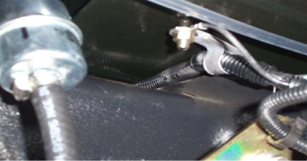

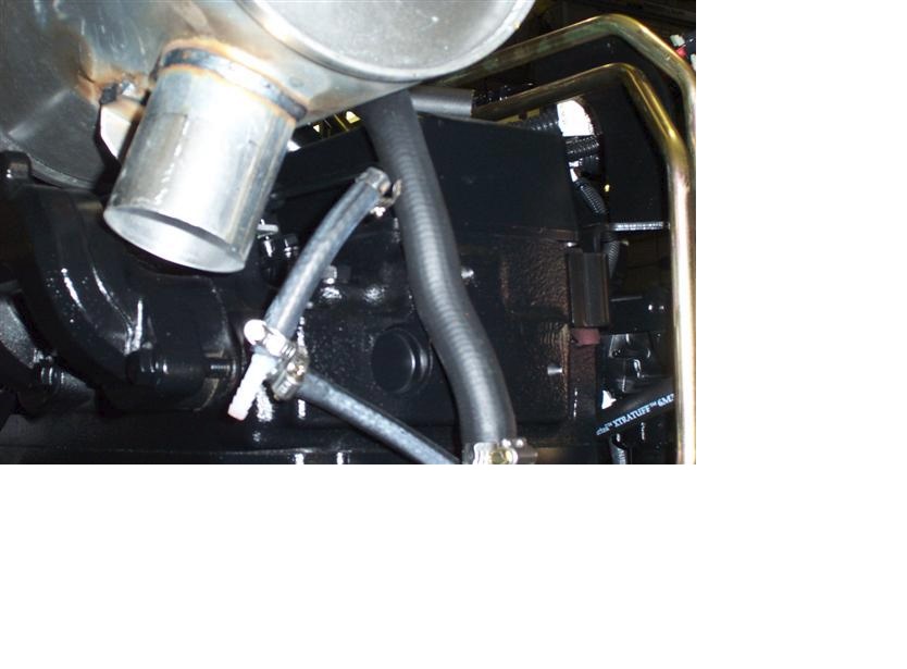

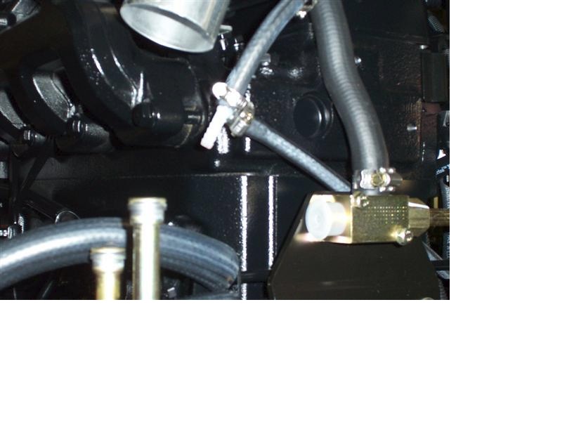

In photo 54399f you can see the upper half of the new fuel pump in the bottom center, Notice the wiring harness with two leads attaching to the pump. This is the small wiring harness called for in the tech bulletin.
Here are my questions:
-How do I access the PTO switch to connect the pump wiring harness to the cab harness (we have a manual PTO)?
-Where is the "accessory junction block" where the red and black leads are supposed to connect?
The instructions say to "run the harness branch with the relay and the 'tee' connectors across the back of the cab and under the cover with the controller."
-What "cover" and which "controller" do I run the harness under?
Further, the instructions say to "remove the RE206064 jumper plug from the main harness and place the 'tee' in between."
-Where do I find this "jumper plug"?
In the last paragraph of the instructions, it reads,
-Does this negate the previous instructions to connect the fuel pump harness between the PTO switch and the cab harness?
-Do I want to splice in to the PTO harness and risk messing that up?
-If I splice into it, where do I find it and which wires do I splice into?
-Which eyelet do I change? and on which harness? The fuel pump harness or the cab harness?
-Is it necessary to have this big harness with a relay and a tee connection to run a single 12 volt fuel pump?
-If I do use the new fuel pump harness, Where does the relay mount?
-Couldn't I just run a power wire from the pump directly to 12v switched power, and a ground from the pump to suitable ground? This would eliminate all the above questions.
I know this is a lot, but any help, especially from someone who has done this install or has experience with wiring these things would be greatly appreciated.
Thanks in advance for any help.
