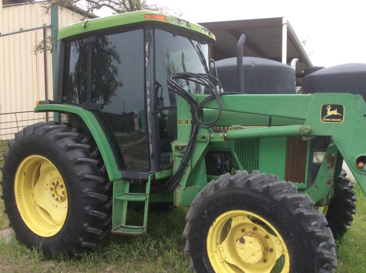

Talked to JD SERVICE MANAGER and he said the problem seems to be more temperature related since issue only occurs after working hard for over 1.5 hours. However the high Temperature light is not showing on dash??????
   / JD 6400 stops and starts pulling after it gets hot #12
The hour long time is what we've been talking about. The oil is maybe going through a small orifice like a partially opened valve, or your charge pump is worn out or there is a crack in the pumps line.
#13
JD has found a hair line crack in the clutch drum which expands with heat and allows oil to bypass causing a loss of pressure. $5600 to repair😳

This is an old thread but we are having something similiar happening on our 1993 6400 John Deere. Will work fine for a few hours about 2 then I get lights and tells me to stop. It is the hydraulic overheating light. We changed the filters and all new oil and still doing it.
   / JD 6400 stops and starts pulling after it gets hot #18
What type of transmission do you have? What are you doing with the tractor before the overheat light comes on.
Do you have a loader, power steering?
Often, over heating hydraulic oil results from the oil being forced through a relief valve while trying to protect the system.
The 3 pt hitch is a common culprit. The 3 pt hitch incorporates a feedback rod which tells the internal valve for the 3 pt that the arms have reached the top and to stop sending more oil into a full cylinder.
If you have a feedback rod, it is fastened to the upper lift arm and goes forward to the control valve area of the transmission.

I have the quad shift 4 x 4.
Yes has a loader and power steering.
It has done it to us doing different things once when working roads with the blade and another 2 time plowing with the disc harrow.
I will have to do some research on the feedback rod.
