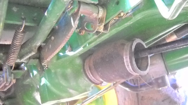

Hi guys, what is the procedure for removing and replacing the front drive shaft on a 790? I can see that the bolt on the front spline has to be removed but what is under the rubber boot with the two hose clamps? I assume that there is another spline but will I lose fluid and are there any "gotchas" in this process?
Thanks, Robert.

Now I am beginning to think that something is missing. I will try to post pics.

Sure looks like the tube that covers the drive shaft is missing...probably got dented up when the shaft was bent.
/ JD 790 drive shaft #10
Robert
Yep... your pics tell a story that the previous owner likely had a front end collision (high centered, etc.) on something that damaged the front steering tie rod and the front driveline.
That front shroud (cover) on the driveshaft is pretty important! It's always turning, turning. So, anything you drive through is very prone to getting wound up on the shaft. Tall grass, weeds. Wire! Everything... and something's could be a real problem!

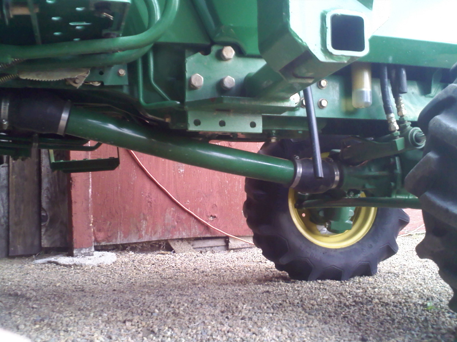

Robert,
Here is a picture of the drive shaft on my JD770. Should be similiar to what your JD790 should look like. I would recommend that you not use your 4WD until that shaft is fixed or replaced and a new cover installed.

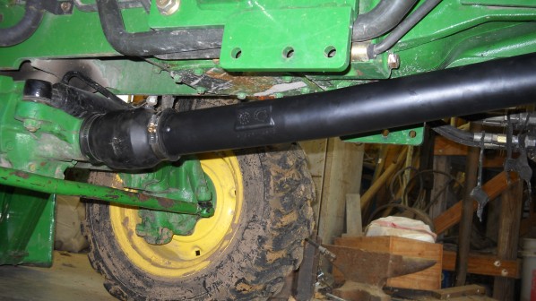

OK Guys. Thanks for all of your help. I now have the front end/driveshaft problems fixed. See pic. Ran me about $320.00 for parts. If I knew then what I know now I could have saved about $60.00 by making the tube shield out of 2" electrical PVC. Oh well...live and learn. Thanks again for all your help.
