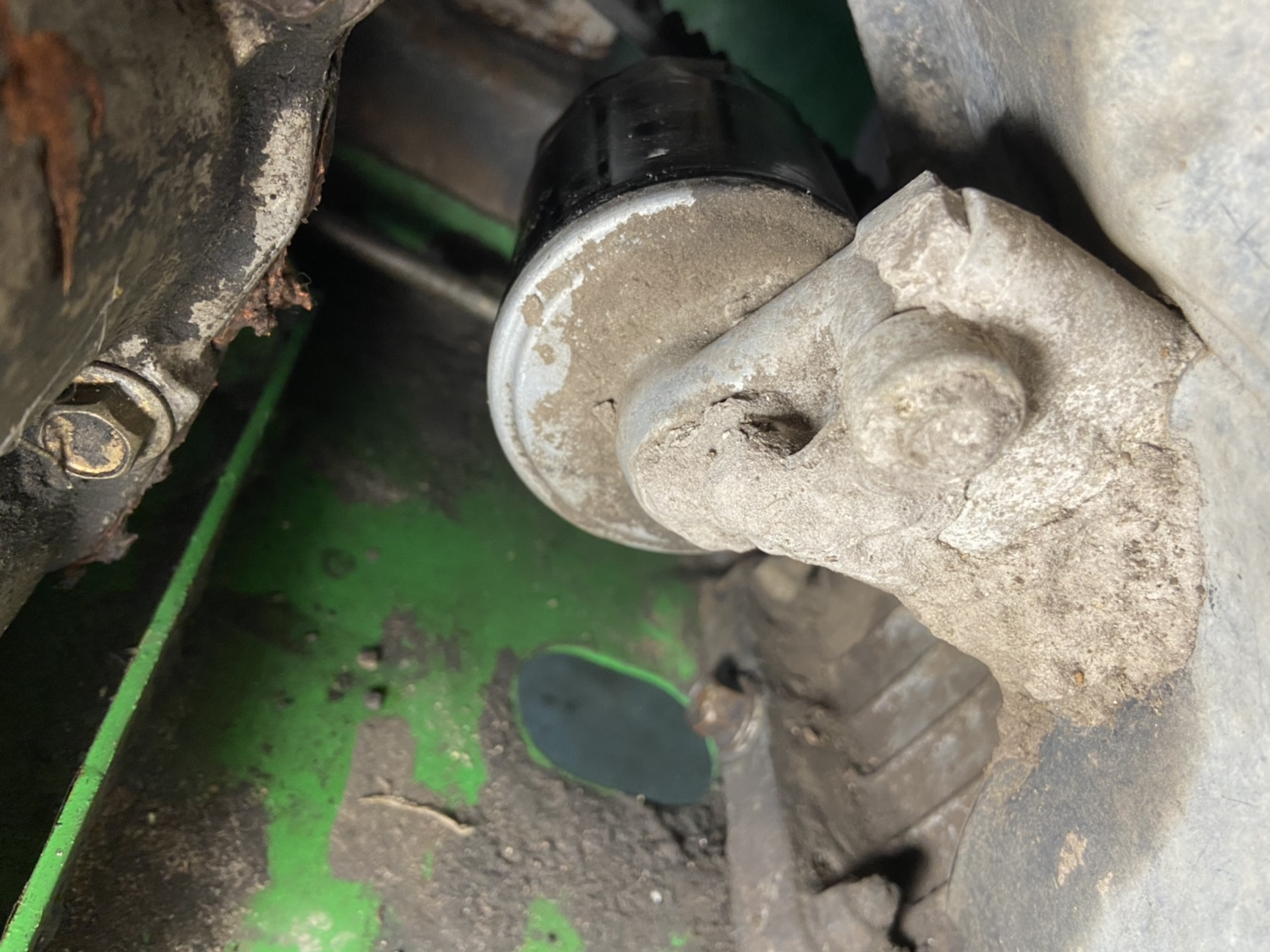

For the add on, they make it sound so simple. Take plate off. Put on. My guess is it’s going to be a booger. I could barely get my phone down in there to take a pic. Not that tight of an area, just doesn’t look easy. Unless your good with mirrors.

it's not really that hard, really get it clean down in there before doing it, and do use a bit of "white Lube" to stick the O-ring in place on the filter place while reaching down in there.

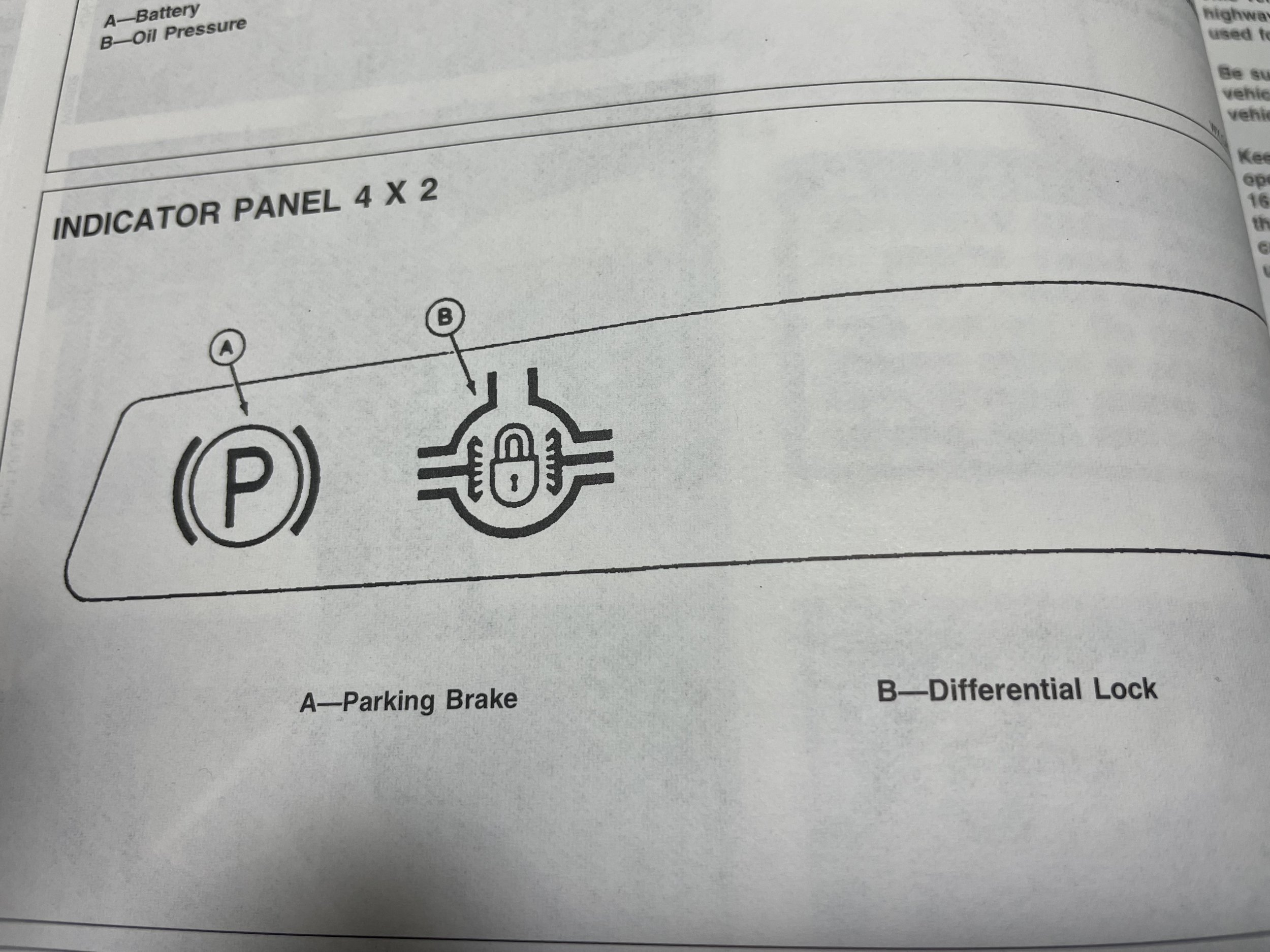

as for your dash lights, on the 4X2 there is only the Red parking brake and the green Differential lock light

Thanks. I’m just glad it’s already there. :).
Appreciate you looking it up. An what lights go in the dash. There is currently only the parking lamp. So now I know what the other hole is for.
