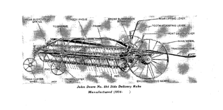

beenthere is correct JD didn't manufacture a rake with model # 549 but did manufacture a rake with model 594. JD parts catalog # for a model 594 rake is PC238.

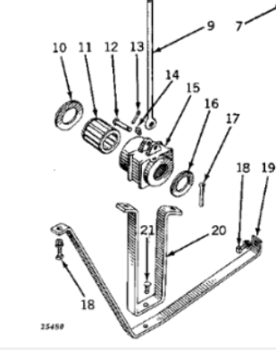

Hi
Thanks for the response's, yes it probably is the #594 model (I must have wrote 549 after one too many trips to the shed where the Fireball storage locker is located). Yes it is part #11 in the JDparts manual link that 'beenthere' shows, however it does not give the actual part # that I would need to order another one. I've contacted several bearing supply companies on-line and they do not have a match for the dimensions of this cylindrical roller bearing without a inner or outer race unlike most shaft bearings .
See attached pic (width/ 'C' = 2-3/4", I.D/ 'A' = 1-5/8", O.D/ 'B' = 2-1/2")

/ JD hay rake #594 #8
mp7959
I replied to a similar post on another discussion forum & stated the brg part # AL66E is available from ""Parts Dept"" but to get parts from them one must utilize a participating equipment dealer. IIRC Parts Dept had 4 AL66E brgs.

Try to edit the subject line of your thread to reflect the correct model number.. think you can within a certain time limit. Will help the TBN archives for future members.
Also, inspect the parts that go through the bearing and that contain the bearing to see if a machinist could bore and machine those parts to fit one or two new bearings.
If in question, post pics of the two parts involved.
