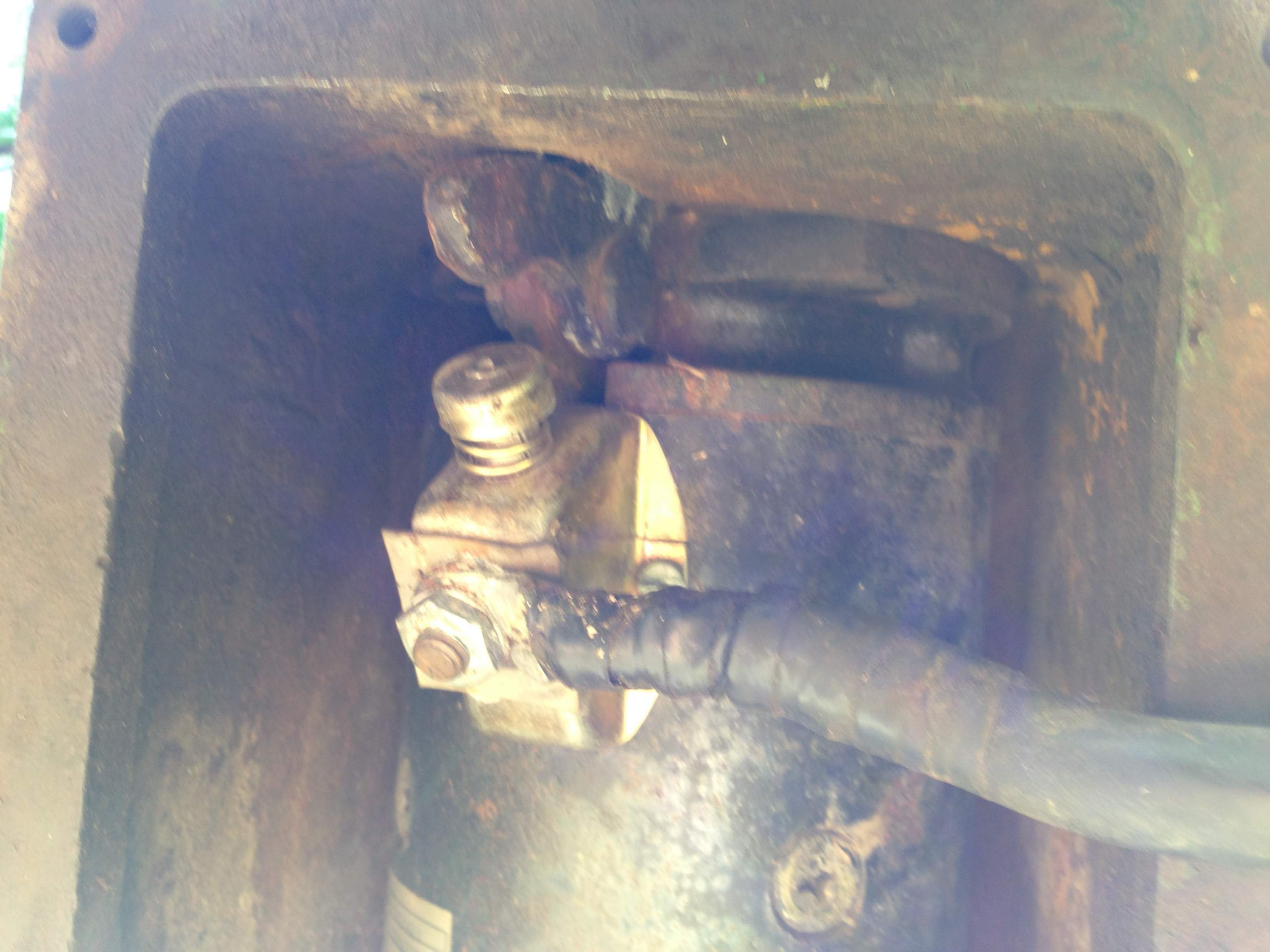

Now the first problem we need to address: we got it started, but it's not safe or right. The starter was replaced sometime...hard to say when, because my BIL passed away some time ago and he would have been the one who did it. We don't have a manual, (will order one shortly), so I don't really know what the parts are all called, but perhaps if I describe the problem, someone can chime in with what we need to do.
When you stomp on the stomp peg (?) nothing happens. Nada. Only by lying under the tractor (that's the not-safe part) and manually pushing on the starter switch with a screwdriver will it turn over - the part that is supposed to compress that switch when you step on the starter peg is too short to close the gap. Why? Is the replacement switch too short, or did something happen to the part that is connected to the stomp peg to shorten/bend it to it's current ineffective length? How can we fix that?
Pictured is the switch area, with the gap. Also a few pics of the tractor before and after the loader.

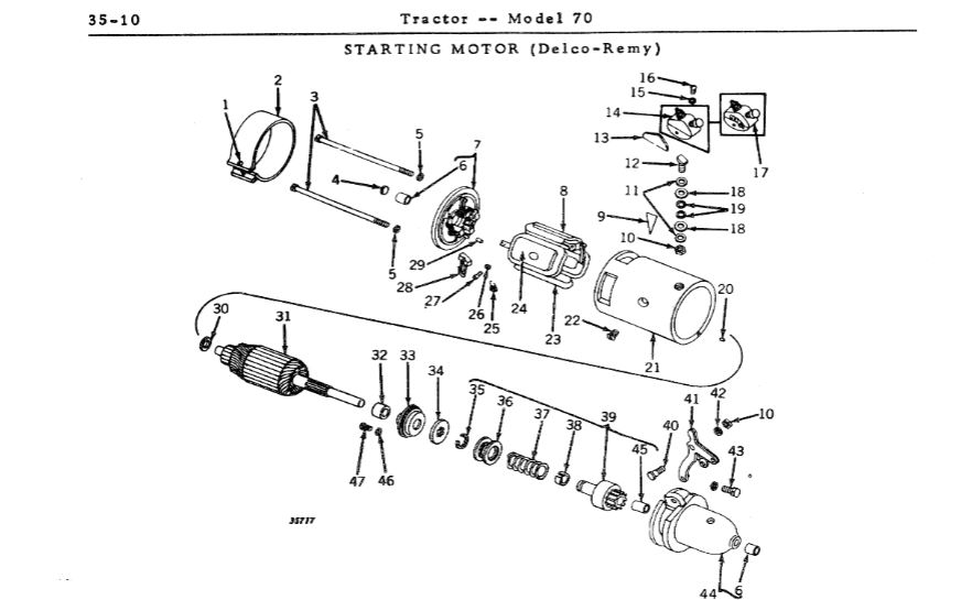

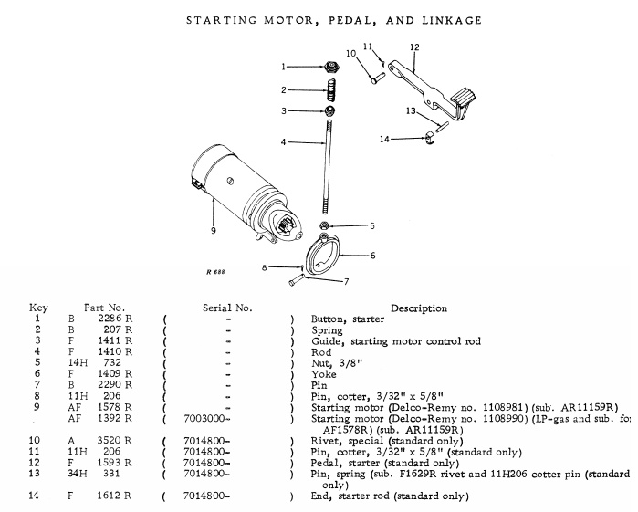

You can go to jdparts.com and put in the model 70 and get all the schematics for parts. The linkage to the starter and the start pedal (I like that name "stomp peg" :) ) will show up as follows. And maybe the cover over the flywheel will come off easily (a few cap screws IIRC) and hopefully just the nut on the end of the lift rod has come off. Should be able to see what is wrong with that cover off.

I suggest check for wear on shift lever(parts key 41) or wear on lug(parts key 12) or wear on lug(stud) inside starting switch
So if I'm reading the diagram correctly, part 41 is the part I have pictured in the close-up, yes? And that can either have shifted in position due to wear on part itself, or or 12 that holds 41 in place? The starter switch itself is new, I think, and that seems to be what my BIL started with when working on the problem. But for the price of that switch, maybe I should just get a new one of those as well?
