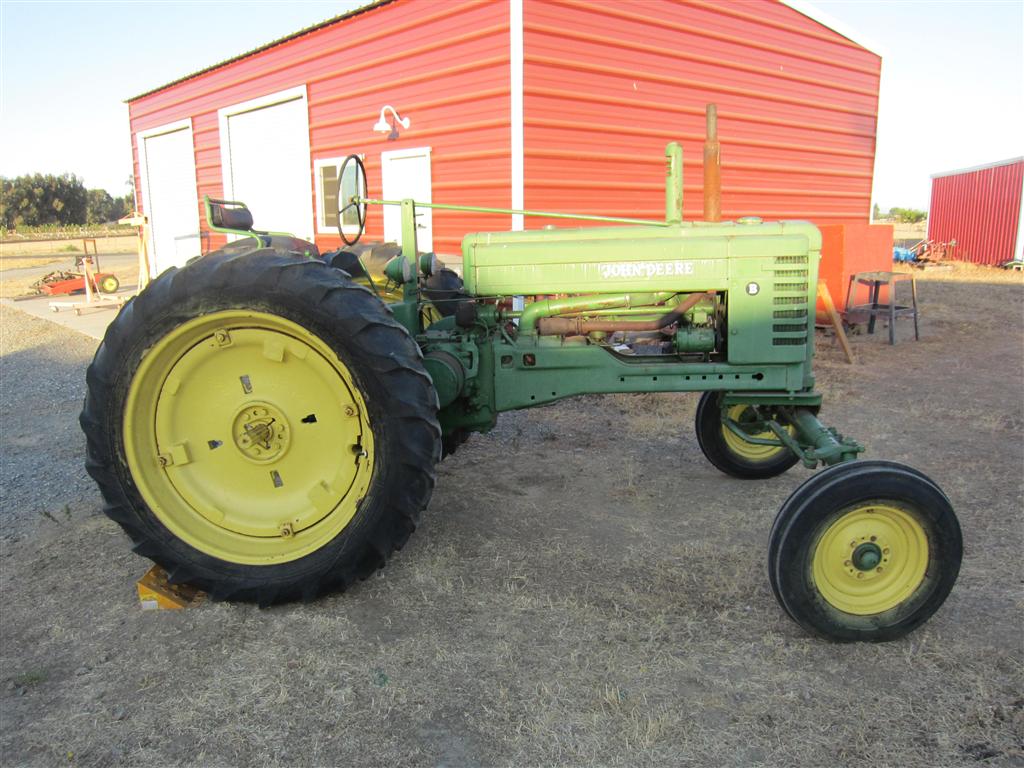

That's a nice big old 70. I have it's little brother--a 1949 JD B wide front.
Have fun. Be careful out there--that 70 is a beast.

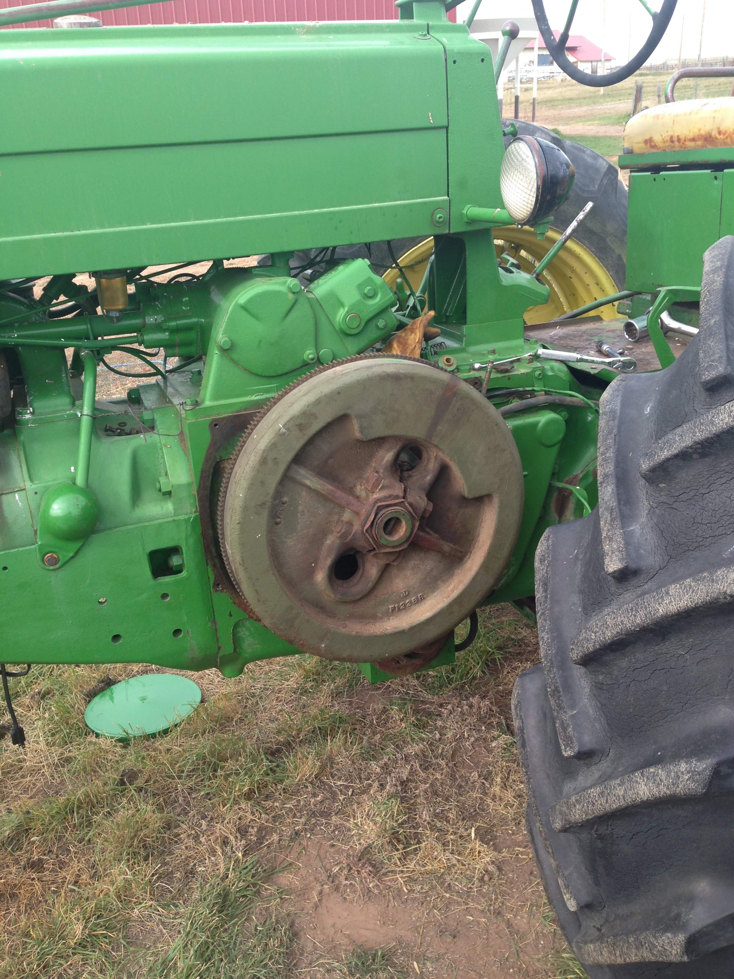

Clutch dust cover fit with some persuasion. Glad to have the manuals to look at.

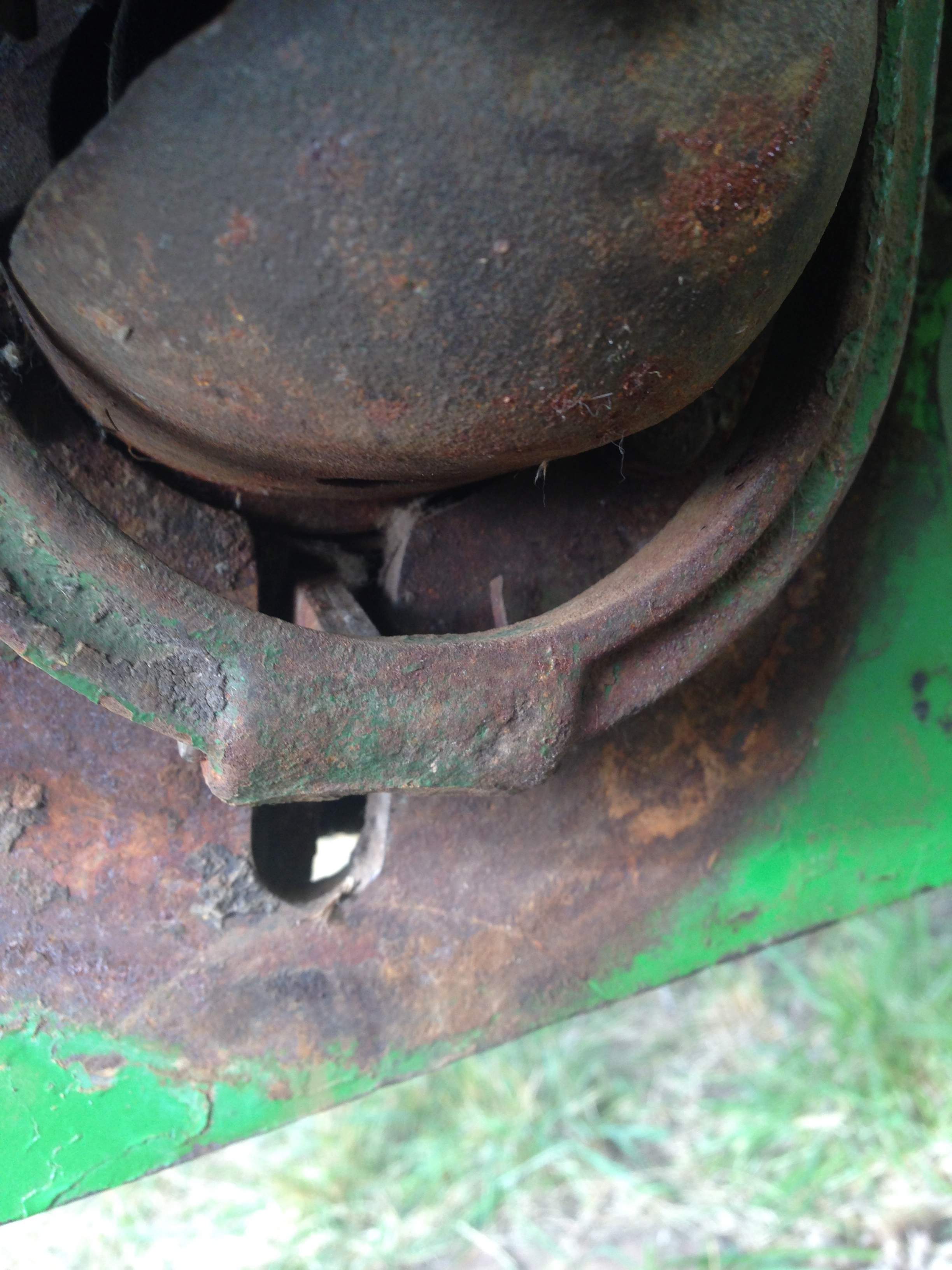

Took the flywheel cover off and found a couple dead mice and a bunch of gunk packed in around the bottom of the connecting rod, so I cleaned that out, took the pin out of the yoke/shift lever connection and cleaned that off, took the switch off the the motor (motor had been replaced in 93, according to the sticker on it) and cleaned up the corrosion, put it all back together. Quite a bit of play in the yoke and again in the operating rod, but cleaning that gunk and mouse nest out must have been enough, because the starter works correctly now, and with only one person! The hardest part was screwing that starter button (formerly know as the stomp peg..) back on - that spring kept interfering. :)
And now I see where the expression, "the tractor leapt into action" came from... holy cow, putting it in third while I was mowing...my front wheels leave the ground every time. Kind of exciting.

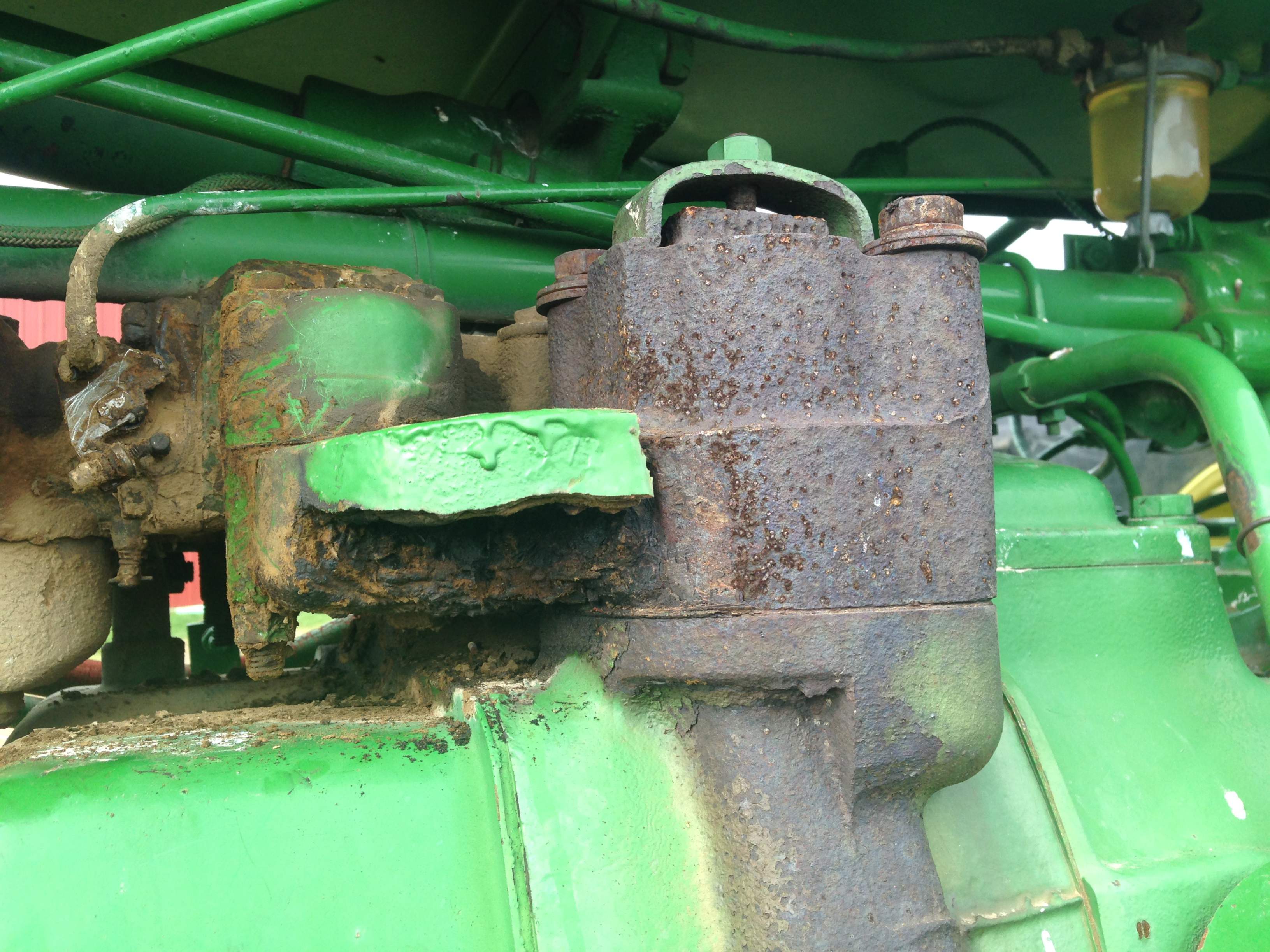

There is one major place I'm concerned about on the tractor, shown in the first picture. Looks like it was glued together with some JD green paint some time ago...Thoughts on what to do here. Looks like major part replacement to me?

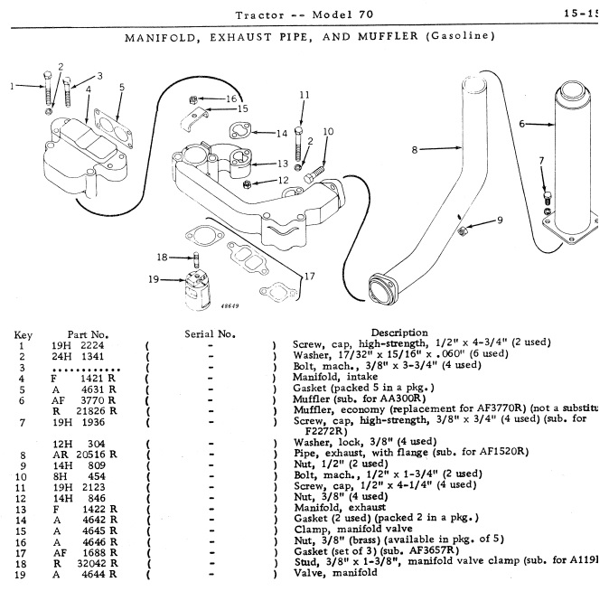

Assume it is the far right picture of the intake and exhaust manifold that you are concerned about. Does look like some heavy green paint added there, and have to wonder what the corrosion is below it. If it isn't leaking, then hold your breath and hope it holds together. Hope it isn't "glued". ;) See the manifolds on eBay now for under $300 for the 70 gas
Attached shows parts of the manifolds.
