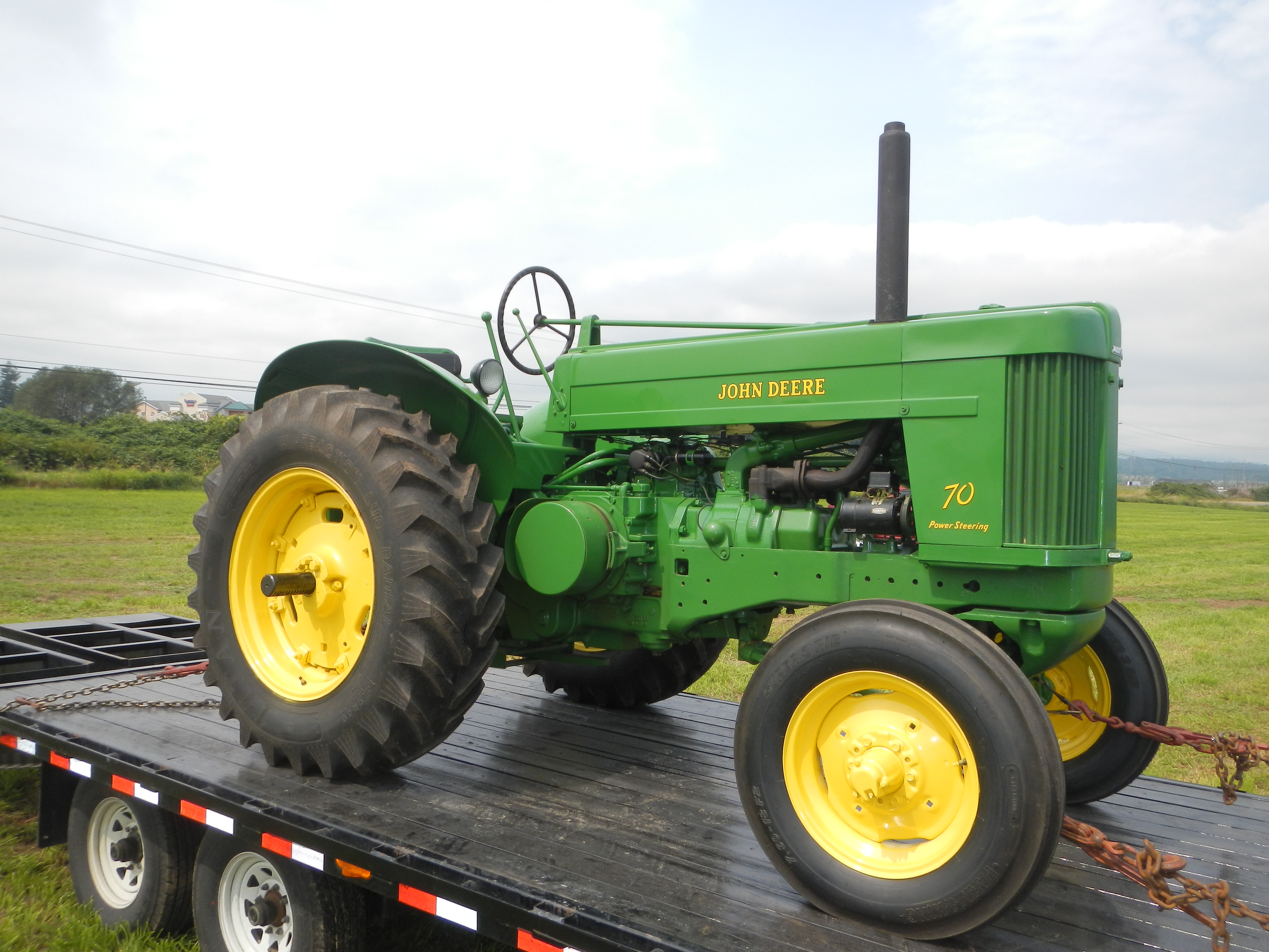

I have a gas 70 with an 8' blade on it. Works great for pushing snow with a very fast reverse gear on them! A friend built a custom carriage for the dozer from the blade back that would be strong enough to last under a 5020! He definitely believed in the old adage "Leave no doubt, build it stout!" Of all the tractors I own I like the looks of the 70 best. Here's a web pic of one; mine isn't as pretty..yet!
Great looking 70.

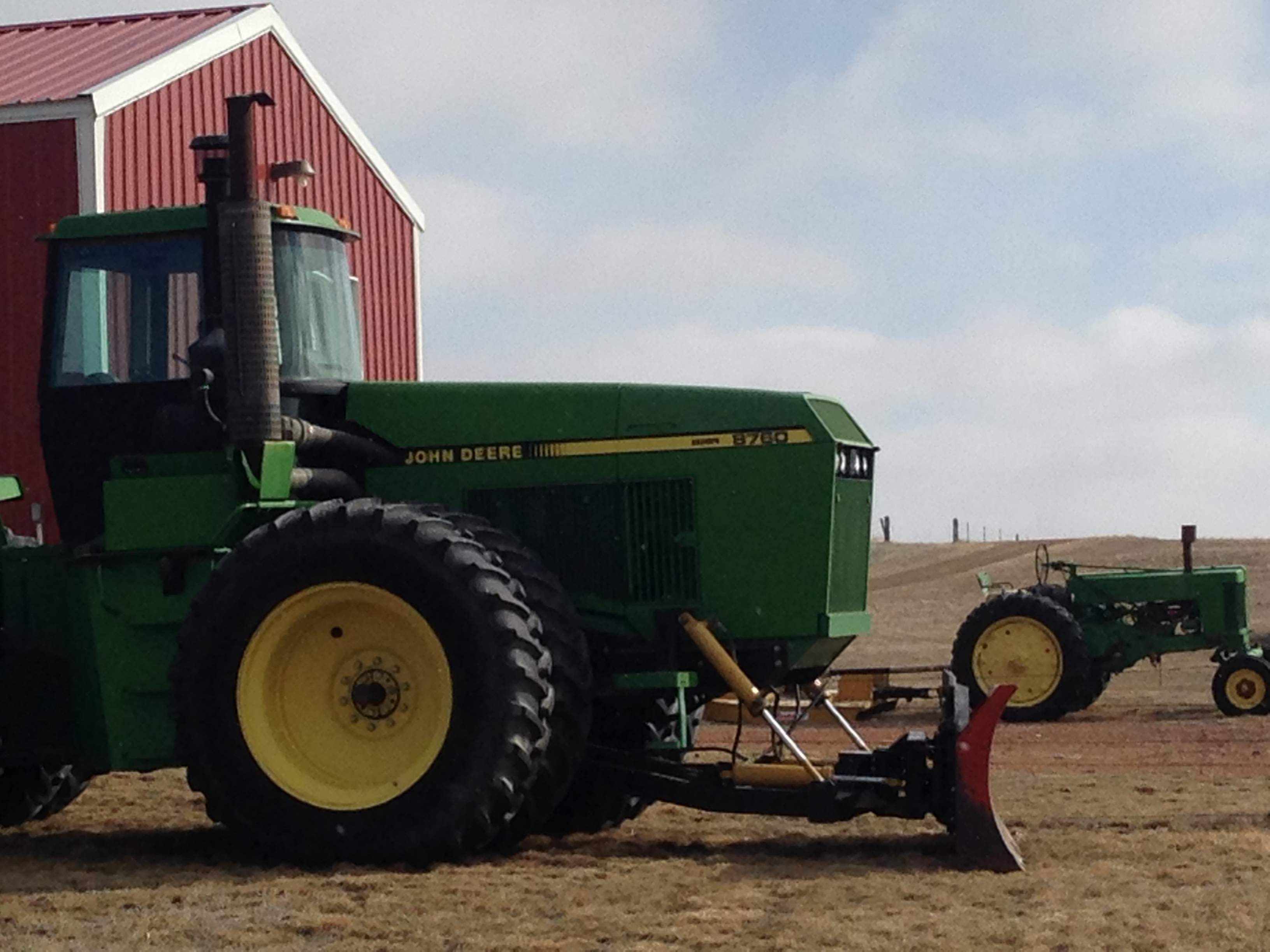

Greetings from Thelma and Louise -
Winter was relatively light in terms of snow at Thelma's place, thankfully, as Thelma has enough to do keeping the place going, getting rid of excess "stuff", figuring out what's next, and keeping the livestock fed. Louise spent the winter elsewhere, doing elsewhere things, but we girls are back together this week, working livestock, pondering tractors, etc...
Louise is posting a big-n-little picture here, because while the 70 is the primary focus of this thread and the tractor we need to (fix and) use, Thelma has a couple of others she has to deal with, and one is an older 8760 and the assorted implements used with it. My BIL used it to farm (wheat), but since she's leasing the farming land now, selling the big boy will have to be dealt with. Ugh. More things we don't much about - selling tractors. Louise drove it last fall a little bit to get familiar with it (because, let's face it, it's awesome!), and Thelma got comfortable enough with it that she was prepared to use the dozer blade this winter to plow if necessary, which it wasn't.
Thelma signed up for a welding class, and since Louise was here she went too. Had a great instructor and he pretty much turned us loose in the welding booths to practice. Hope to use the knowledge from this class fixing things like livestock panels, fences, nothing too major or life-supporting. We'll fire up the 70 in April and hopefully pick up where we left off last fall - chugging along.
T&L
   / JD Model 70 resurrection #27
Good to hear from you . :thumbsup:
Talk about moving some snow!
