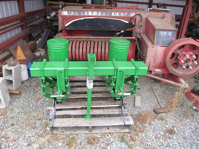

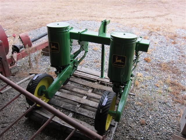

Any ideas what model this planter is? and if its a good planter?

They two rubber looking wheels in the front have me stumped???

Here's my JD-71 two-row Flexi-planter. It's a good planter.

I think thats the back ... I also believe its a 71 ... John Deere 2 rows are excellent planters.

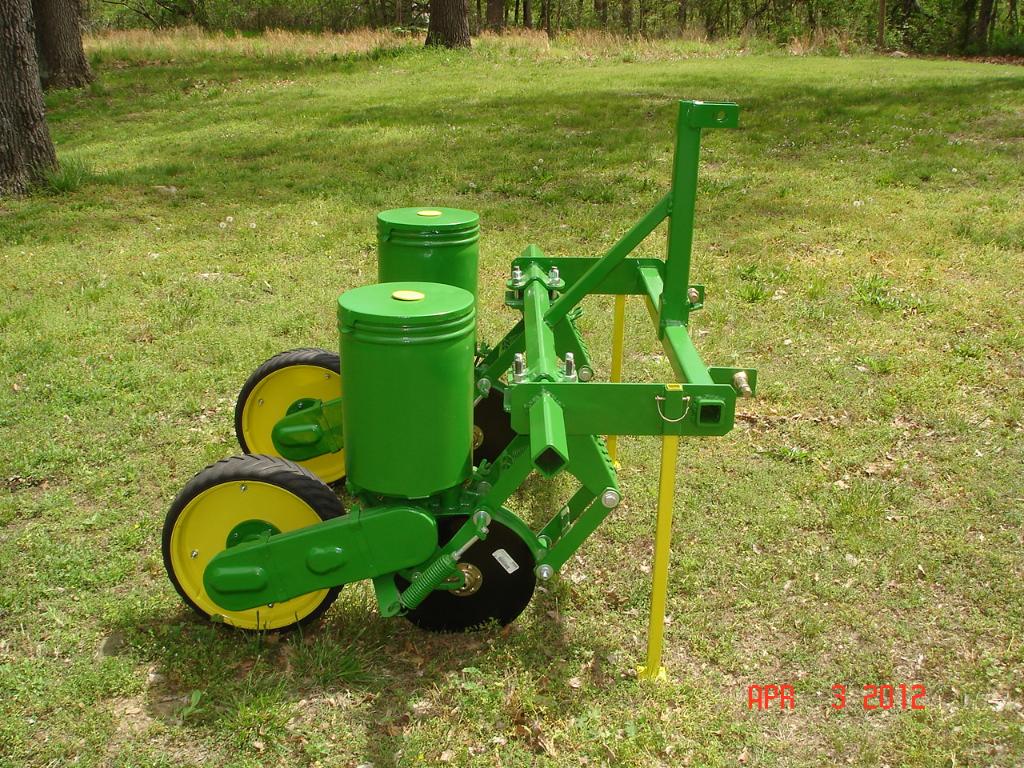

I don't believe it's a 71 or a 70 Flexi. If you look closely at the unit without a lid on the seed hopper, notice the flat steel frame attached to the press wheel. On a 71 or a 70 Flexi, the press wheel assembly is attached with a cast drive housing. The press wheel itself, looks different than a 70 or 71. I think the small wheels are gage wheels for the toolbar. If I was a bettin man, bet its got a shoe/runner opener. I THINK it looks like a 50 or 51 JD planter unit. It'd be easier to tell with a picture of the other side, and less weeds in the picture. The picture below is a 70 Flexi planter I refurbbed, that predates the 71 Flexi. Compare it to Flusher's 71, and note the similarities. If the price was right, I'd get em for the project value. Of course, I could be wrong. :D Mark

I was too quick ... I now see those front wheels ... oops!!
Thanks for pointing that out ... I was wrong ... Now I'm thinking a 51 BUT those front gauge wheels, (as Andy first saw)I quess they could have been added or was an option.
/ JD Planter? #8
51 JD planter . Decent planter. What is the question > or was that it ?

that was the question-thanks... It doesnt look like a 71 to me. Cant get in touch with the guy right now? so it may be sold..

I asked him about it last week, that was a good price. He didn't know much about it. I think it is a 51, If I was sure it was a 71 I would have bought it last Thursday.
