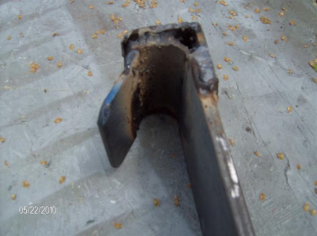

You can buy the "hooks" and "pins" from JDParts...The #'s are:
W47211 PIN,
W43359 HOOK, BUCKET
Or you can make your own with angle iron and CAT3 pins, see attached pictures.
