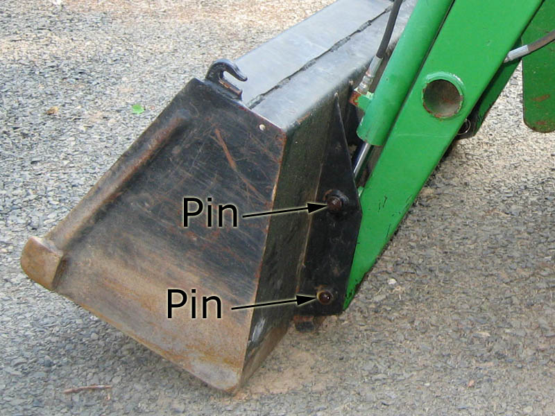

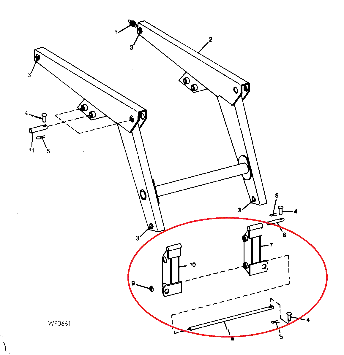

Not all 440 loaders had the JDQA, so does the front of your loader look like this:
If it does, then you do indeed have the JDQA (John Deere Quick Attach) system, you can get high quality JDQA forks from many companies like Artillian, Everything Attachments, Frontier, Horst, and quite a few others.
No, if your bucket is just pinned on as you say like this image, then you do NOT have the JDQA and you choices are severely limited and more costly.

Yes, I do have the two pins, no hook, connection like in the bottom photo. Well, at least that clears that up - and all this time I thought I had a QA.
So now I'm looking at possibly a modification to QA (JD or skid steer), or finding forks to match my present set up, or upgrading to a newer tractor. I don't think I'll be changing tractors because what I've got is perfect for my needs except for this problem. They must have made a pallet fork set to match my loader arms, but they're probably pretty rare. Anyone? Please keep your eyes open for them.

My 1997 440 loader has the quick connect links. I wonder if converting an old 440 loader without QA only requires a QA bucket or attachments, and the QA brackets and the 3 pins.
/ JD Quick Attach - Pallet Forks #10
Yes, one could convert, IF the parts are available. But welding would still be required since you'd have to add the hooks and pins to the current bucket.
This is where learning how to use JDParts: Unsigned Landing Page is invaluable, or having a patient and friendly parts guy at the dealer to help.
