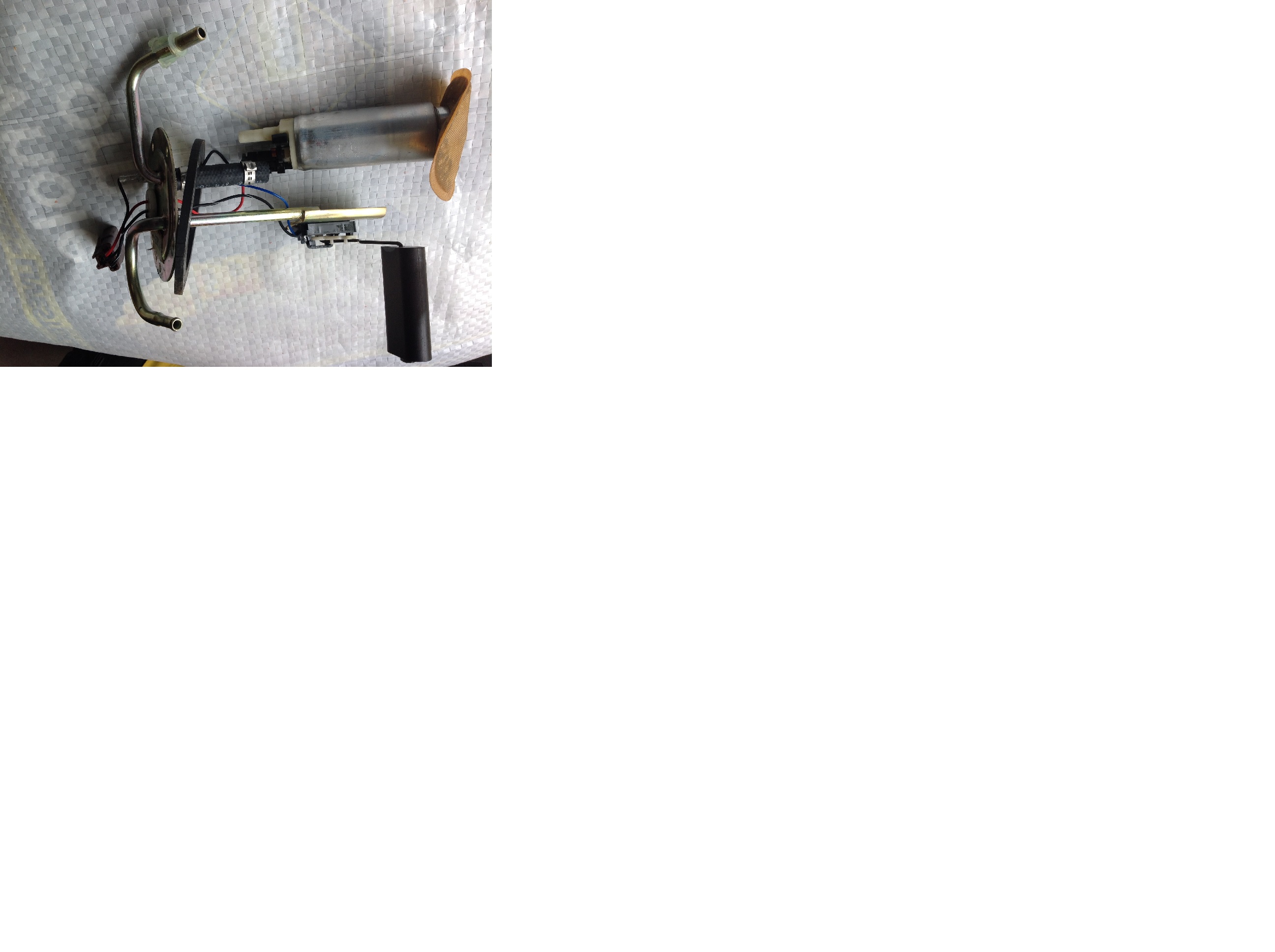

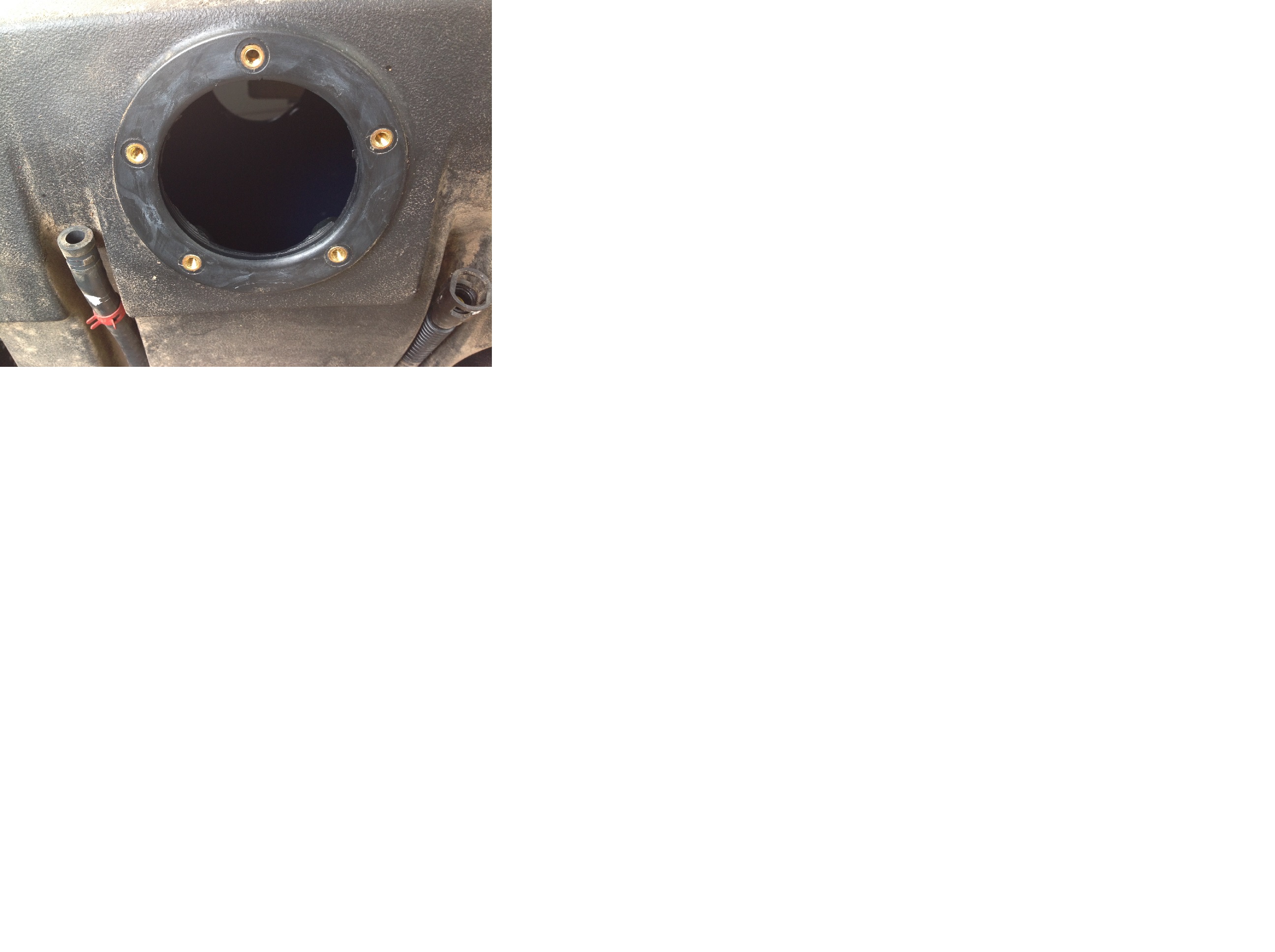

Monday came, and fuel pump still not transferred.. so waited until today. the 8 holes in the pump flange and gasket can be matched to the 5 holes/studs in the old tank. When pulling the old pump/gauge out, found that the hose was not connected.. but the pump didn't run.
Put new pump in the tank and hooked it up and it ran.. sounded like the old familiar pump sound with key on and engine started right off. Success.
Will post some pics of the old filter condition and the new pump in place.

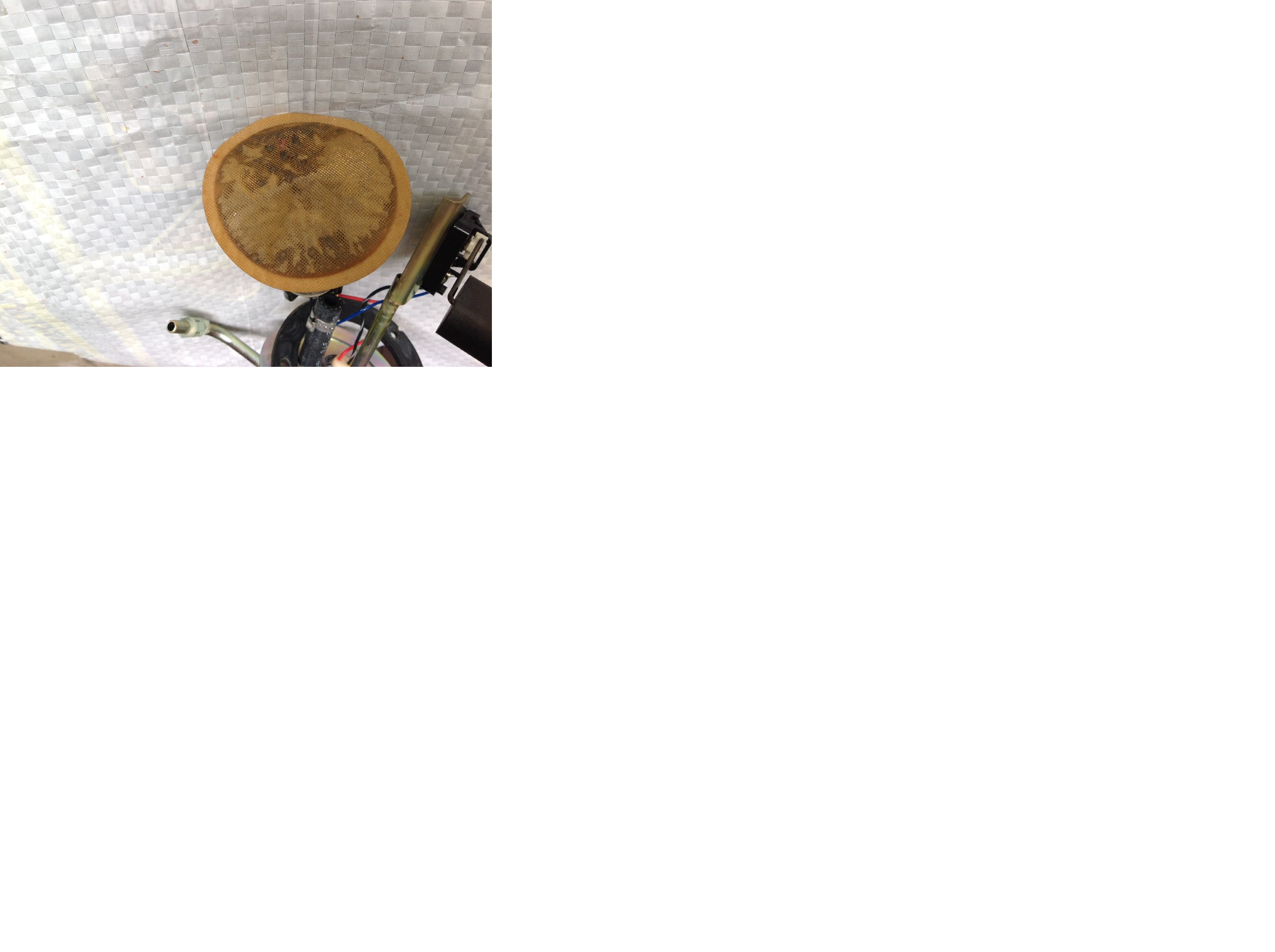

Pic 1..The old pump removed showing hose disconnected..
Pic 2. Fuel tank 5-bolt hole with brass inserts

OK great job. So was this the $300 pump? Do you get the cover, fuel gauge and pump as one unit?
Hope you remember to move that hose clamp were it belongs.
Richard
   / JD X485 fuel pump not running
#36
Thanks
The disconnected hose was within the fuel pump fuel gauge system.. came out with the old pump.
Yes, this was the $307 fuel pump.. replaces the old system..

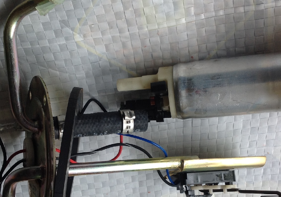

This pic shows the hose disconnected from the white hose barb, so the pump just hung off the two wires.. The clamp was just at the tip of the pump outlet..

I kinda thought the 5 & 8 hole fittings would be ok. I just couldn't remember since it was some time since I did one. (Actually did it twice for a customer who made his own bio-diesel which destroyed anything rubber it contacted.)
I wonder if the pump was dislodged upon withdrawing from the tank because the pump must have had contact with the hose to pump fuel for it's working life thus far?
For anybody reading 4 pages of electrics prior to getting this far - The purpose of the electrical testing & diagnostics was to avoid the possible need to remove the seat, seat base and platform to access the fuel pump unit, which would be the last resort.
Doing the simple and accessible things first, checking fuses, relays and connectors may well have found a problem which was simple to repair. That 'beenthere' had to go all the way to the fuel tank was unfortunate but never unexpected.
I still wonder about the '2-second' comment from another poster. I think this pump isn't pressure sensitive and just pumps continuously when the key is 'on'. It relies on fuel passing through to keep it cool.
Do you think that filter sock looks very clean or clogged? (Hold it up to a light).
For the fuel gauge issue - if you removed the new sender unit (and pump) you could move the float arm and monitor the instrument panel gauge to see if it is sticking?
Ohm's measurement across the sender unit with multimeter will also be a good test. (I hope you still have the seat platform off?)

About the hose coming off the pump, puzzles me too but lifted it out of the tank carefully but must have caught the pump on the lip of the tank and it was just barely hanging on by the tip with the misplaced hose clamp. Agree it wouldn't pump any pressure to the engine if hanging loose..
I'll look closer at the filter sock and report the findings.
