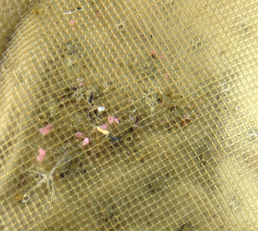

Took a pic of the filter sock under a light magnifier, and found very little debris.. looks like some fine fibers or threads.
   / JD X485 fuel pump not running #42
Thanks b.t. great photo.
Not as dirty or clogged as I expected. I've seen them blocked solid, especially on the diesels.
Pop it on the shelf for a spare.

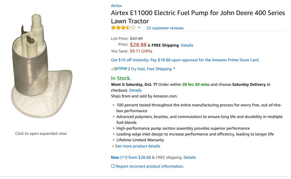

Beenthere,
Are you saying that the new pump/fuel level sensor is bad or the wrong type?
Here is a pump from Amazon for $29. Has mixed reviews on the page. Here is the link:
Amazon.com: Airtex E11 Electric Fuel Pump for John Deere 4 Series Lawn Tractor: Automotive
And a jpg of the page:
Richard
   / JD X485 fuel pump not running #46
He's saying the fuel level sender unit portion of the combined Fuel Pump & Level Sender combo assembly isn't working. His old sender still activated the gauge so we know the gauge is ok. The new pump part is ok.
He could combine them but shouldn't have to - The new combo is under warranty.

As Spanner posted, think I'll continue with the replacement and "hope" that this isn't a genuine mismatch of the electronics communication and the fuel level gauge.
If the pics of the Airtex was similar in wire connection and outlet length, then sending for it would be very tempting.. but it is only close. And I'm thinking it may not be for X485, as none of the specs line up (eBay has the same and may be the outfit supplying Amazon).
But appreciate your thought and input.
