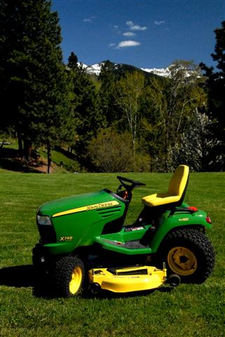

I did my first serious mowing today. Wow! Handling is great, and it hugs those hills. I did a similar search for a long time and could not find anything suitable, until the X729, X749 came along.
If you are used to the 445, you probably will not be satisfied except for an upgrade. If you can find a way to swing the funds, you won't go wrong with the X729.
I went with the X749 and haven't looked back...
