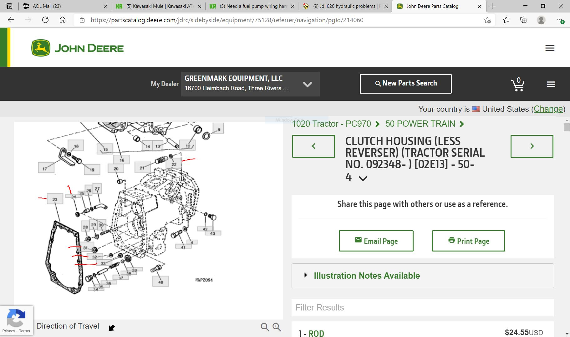

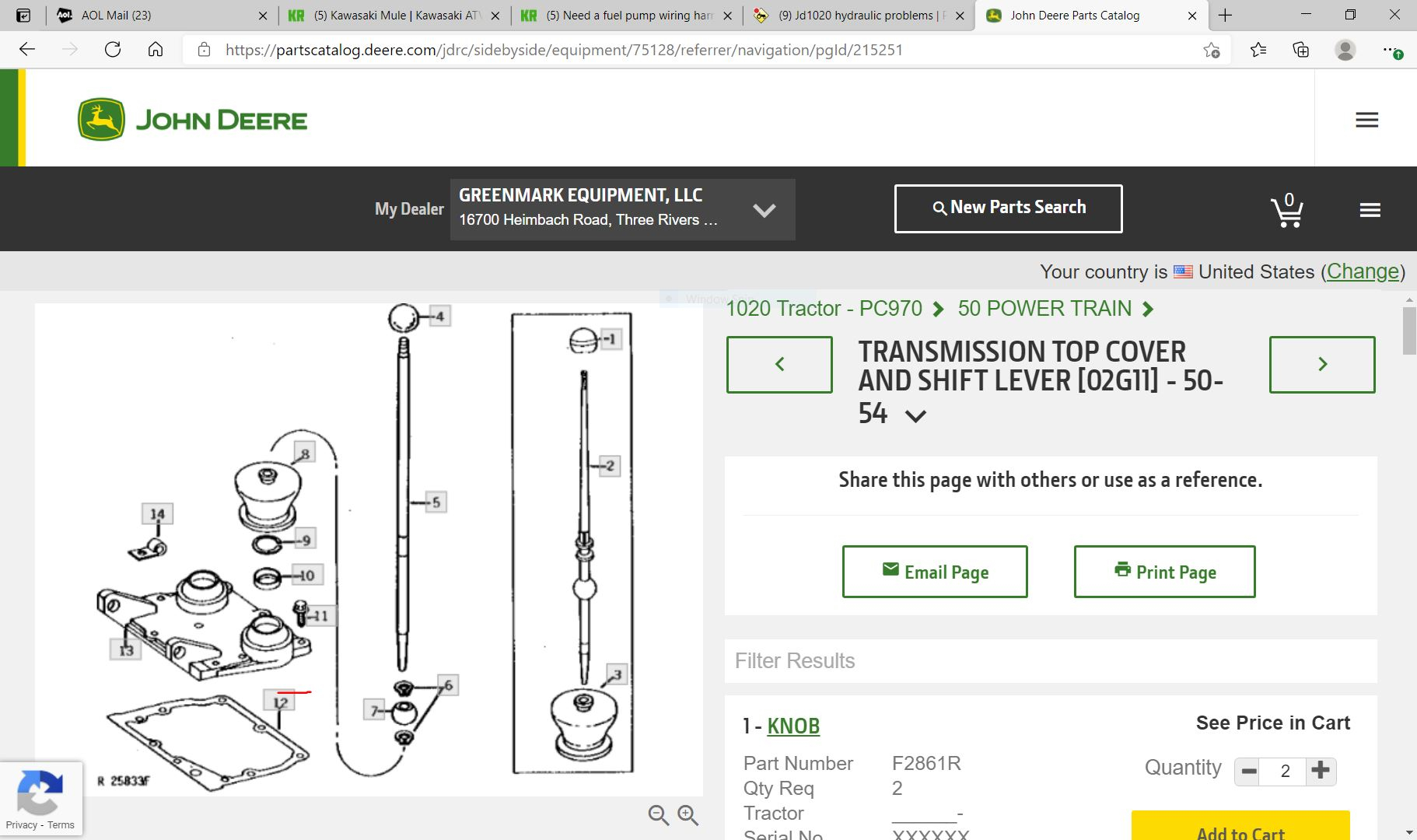

Does anyone have a parts number for packing or seals for the low pressure lines going to the housing on jd 1020

   / Jd1020 hydraulic problems #25
You may as well also buy the gasket, O-rings/packing for the clutch housing to transmission case split. Not knowing your serial number, I did not list P/Ns
