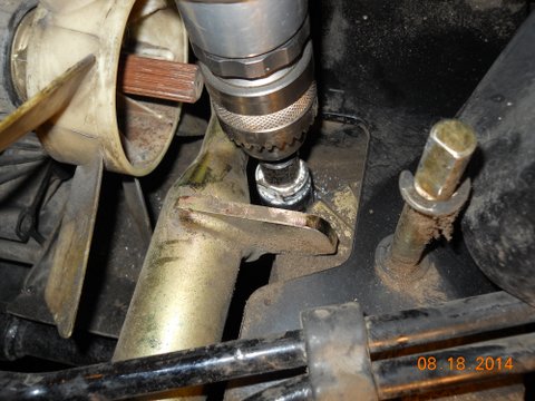

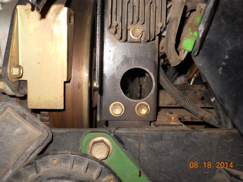

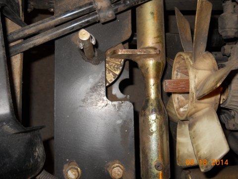

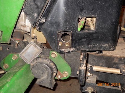

DSCN1369.jpgDSCN1366.jpgDSCN1365.jpg I too just finished installing new spiders in the u-joints on my 2210 main driveshaft. Took me & a friend about 6 hours to do the total job. Do not buy the spiders from John Deere, or Kabota. I went to NAPA Auto parts, and bought them for $26.49 Ea. NAPA number is PUJ 410. These spiders have the zerk on one of the bearing caps. This makes it much easier to grease them with a little bit of modification. I hope I can post some pictures on here. Never done it before. Wish me luck! LOL! I took a good 1" hole saw before I installed the driveshaft, and cut a portion of the steel off the plate right below the rear U-joint. Kinda half moon like. I will be able to grease the rear one from the bottom of the tractor. For the front U-Joint, I cut a 1-1/2" hole in the steel on the left side at the bottom where the voltage Reg. is mounted. Then I cut the square hole in the base plastic so I could just order another rubber plug like the one beside it. I'll have to make up an extention for my grease gun about 12" long to grease the front one. If you look on the left hand side of the tractor, just behind the engine, you will see the teeth on the flywheel. You can turn the engine to line up the grease zerks with a big screw driver, instead of using the starter. My tractor is a 2003 model, and I had 1100 hours on it. To remove my shaft. We removed the snap ring on the front U-Joint, then drove out the role pin. Then we pushed the shaft back toward the transmixer to remove the front U-joint, then pulled it forward off the transmixer. Then slid it back & out. I hope this helps some of you folks, and saves you a ton of money over paying JD their prices for something they screwed up.DSCN1362.jpg

Can you show exactly where you cut the hole? Also, would you cut it in the same place again?
