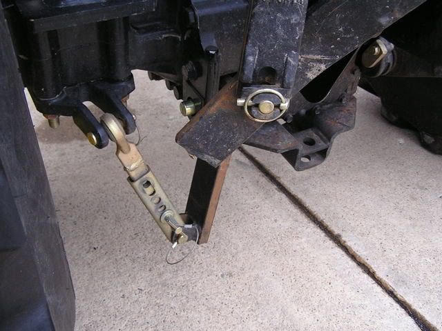

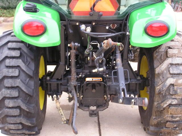

I had only looked at the frame on the Deere Parts Site. Today I looked at the tractor as I myself wasn't all that familiar with how the tractor frame was set up. It actually only goes from about the loader mount forward to the weight bracket. I really don't know how much work would be entailed to jack up the front of the tractor remove the front axle and then tear it down to remove the frame. I am assuming the engine mounts are on the frame, so the engine would have to be supported somehow to unbolt it from its mounts. Maybe its not all that tough a job.............then again maybe it it?
I doubt that even with the bent frame it will be considered totalled, but thats just my guess. Of course there still could be things wrong that I am not seeing.
Heres a couple of pics of the broken 3pt and I'll post more pics of the front of the machine later.
Sincerely, Dirt

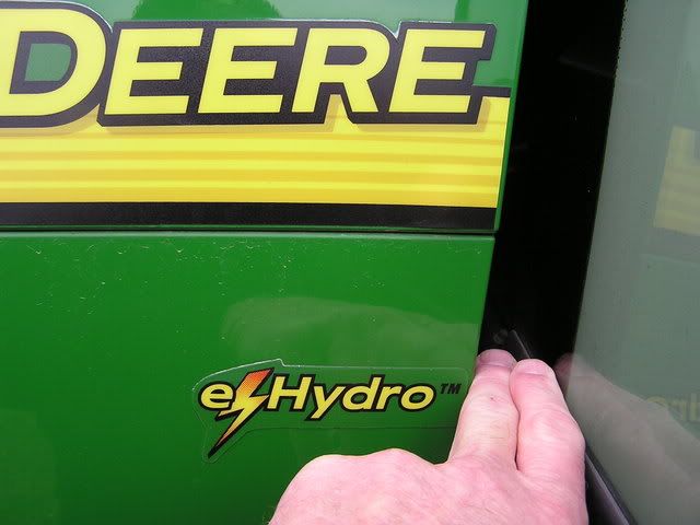

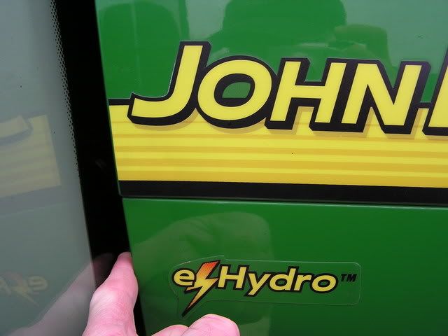

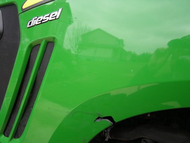

sseeslhoff, our snow doesn't stay on long this time of year. We usually get our big snows in February,but they melt off pretty quickly. That particular morning it was rain at 5am. Then the temps dropped and the rain froze on the road. By 7am it had snowed about 1/2 an inch on top of the ice covered road,giving some late morning risers the false sense that there was only 1/2 an inch of snow on the road and nothing to worry about.
NewToy, if it were only the 3pt draft arm,the side hood panel and the front blade frame it would be an easy fix. The tractor frame is what is the big unknow in repair cost. I can throw on a new 3pt draft arm and the hood panel in no time. I'm not worried
The other questions are what is causing the hood to have an uneven gap back at the cab glass, why is the radiatior fan hitting the left side fan shroud. Where is the problem? I don't have those answers yet.
I have not determined if the hood gap at the cab is off because the radiator and hood latch being shoved to the right or because something is messed up at the hood hinge.
Heres a few pics.
Left side hood panel.$260.00. I can change this out in 1/2 or 45 minutes.
Rear of hood where it meets the cab glass on the left side. Two tight fingers on this side.
Rear of hood where it meets the cab glass. One tight finger on this side.
