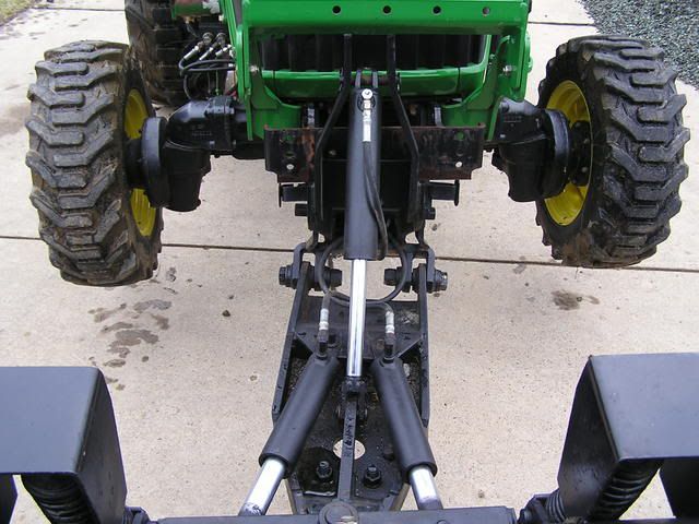

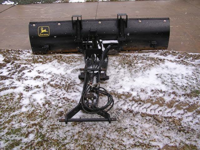

LBrown, thanks for the observation on the back wheels. I missed that and so did the adjuster. I will have to check that out more extensively. That is a possibility that the wheels are bent at the axle. I'll take some measurements and try to determine what is going on. Maybe its just the camera angle. The adjuster just left and he had a pretty good eye for bent and straight. The adjuster found a couple of things I had missed. We removed the front blade and found that both the front blade mounting brackes were bent. He also found that the right draw bar had a twist to it.

I noticed what Lbrown was talking about after he mentioned it. It does look like the tires are sitting at a weird angle. I am going to mention something from another post. You might want to check state law in your state and see if they have to replace anything that is bent with John Deere green parts or if they can use after market parts to fix it. From what I am seeing I am starting to think your tractor is probably going to be totaled also. The parts might not be that much but labor adds up in a hurry. To replace the clutch on my little 15 horse kubota B6100 that I use as a riding lawn mower was going to be 600.00 my friend and I changed it in about 4 hours the parts were a bit less than 100.00

After LBROWN pointed out how the rear wheels looked in the pic I took I did some checking. I jacked up the rear of the tractor and supported it on jack stands as level as I could. Then I started it up and brought it up to almost max speed in high range. Turned on the cruise control and exited the tractor. I then took a 2 foot level and held it on the inside of the wheel. There was a slight wobble on both the left and right wheels. It was only between a 1/16th & an 1/8th inch. I think you would find that amount of wobble on any tractor. The only other thing I could check, would be to remove the wheels and tires and see if the axles run true and also check were the wheels mount to the hubs to see if something is wrong there.
The insurance adjuster is going to replace all four blade mounts as they are all bent or twisted. I think I listed the rest of the damage in an earlier post. He also suggested I take it to Deere and let them go over the machine to see what they also might find that we missed. Plus let the dealership do the repairs. ANYBODY WANT TO BUY A SLIGHLY HIT 3520!
Sincerely, Dirt
Heres a pic of the front blade on the tractor and another one of it off the tractor.

Latest parts list too long to list now. Total as of 02/20/08. $3,037.69 It will be interesting to see what the adjuster comes up with for labor cost.
Most of the parts cost is in the front blade and mounts. It may be cheaper to find a new one on eBay.
